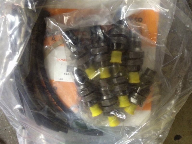

Oh and I got some more goodies today...I thought since they'd been in service for a year I might as well have the injectors checked out. I also had them reset the pop pressure to 2500psi per Buddy's recommendation. I told him my combo and he thought that would work well for me. Diesel Injection Service said they had no problem getting them to pop that high. I can't wait to get this thing together! Oh and of course got a new injector installation kit. image.jpgimage.jpg

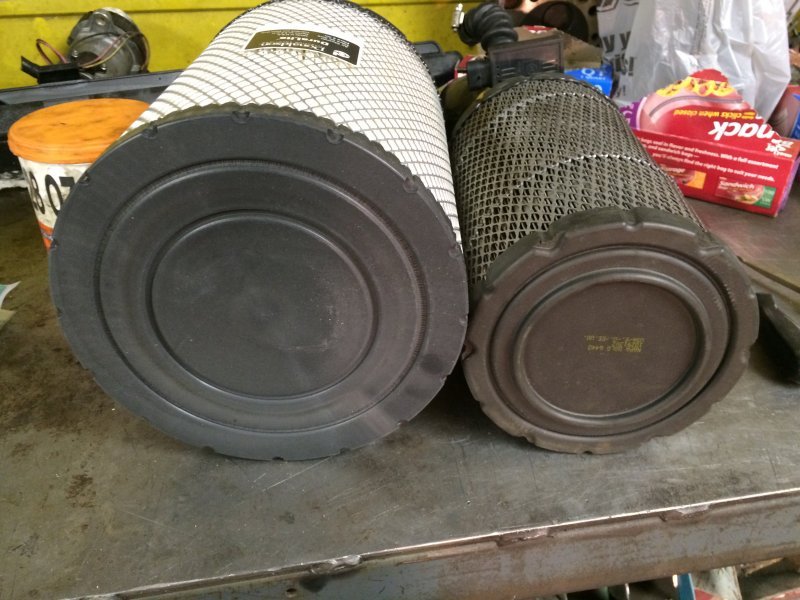

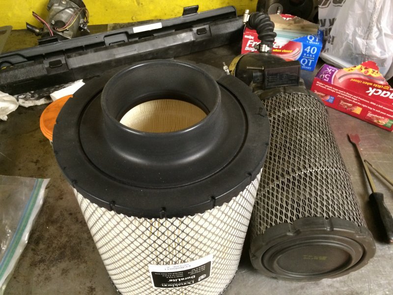

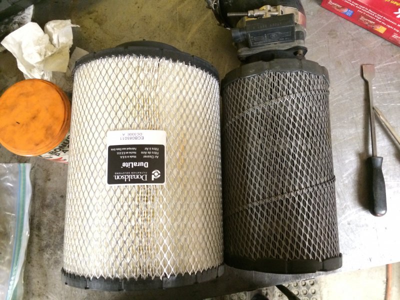

So, what do you fit it in?
I already did a battery relocation when I did the HX40 install so at first it will be in the open but soon I will be making a custom air box behind the passenger side headlight.
Unless you're going with a different turbocharger, there's not a lot to gain in going center mount. The OEM BW unit isnt the best starting place.
Pretty sure the van/Hummer intake manifold also has different bolt angles than the truck heads. Would at least have to redrill or build a shim to get proper bolt clamping without side loading the bolt head. Don't quote me on that though, the gray matter is getting a little dodgey these days.
Yes, bolt angles are different so you need to redrill the stock 6.5 intake or use the van stuff and make it custom, that's what I am doing.
That airfilter while big is a restriction on a 4 stroke 6.5td for anything over highway cruising IMHO you need more cfm flow capacity. SEE: https://dynamic.donaldson.com/WebStore/search/item_detail.html?item=14043
Yeah I found that info too while searching for a filter. I wasn't too concerned because I didn't really understand what they were showing with the 3 different ratings and I found this filter because it's what Powerstroke and Cummins guys are running. I'll do some with and without filter testing to see if I can feel a difference and I may even plumb a vacuum gauge in the intake between the filter and turbo to see if I'm drawing a huge vacuum due to filter restriction.

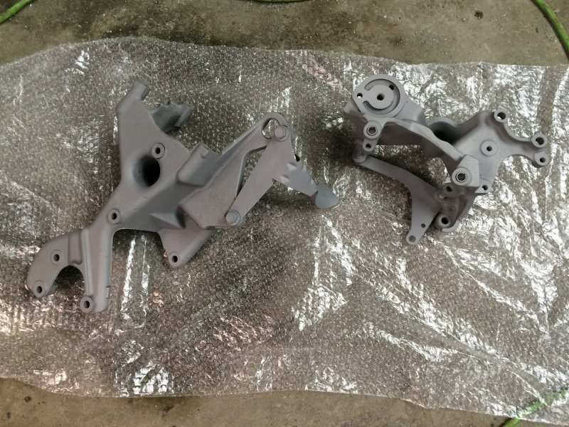

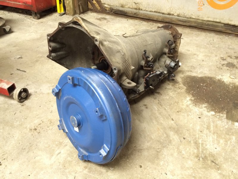

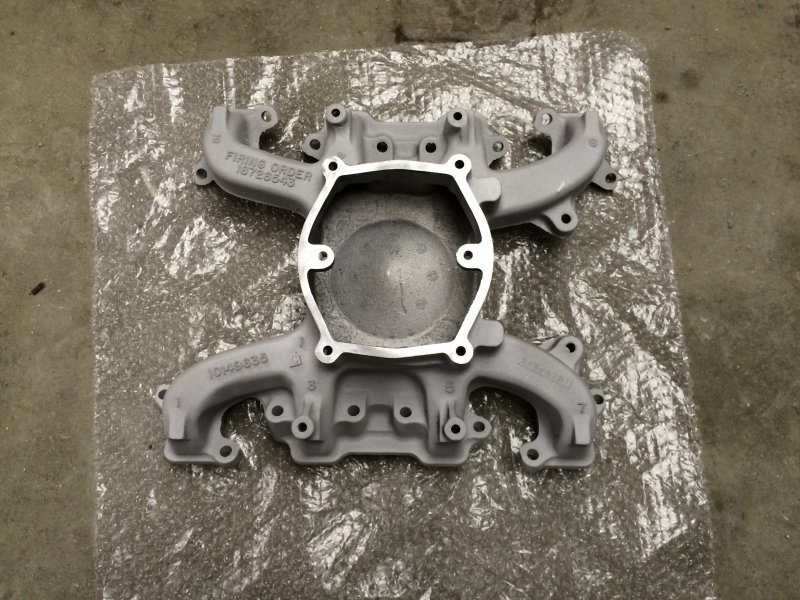

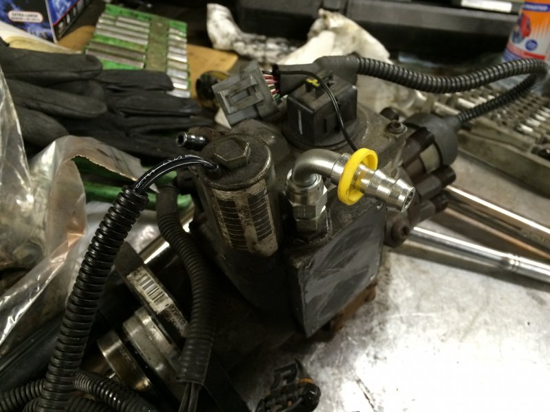

Today's goodies: I got the trans back with the triple disc, billet converter and I had the accessory brackets and lower intake sandblasted.

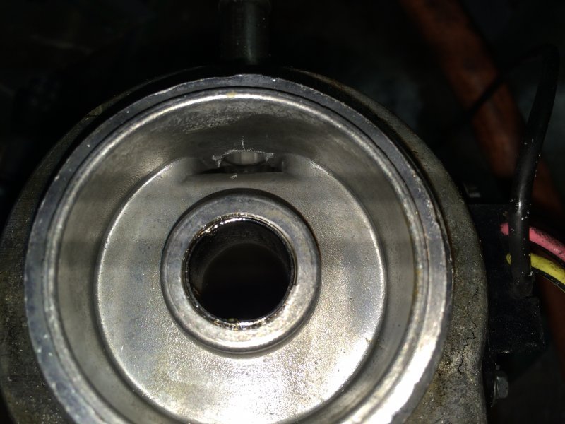

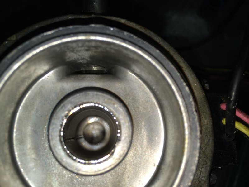

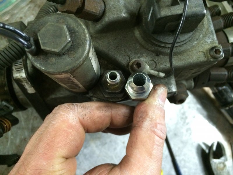

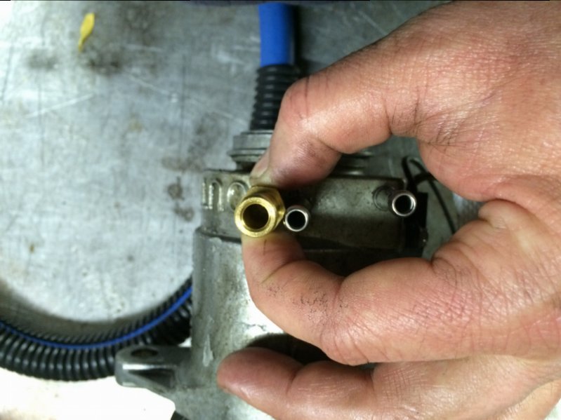

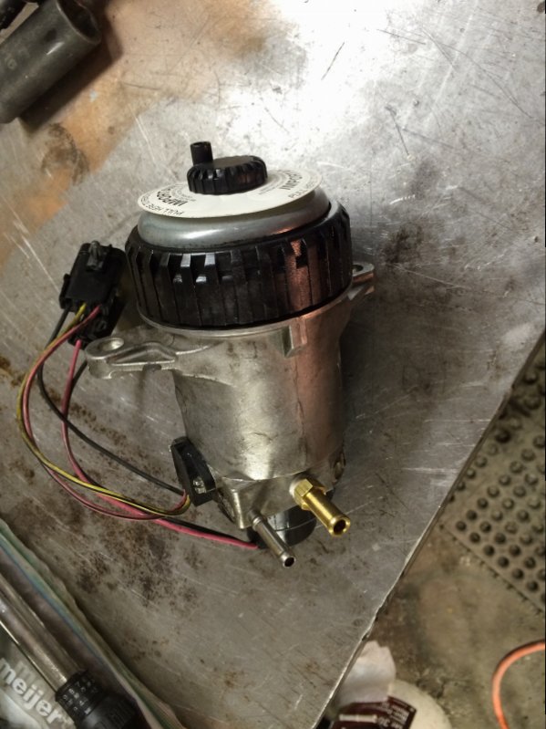

For progress I did the Feed The Beast. I slightly ported the fuel inlet of the FFM because that looked restrictive too (hard to see in the pics). I put a new filter and o-rings from Leroy while I was at it too.
I think my schedule will be looking better next week and I should be hitting it hard again. image.jpgimage.jpgimage.jpgimage.jpgimage.jpgimage.jpgimage.jpgimage.jpgimage.jpg
