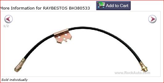

When you do the flexstop hoses do you crimp the brake line holder to the new hose? I added a bit of clear hose on top and its fairly tight but not like original.
