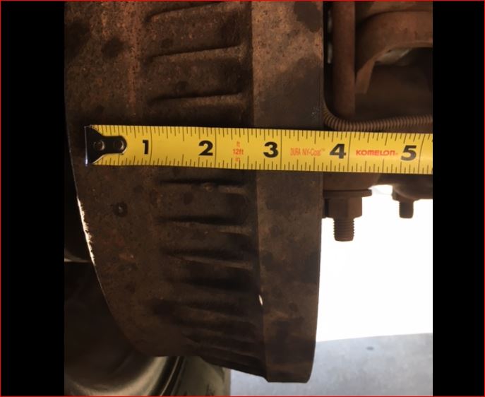

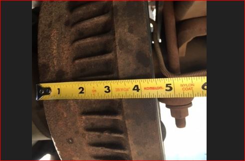

Thinking of rear brakes. Here are pics of my current drums. Looks like they are 2-1/2" shoes? Since they are original and will need turning probably going to buy K3500 drums to be sure they can accept the wider shoes. Maybe mute point but thought I would post pics and see what ya'll say.drum1.JPG drum2.JPG drum1.JPG

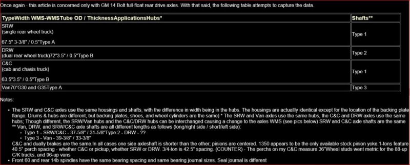

I read an article on pirate 4x4 that said the GM 14 FF hubs and axles are interchangeable with some differences in perches, shock mounts, and tube variations of the housing but again pretty interchangeable.
I'm guessing you have the drums behind the hubs? If so you can get the hubs and drums from a 2500 suburban, and get the wider drums. Suburbans and 3500 trucks got the drums that slide on over the hub instead of behind the hub like 2500 trucks got. The wheel width is the same for both as the difference in how the drums go on evens things out once together.

Yes, I have the hubs that are pressed on with lugs from inboard of hub. Slide on drums would be nice. I thought the inside to inside width of the tire rim to tire rim was wider for DRW (or Type B hub). I have to run 2" wheel spacer so the outside of tires match front to rear.
After looking again I think I mis read / mis understood. The axles and hubs will interchange just need drums and hubs to do wider brakes. But I will still have to keep the wheel spacers to keep same stance (front tire rear tire tracking). The rim flange will be in the same spot just the drums are slip off and not behind the hub. The DRW axle housing is different width backing plate to backing plate and perch widths. The backing plates are in different spot width wise but same part. I was thinking the hubs will space the tire out some but not the case. Now do I have it right?
To regurgitate:
I'll need new hubs and drums can use my axles. Then DRW wheel cylinder and shoes ie 3-1/2" wide need maintenance items: bearings, seals, etc They seem interchangeable14BFFbibleclip.JPG .
Are DRW drums the same as Suburban? Would there be any benefit to getting DRW hubs and drums (thicker maybe) or just get the Suburban drums and get DRW wheel cylinder
Billa Vista 14 bolt bible is where I have read some of this.
http://www.pirate4x4.com/tech/billavista/14b_bible/index.html
