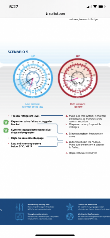

So if the first picture it was 65 outside, 25 low and 170 high...
The low is barely in the range but on low part of it, and high is too high.
So restricted valve would be my guess.
How far down did you vacuum it and for how long? Did you replace the dryer?

So 30/120. So high side is still lower than it should be if it was 65 outside. The spread between low and high still isn’t where it should be. If it is blowing cold enough and removing enough humidity that you are happy with it, leave it. It isn’t hurting anything.
But you definitely can improve 10-15% better than it is.

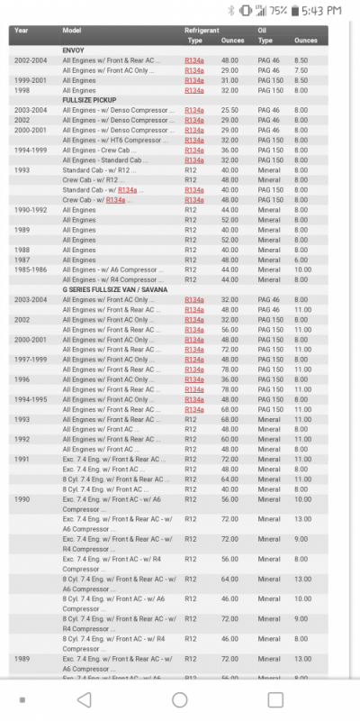

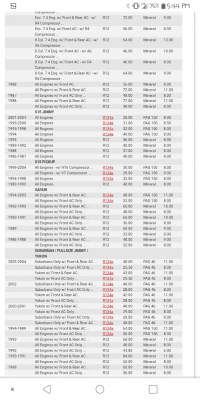

Total 8 oz thru out the whole system and the condenser doesn't het hot and a welding glove will stay on the grille so air flow isnt a issue can say this within 5 mins it gets pretty cold on hi
Yeah, so this is a case of if you want more performance- suck it down, remove valve, flush it, new valve, and redo oil/ r134a and you should hit the numbers. Otherwise run it.
Valve being fixed orifice tube if that’s what you are still running or vov (variable orifice valve).
If tube and it was new- something is restricting it. People changing the tube 2-3 times in a row is when they usually give up or change to the vov.

astockall acdelco compressors ive ever bought come dry i had sure i added 2 oz to it 2 oz to condenser 2 oz to evaporator and 2 oz in my inline injecter give a total 8 oz it did cycle while i was adding freon once it got 36 oz of freon it stopped and at 2000 rpm or 60 mph you can tell the clutch is cycling my first issues was p.o. jumped wires and i didnt realize it so i cut all that crap out and REPLACED WITH NEW EVEN ALL SENSORS!!!
