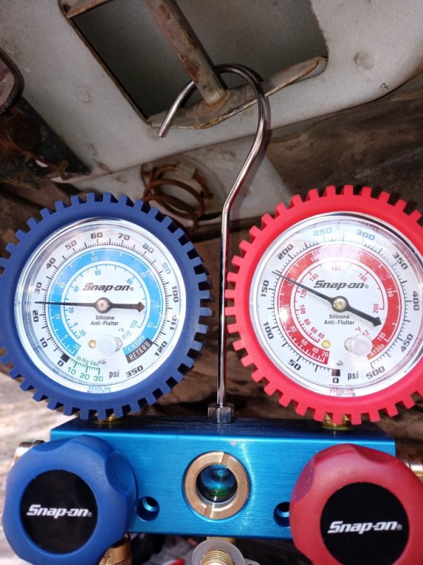

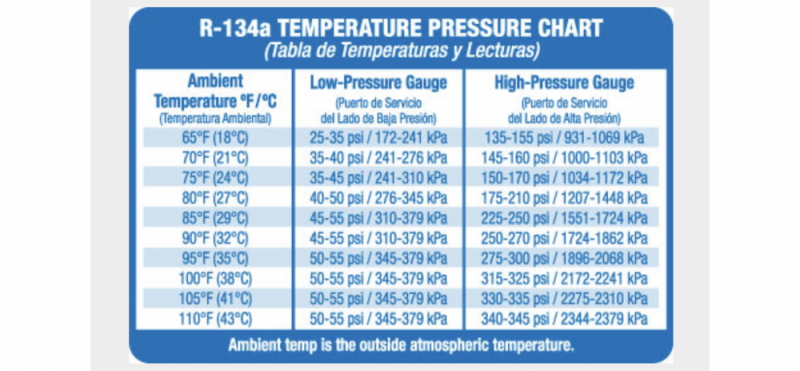

76 here but feels like 85 when i chargedthe system the other night is was pretty cool out 64 65Need to know outside temperature at the time as well.

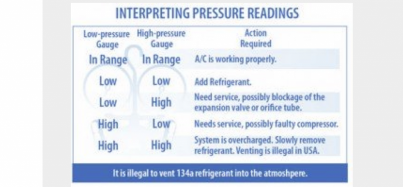

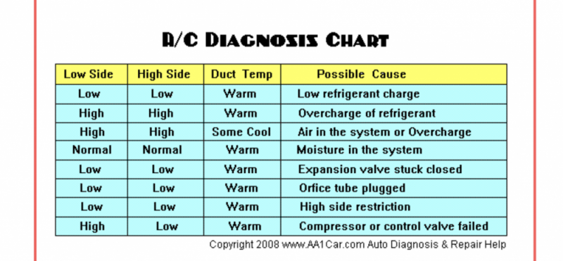

Here is a couple charts to point a target
View attachment 64553View attachment 64554View attachment 64555
