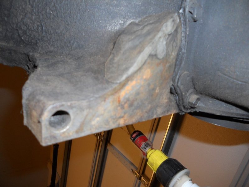

I believe @Hink 's article referenced here shows where the brace goes into the block. Don't start the engine again without it on - No, NOT EVEN ONCE MORE! Yeah, tow it if you have to. The next start can bust the block corner clean off making the block scrap metal. :eek: You know a 10 HP starter that makes more torque than your lug nuts can take...
https://www.thetruckstop.us/forum/threads/detailed-starter-change-article-finished.47116/#post-554321
Yeah, SCRAP METAL!!! Bond-o hid this defect, but, it was a $200 buy just for parts. From the 1992 project of mine, link

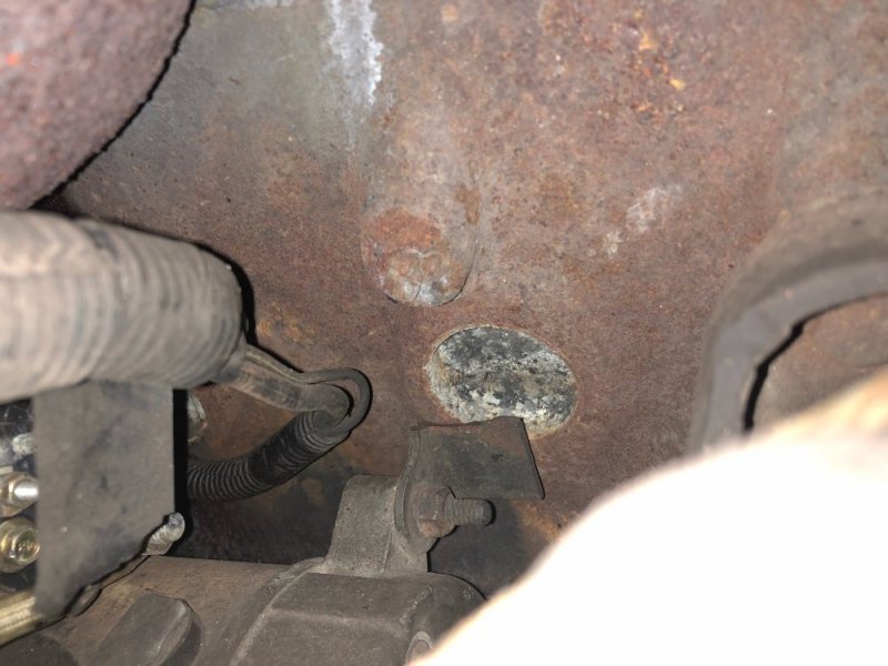

My truck has been starting with no starter brace for a good 150-200k ive got a good block lol but im gonna order that starter brace should the bolt be already there or what?
WarWagon
Well it hits on 7 of 8...
8,941
3,902
You are lucky: Buy a lotto ticket. Next start can break it clean off... GM should have used a 3 bolt starter mount like most of the rest of the diesel world does...
No I doubt the bolt is still there, but, you can look. It's a bolt into the block and the starter needs a stud and nut on it. The Block bolt is the same size as the PS bracket brace bolt on the other side of the engine, both are a PIA to get too. Picture from the link referenced should show this.
boss4457
20
8
ohio
So here is what the rest of my bracket looks like. Its looks like someone tried to weld it at one point in time do you guys have any ideas what i can do? Im thinking about welding a bolt on there and taking some angling iron and drilling holes to make a bracket. But first i got to figure out how to secure it to the block.
