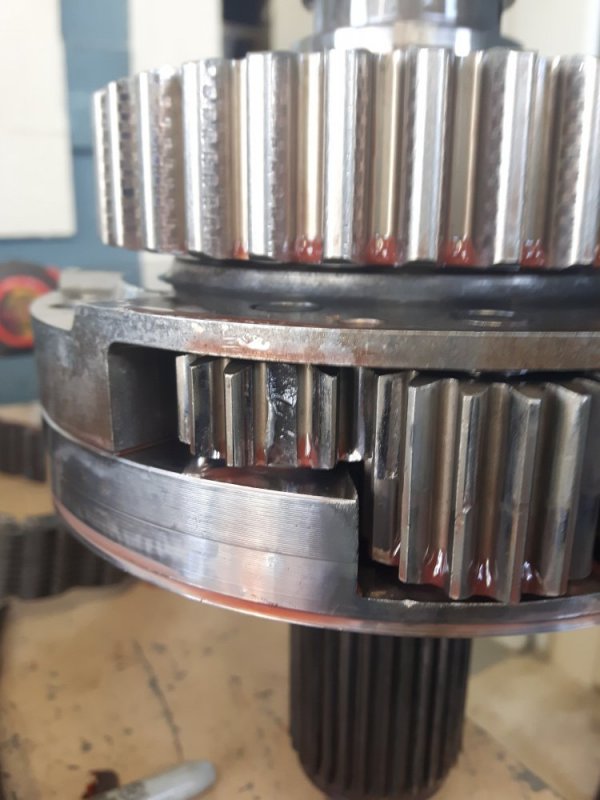

Transfer case was interesting. An entire tooth missing on a differential gear.20180331_130503.jpg

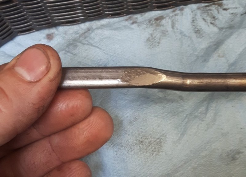

As well the oil pump pickup was cocked funny and the chain had nearly worn through it. 20180331_131837.jpg

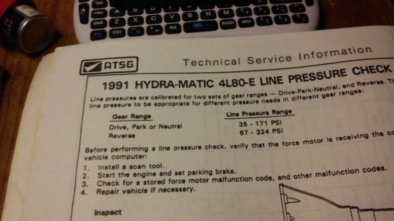

Let me know if these look complete.
It basically works fine until 95-100 deg when it drops to 2nd and the pressue madly flutters.
Let me know if the chart makes sense. Where I specify a range it covers moderate to heavy load(acceleration)
If I need more specific drive perameters at a pressure check let me know.
Ill need an assistant. The warnings with the kit are for real. Watching the pressure while driving and taking notes is deadly....
Limp mode is genius by the way. I knew about it but didn't know you could force it by unplugging the harness. What a great way to save a tow truck home.

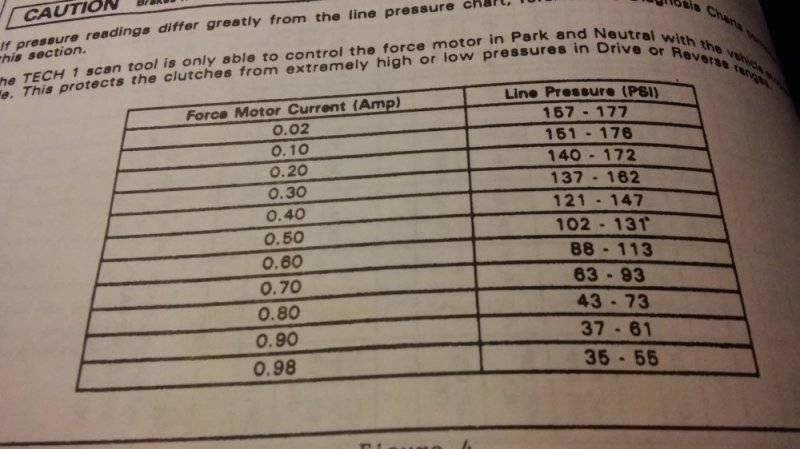

Your pressure in limp mode is good in forward, but a little low in reverse. Max pressure in forward is 171, but max in reverse should go up to 324. Heres the pressure vs current table for a stock 4l80e. You should be seeing 110-150 psi at wide open throttle in every gear forward for holding power. Looks to me like you're losing some pretty serious pressure when not in limp mode.
There is a known issue with the 4l80e and the actuator feed limit valve wearing. When this happens you get low pressure because there isn't enough supply pressure to the valve body controls. But this normally showd up slowly over time, not out of no where.
