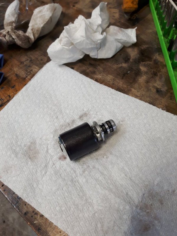

Local transmission place lent me a known good pressure solenoid. Swapped it out. No change. Still downshifts and winds out in lower gears. They lent me a output/input speed sensor too. I swapped my input out first. No change. Then swapped my output out....no change...Boo.

I'd would have done the full solenoid kit change, it's cheap
Possibly shift solenoids, but you have some done now, hopefully it not major.
Lol, this way you've covered most bases, I lost gears, as well (felt like neutral) stop, then it would work again, that kit cured it, now 3 years later all is smooth still,

Nice to hear! Shift solenoids are cheeeap and will be here on the weekend. Thanks.

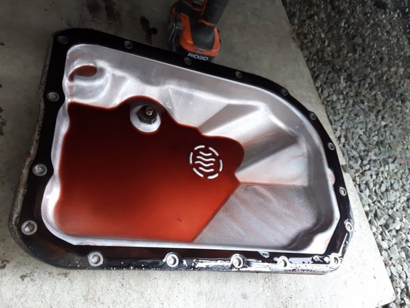

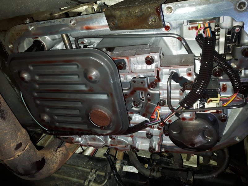

I know....Im sorry!!!! Im the guy I warn people not to be....Im not a tranny pro yet and have no pressure guage. On my list. Its a long weekend and at my level all I can do is try new parts. So far no investment other than beer for solenoid loan. 50 bucks buys new shift solenoid's as its wed before I can have the thing looked at properly. The pan is off and I know its B grade but Ill try it anyway.
