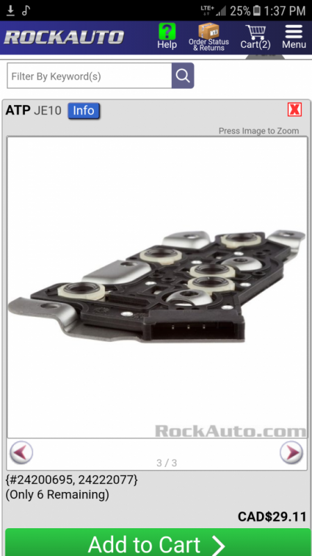

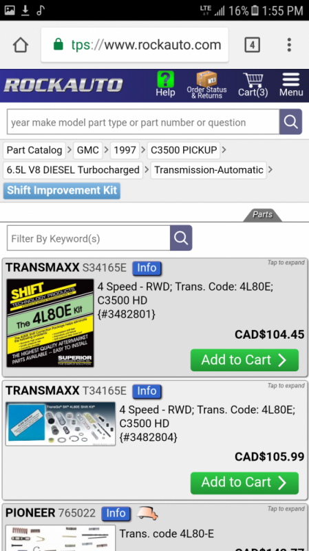

And rockauto has the shift kit too. Get the manifold and the kit to see what happens or just the kit?
THEFERMANATOR
FRANKENBURBAN
Staff member
Lead Moderator
9,204
Likes
2,694
ZEPHYRHILLS FL
Staff #46
The pressure switch manifold is just a set of on off switches, and simply tells the ecm what gear is selected and the actual position of the shift valves. It doesn't measure actual pressure. And most shift kits do not include the pieces to fix the afl. The sonnax kit is roughly $45, but the tool set to install it is $300. I'm not sure how much the transgo kit costs with the reamer, but no kit to repair it is cheap because of the reamer cost.

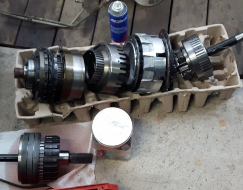

So this carries on...I pulled the trans and took it to pieces. Clean, beautiful, no real signs of wear or abuse. Clutches look great. Steels have no hotspots. Magnet was clean. Pistons are crack free. I threw in a transgo shift improver kit while it was apart and replaced the bushing on the oil pump end as it was the only one with some wear showing. I took the valve body to the trans shop and had them inspect the AFL. They said there was no scoring or wear.
Good news for my transmission. Not as good for my issue. I replaced the internal wire harness as it seemed a reasonable precaution. Some of the wires going into the back of the plug had "wiggle" at the connector and some did not on the old harness. Ill put it back in tomorrow but I dont have high expectations. Im going to check all the external harness from the trans to the TCM today.
Any thoughts while its all easily accessible are appreciated. 20180419_181627.jpg It was my first Auto transmission teardown/assembly. I did have fun
