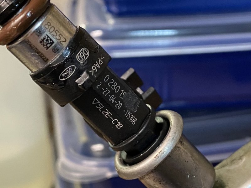

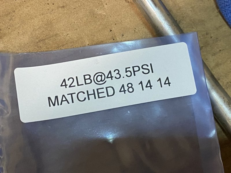

I also noticed in a log that at 80 degrees outside, I was at 96% injector duty cycle......a little bit cooler/denser air and I'm totally tapped out. This won't do. So I contacted Fuel Injector Connection because I saw their name come up a lot in LS forums. They recommended their 42lb/hr (@43.5ps) injectors for me. They'll actually flow closer to 50 lb/hr at my 59psi system, which will support me up to 500 wheel horsepower, if I do enough to get there, yet still have perfect idle manners. And they have a lifetime warranty. Cool. So I installed the injectors and updated the tune with the data they provided to make them behave correctly. It's running a bit rich now, but that should be expected. This has forced me to move on to the next stage of the game - REAL tuning. I am now in the process of installing a wide-band O2 sensor so I can actually optimize my tune on the road. I'm excited to see the improvements I'll get from doing this. I hope to begin this later this week, once it's installed.

Here are some pics of the injectors I installed.

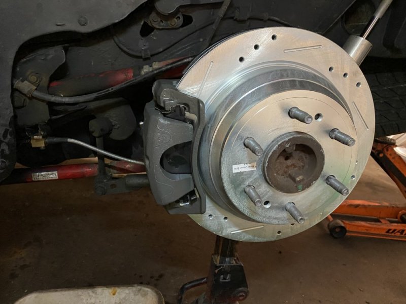

And another nagging thing: the Hawk rear brake pads I installed have always squeaked just driving around. It sounded like the pads were worn and the squealers were on, even though they weren’t. I was done with that. I searched on the TBSS Owners forum to see what others were running and found that a bunch of guys were happy with Brake Motive brakes off eBay, so I figured I’d give them a try. To my surprise, I recieved them the day after I ordered them AND they had Power Stop pads and rotors in the kit! I have them installed now along with some braided rear hoses and they work great PLUS no more squeal. One more nagging item on this truck is gone!!

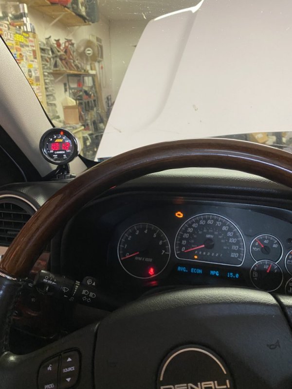

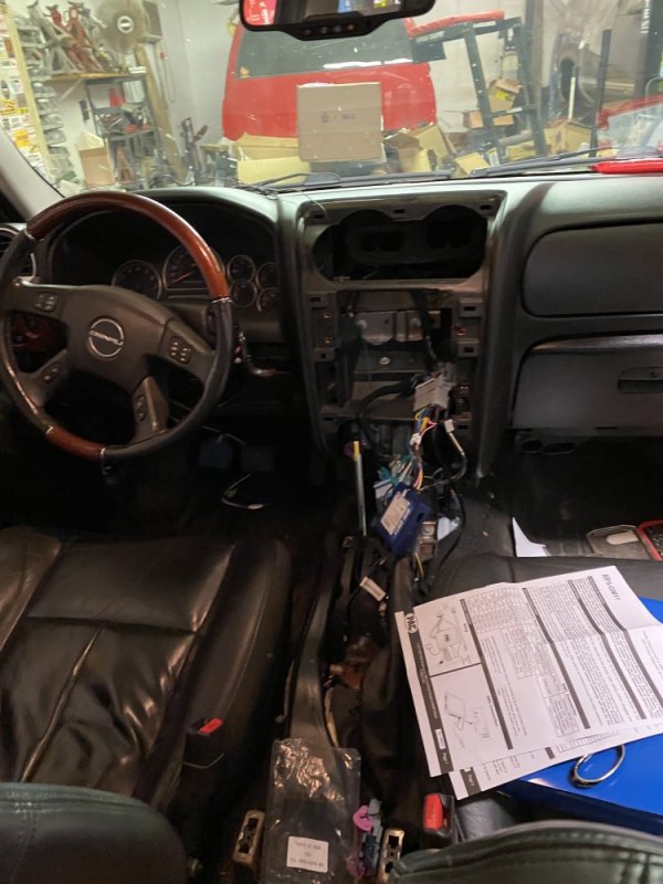

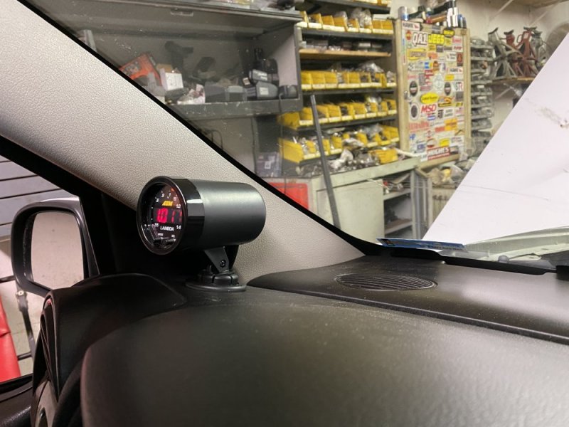

Here’s current state for the O2 sensor install. I want to tuck the wiring in the dash. I’m also going to address one more nagging item while I’m at it: this had an aftermarket radio in it when I bought it. It’s a nice Pioneer touch screen unit, but I’ve had some speaker and steering wheel control issues. I’ve narrowed it down to the aftermarket module that allows the radio to communicate with the other vehicle stuff, so I’m also replacing that while I’m in there.

Your gonna like that new Lambda O2 sensor.

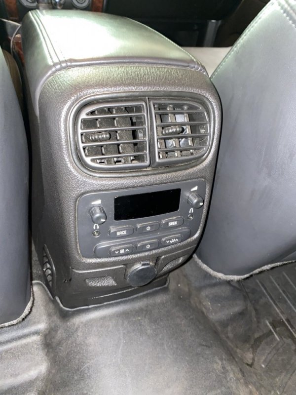

Radio module is installed and now I have consistent function of the volume button on the steering wheel. I also have the majority of the console and center stack pieces cleaned and reinstalled. I just have to install the two panels under the steering column.

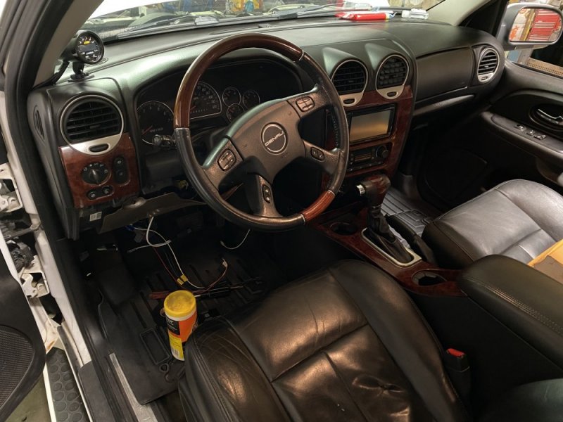

And most importantly the wide band O2 is wired and functioning. Tomorrow I should be tuning.

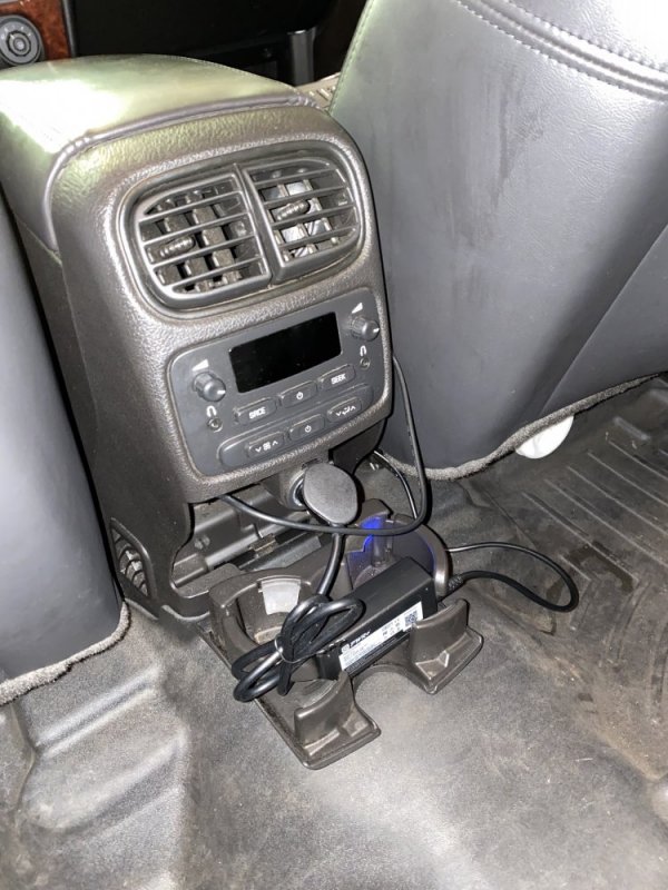

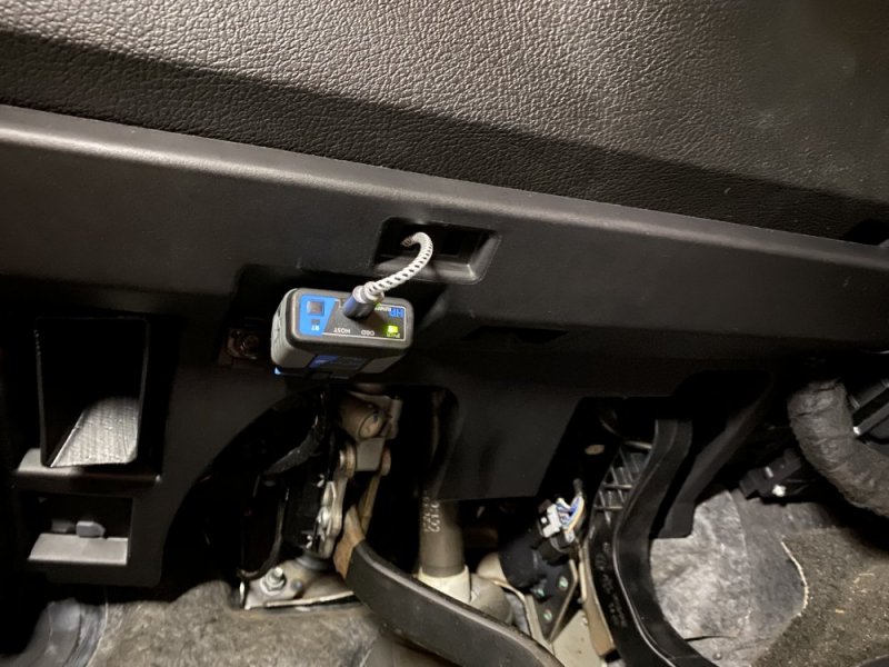

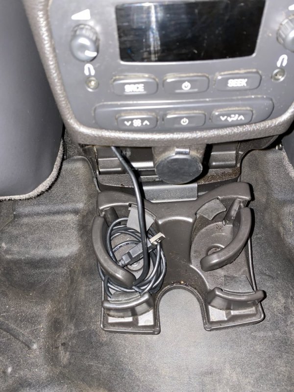

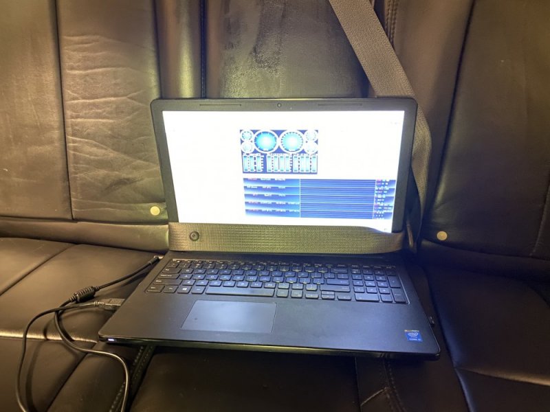

Got it all buttoned up today. I was initially going to have the MPVI module sitting in the glove box with an OBD port extension cable and hardwire the laptop charger into the truck, but decided to not do that. So instead I bundled all of the USB stuff under the panel under the dash and just had the USB-C cable sticking through and plug into the MPVI in the traditional location. Then I have a USB extension cable run through the center console, popping out through the rear cupholder. I can tuck the cable in there when not in use and stash the charger in the pocket in the back of the seat. Then when in use pull the cable out, plug in the charger and go. With this setup I can have the laptop in the front passenger seat or in the back seat if I have a passenger with me while I’m logging. It should work out well.

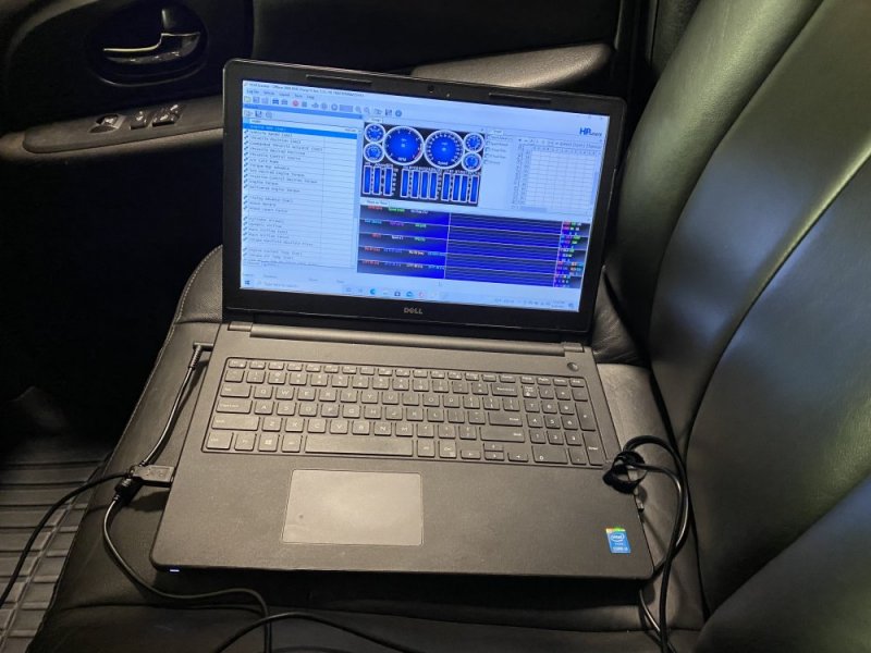

Today I did about a dozen MAF tunes done and got that dialed in pretty well. Then I did 3 speed density tunes. More tuning this week.
I'm still tuning......... I've learned that just my luck, my generation of ECM is more difficult to tune because it has a VIRTUAL Volumetric Efficiency table, so when you make changes to it, it does calculations to coefficients elsewhere in the tune and then to make the math work it will backwards update the VVE table, modifying the changes you just made. It's a lot of iterating to dial in the map. And since I was struggling, I redefined the boundaries of the zones in the table to help with those calculations......which basically started me all over again. I did that after the 24th iteration of the VVE tune. I'm now at the 29th iteration. Luckily it does seem like it's reacting a bit better now after the redefinitions, but man, this is a frustrating process. I really just want to be working on the IP swap on the dually, but I need to get this thing dialed in better before I do that. Good news is that Sunday I did some driving with one of the earlier tune iterations and it looks like my fuel economy has improved, so that's encouraging. Once I finally get the VVE dialed in, then I can start dialing in timing and then good things should start happening then.
Welcome to gen 4 tuning, gen 3's did just what you told them.
