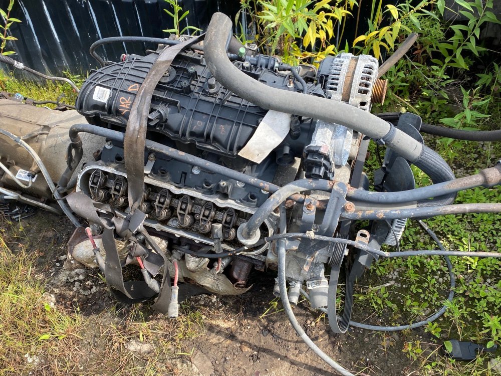

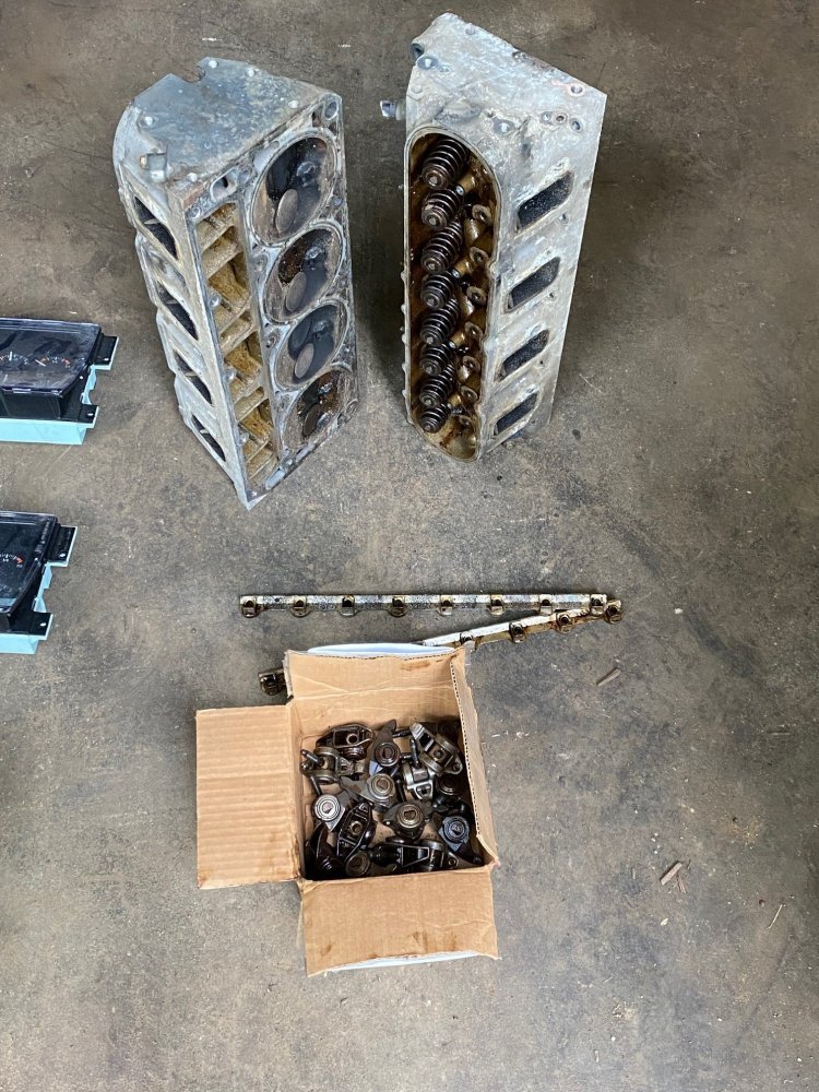

First thing I grabbed for the swap was a set of rectangle port heads. You can get adapter plates to adapt the LSA's rectangle ports to cathedral port heads, but I wanted to change the heads at the same time because it would be an upgrade and it would keep the supercharger lower, helping to avoid possible cowl clearance issues. I also want to add a lid spacer in the future, so this will give me more clearance for that as well. I was lucky enough to stumble on a truck 6.2 that was already pulled and on the ground at the local yard so it was easy to zip the heads off of it. $50 each and they were mine. Score!

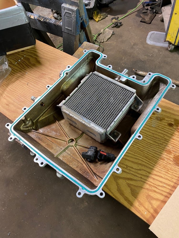

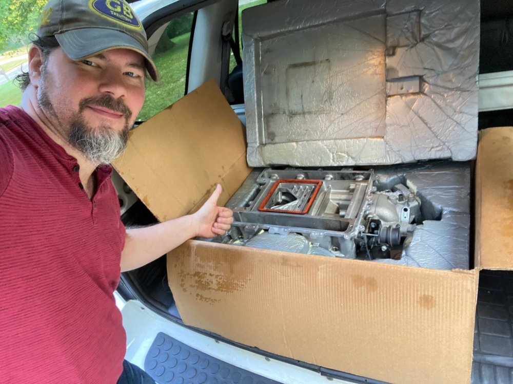

Then a few weeks later, an LSA supercharger popped up on Marketplace in my town for $600! I couldn't believe it! Most have been 3 hours away and $1200-ish. I made plans to meet with the guy first thing the next morning and it was mine. It felt so great to have this in my possession! One of the hard parts to get at a good deal was off the list.

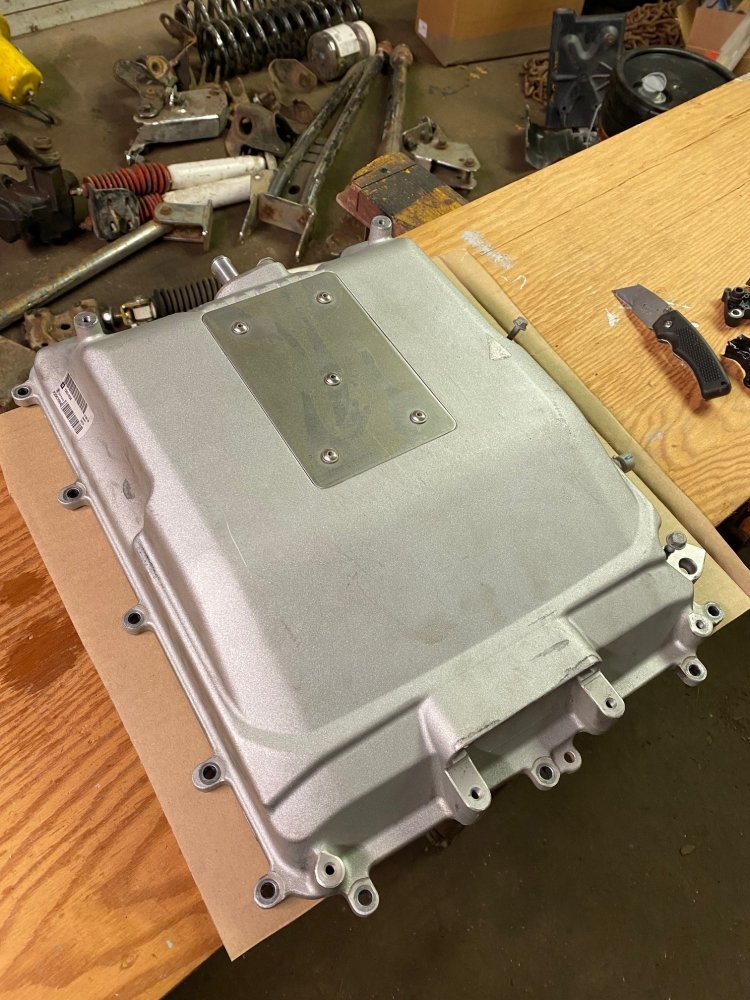

Then a few weeks after that, I found a great deal on a CTS-V lid (which is the one I wanted, not the ZL1 lid) that had the intercooler brick already reinforced. Another part that was hard to find at a good deal in my possession!!

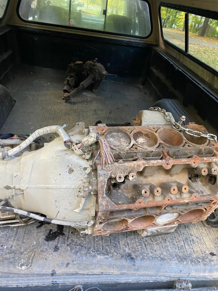

I decided since things were starting to get more serious, that I needed an LS short block for mockup purposes. There wasn't anything cheap on Marketplace so I roamed the jumkyard. I found a 6.0 in a van that someone had removed the heads off of so it was crusty.......it also had a grenaded piston. I got that and the 4L80 that was attached to it for $150. The trans will show up in another thread soon....

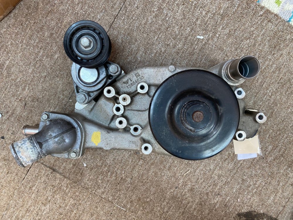

I found a decent deal on a water pump that was removed from a wrecked G8 GT (same belt spacing as a Corvette) with the belt tensioner already installed, so I snagged that up. It's good enough for mockup purposes at the very least and I could probably install it and be ok, but I'll probably play it safe and just buy a new water pump at the time of installation.

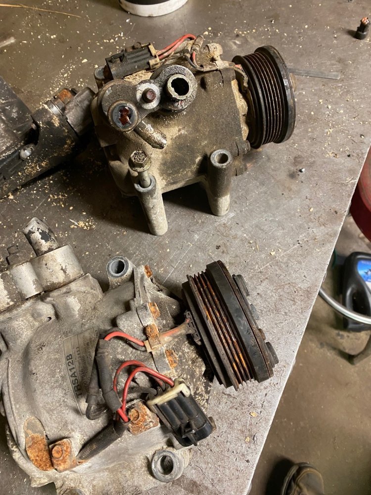

I have 2 AC compressors off of GMT360s, one from a 5.3 (4-rib belt) and one from a 4.2 (6-rib belt). I think swapping the 6-rib pulley to the 5.3 compressor is going to get me pretty close to having this line up with the other accessories, but I won't know until I get things mocked up.

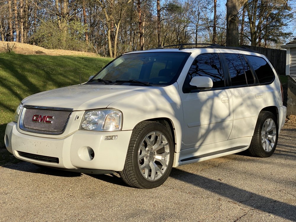

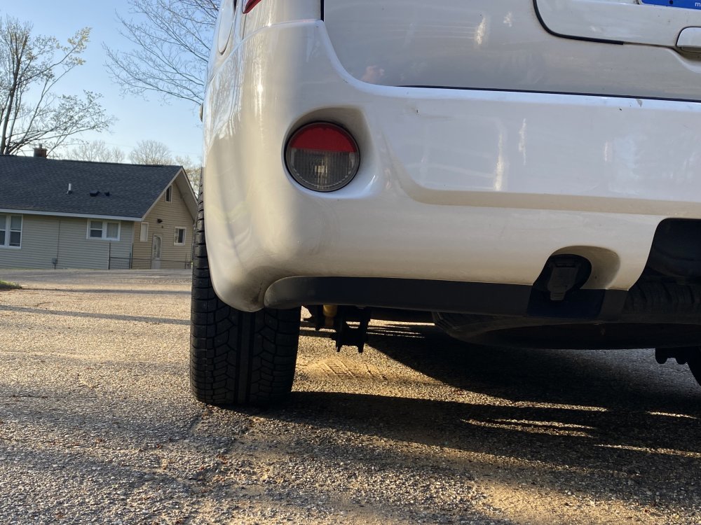

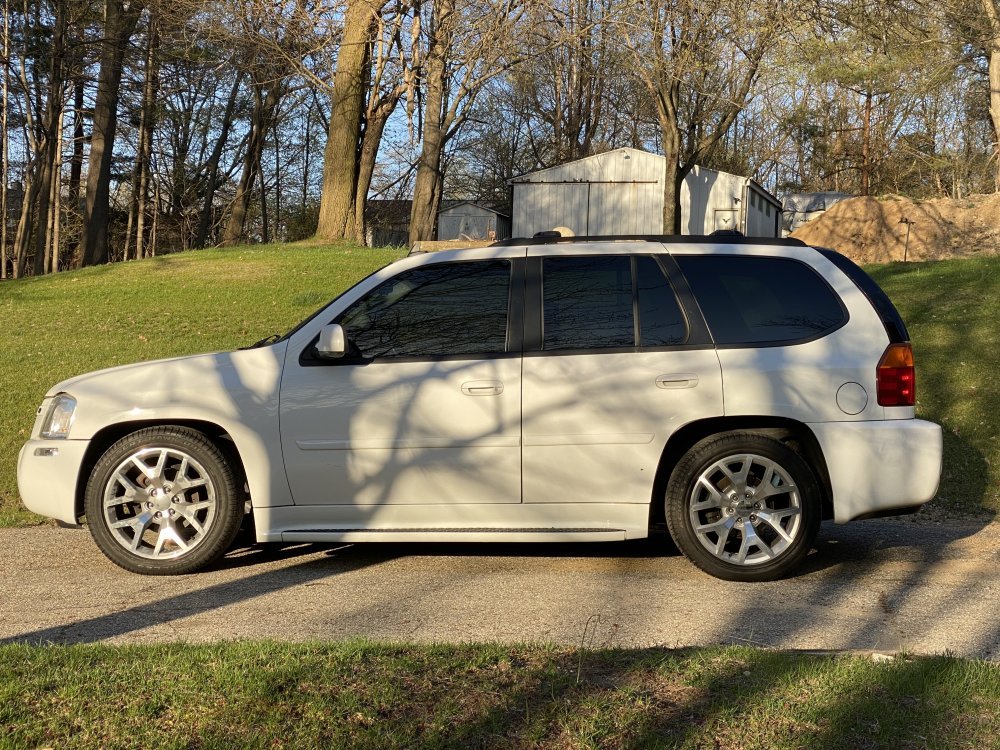

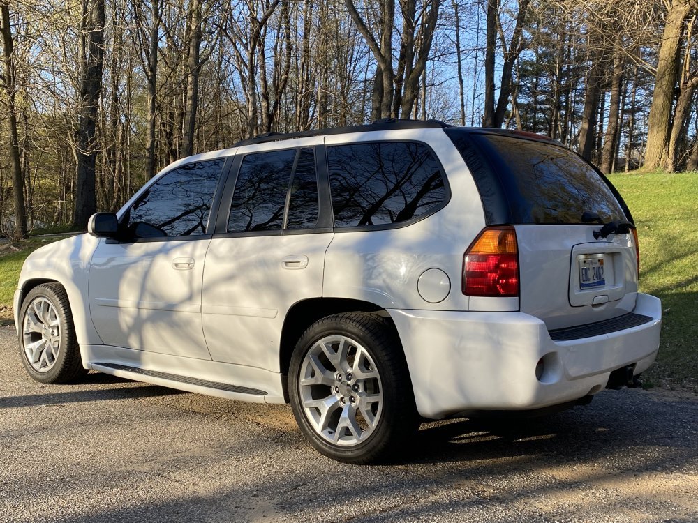

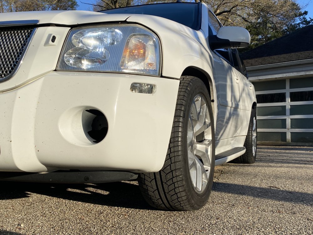

I got some new summer wheels and tires for the Envoy. I’ve been wanting a set of these for about 3 years and I found a set 2 hours away with tires and TPMS sensors already installed for less than half the price of new. These are a copy of GMC “Y-spokes” in a 20” x 9” size, that have the 6” x 5” bolt pattern of the GMT360. The tires are 275/45/20, which is the same OD as the stock 245/60/18, but with more tread width. I need to lower the rear of the truck about an inch to get the overall stance better. In the future I’m planning to get 295/45/20 tires so there will be a little more rubber to fill the wheelwells plus gain some additional tread width. I went for a quick drive after installing them and they ride nice and smooth. I’m happy.
