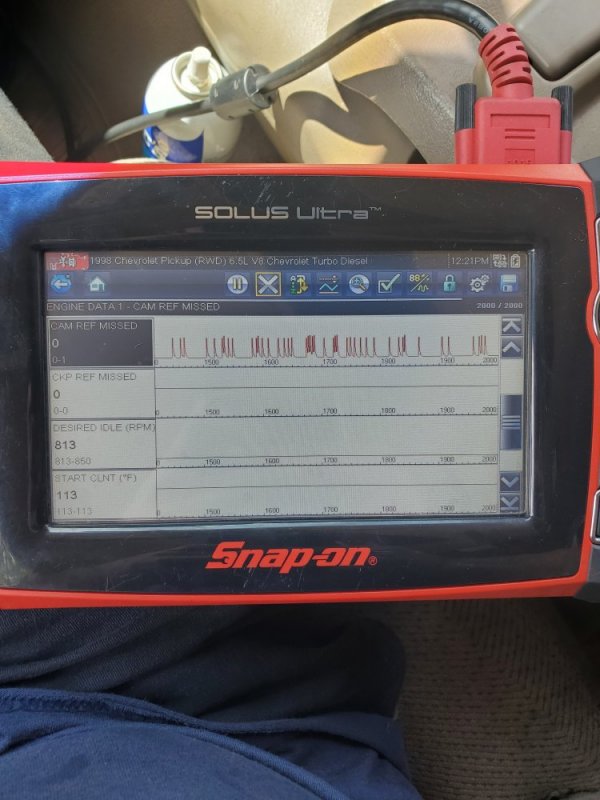

Okay for anyone still following, I replaced the CPS with an AC delco today with no different outcome. Tried with the original computer and nothing. Unplugged the ect sensor and the truck ran for over an hour just fine around 800 rpm. Anything lower it starts running rough and stalls. After it stalls it won't start. Once it gets hot it misses crank reference and cam reference but nothing above 1. Does not start with optical sensor unplugged.
