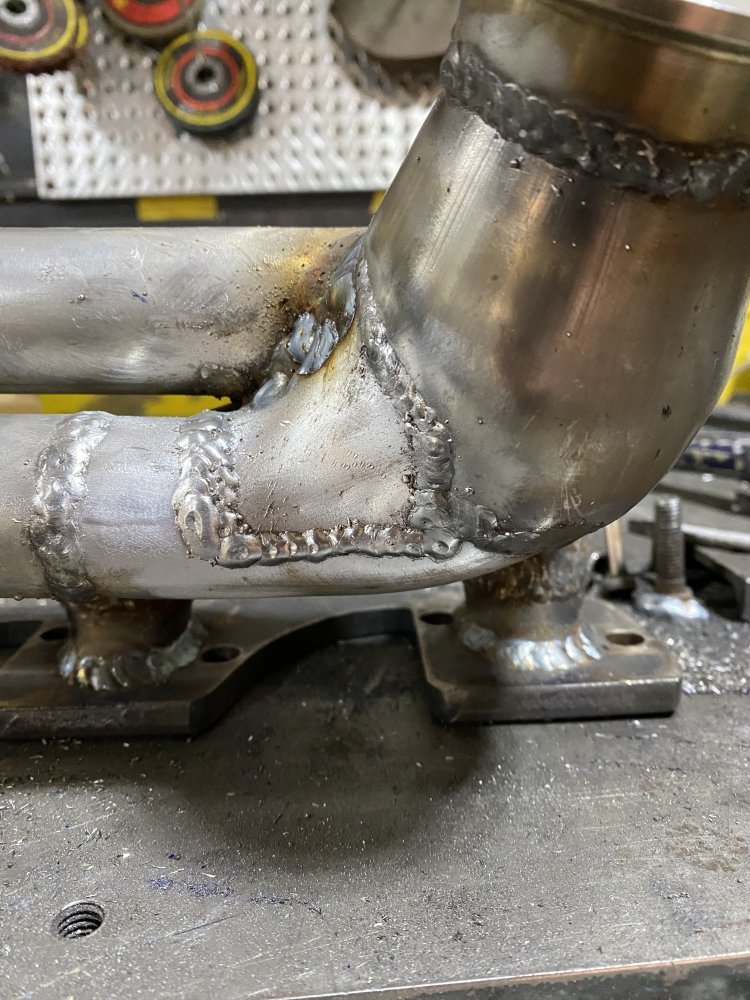

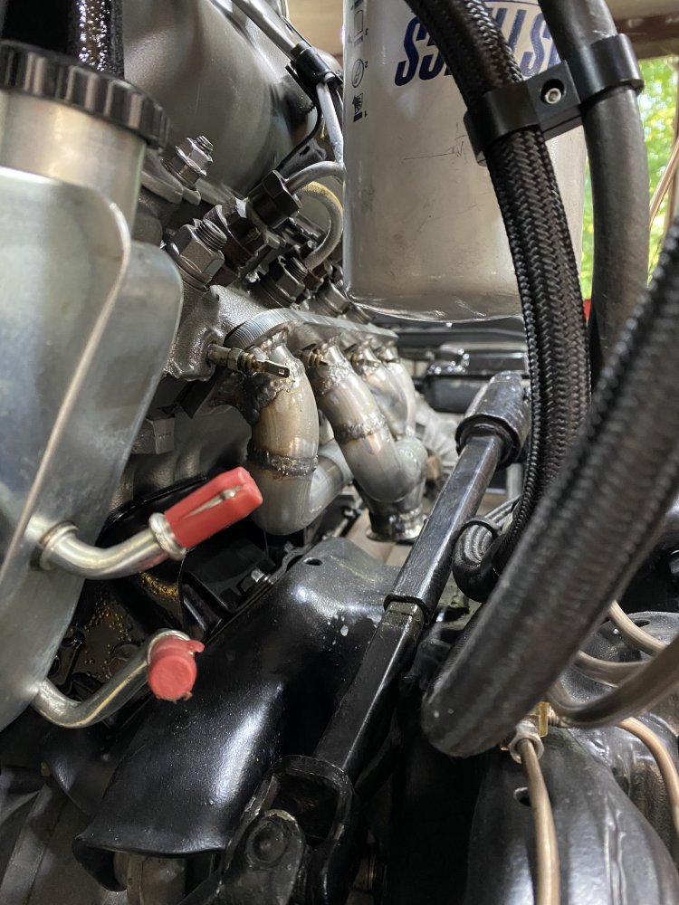

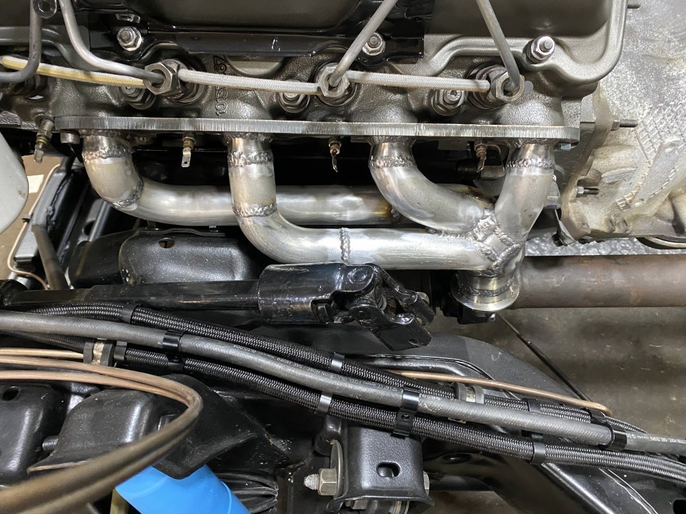

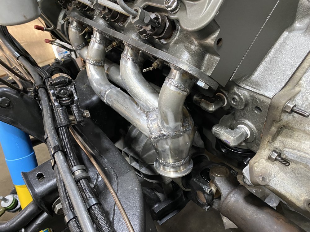

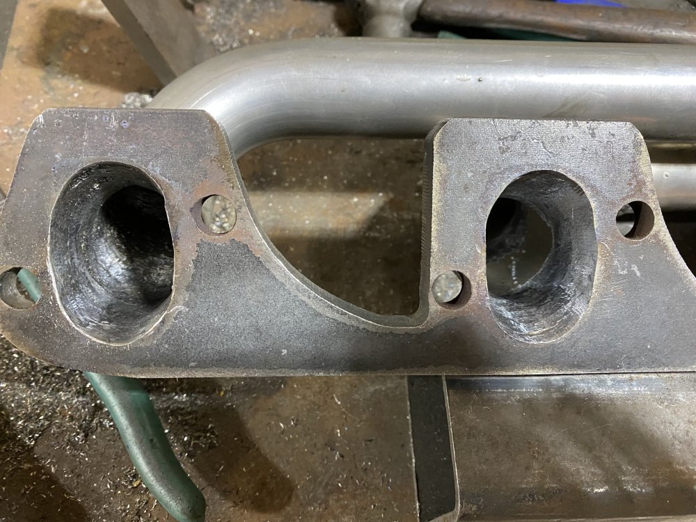

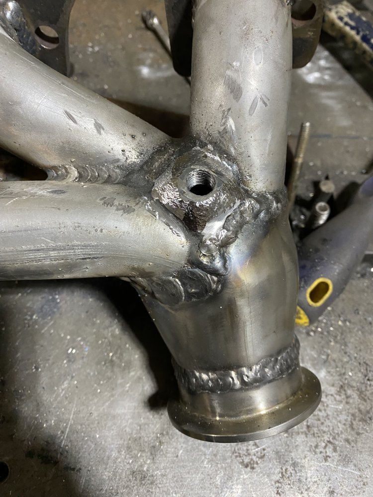

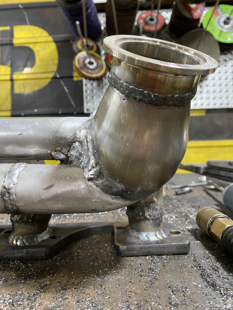

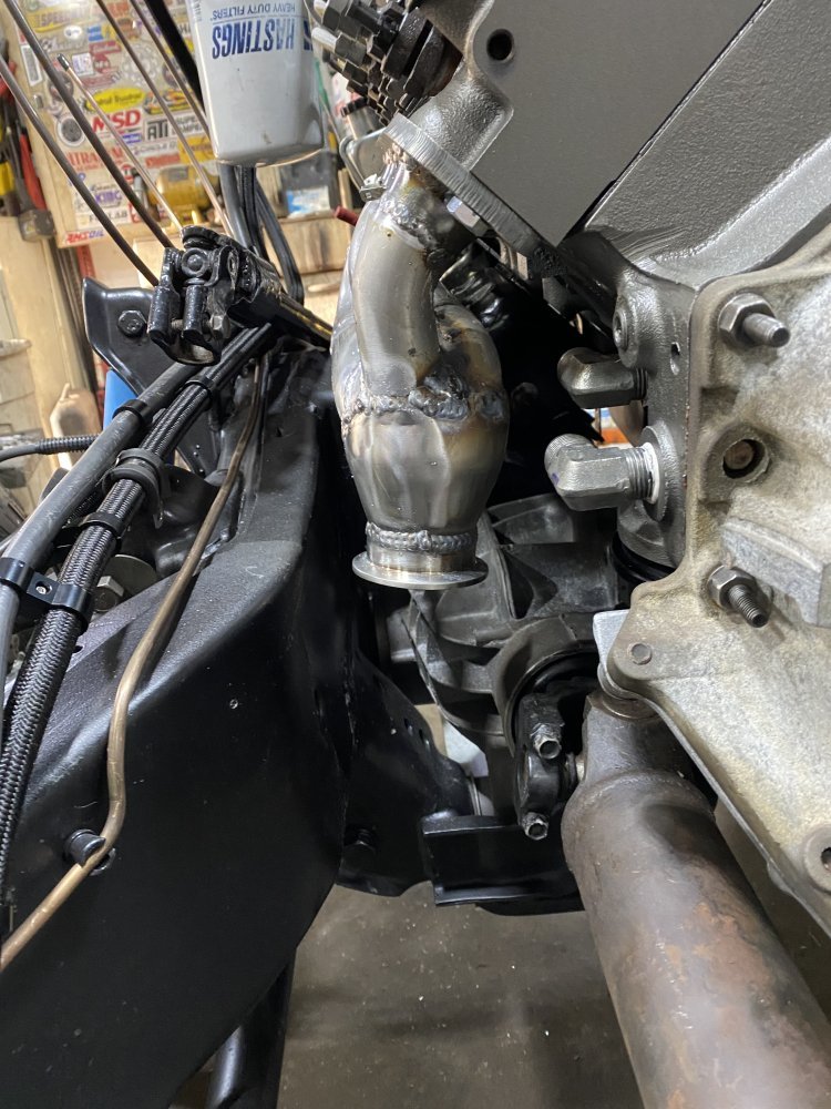

I got the driver side header put together. For some reason it took almost as long as the turbo side, even with 2 less tubes. I think I’ll have less to clean up on the inside of it though.
Next up is the crossover.

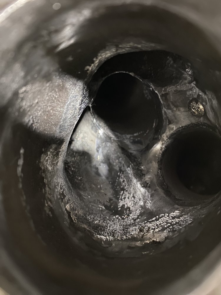

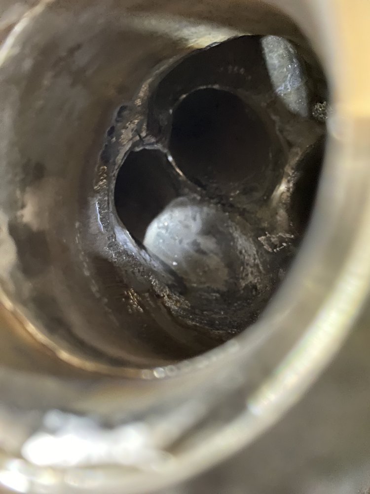

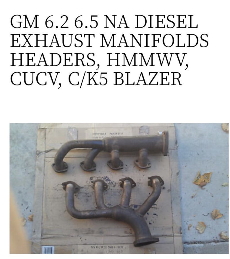

How similar is that to the military version?

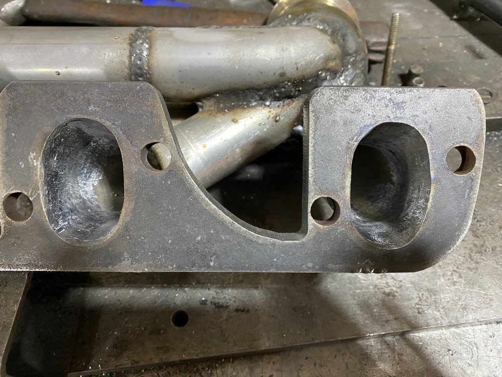

Pretty different. I didn’t like how number 5 cylinder was done on the Hummer headers, plus I wanted v-band flanges and I wanted to control the routing of the crossover, so for those reasons I decided to make my own. Ironically, I also don’t love how I did number 5 on mine, ha.
