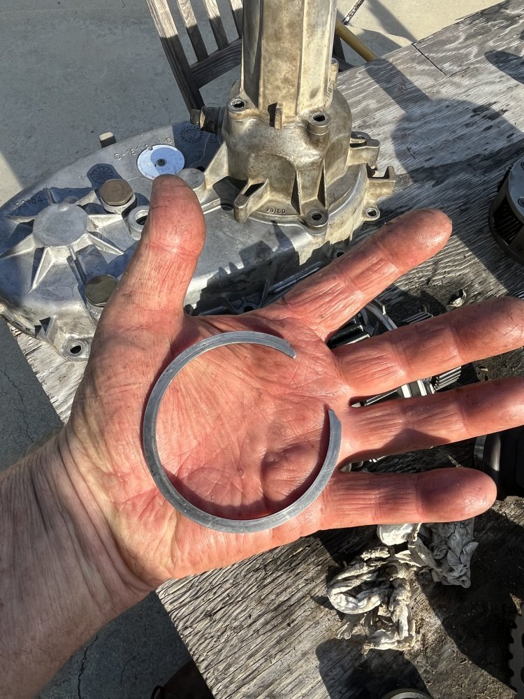

Also I suggest this upgraded snap ring as part of the output shaft assembly, much sturdier than factory and prevents future problems of the slip yoke repeatedly slamming into the single snap ring

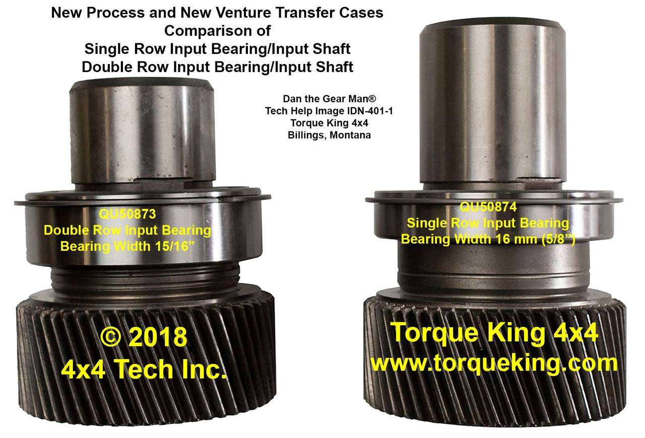

I was in a rush and forgot to get the measurement on the input bearing. My son could get the measurement this weekend. Where is the input bearing located. Is it the one located in the case half which connects to the transmission?

Input shaft bearing seen at 8:52, yes it's right there in the case half that mates to the transmission. You want to measure the thickness of the bearing; the diameter is the same, it's the "height" of the bearing that needs to match the input shaft. Here's a side by side picture of the two different bearings on corresponding shafts

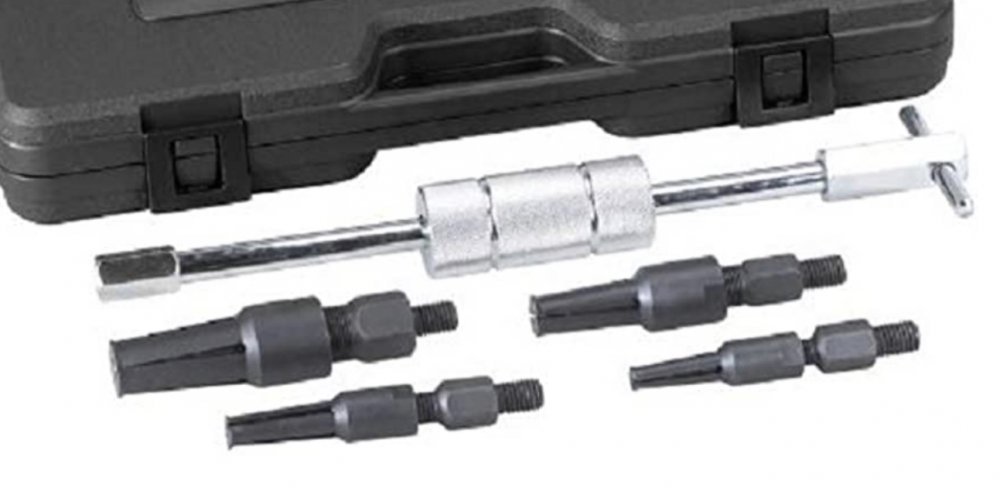

Blind bearing puller??
I've used Optimum Black pretty much exclusively with no issues. Re- sealed my t- case several times with it, sealed my rear diff, sealed the PTO covers on the NV4500. I've seen others talk about using RTV silicone in re- sealing this case, so either is probably fine. Optimum black advertises itself as having maximum oil resistance, which is why I used it for the aforementioned applications.
@Big T a blind bearing puller is for bearings that are driven in one way and can't be pressed out from the opposite direction. Like a pilot bearing in the end of the crankshaft for the manual transmssion input shaft. The puller goes into the center of the bearing and then has little feet/ tabs that spread out and grab behind the bearing, allowing you to pull it out. There's at least one blind hole bearing in one of the case halves.

See how the attachment goes through the bearing and the lips grab the inside of the bearing? But notice in the bread video his cheap one broke? So don’t waste time on a cheap one- they always fail. Don’t think lifetime warranty is ok, because you will just brake the same thing 10’times and not get out the bearing or race.

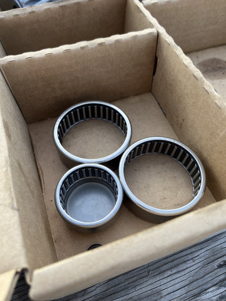

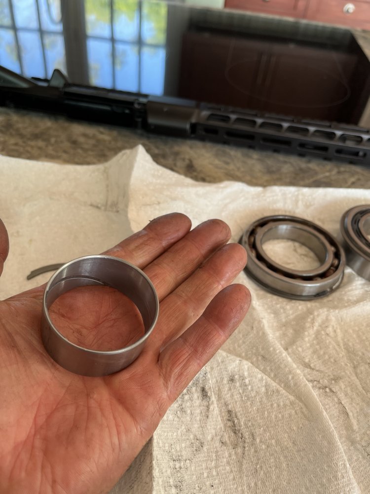

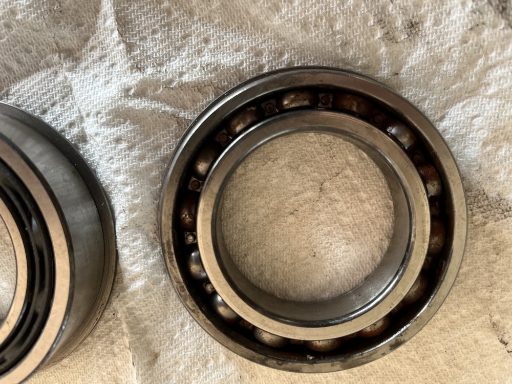

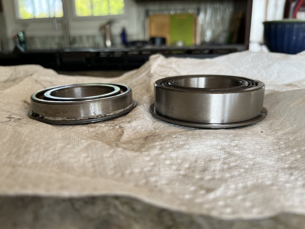

Started in on the transfer case rebuild. It was mostly taking apart the rest and cleaning things up, then removing bearings and pressing the new ones in.
I got the wrong kit with the taller bearing:
The old bearing rusted from the water intrusion, so it was good that I’m replacing. Will need to order the correct bearing.

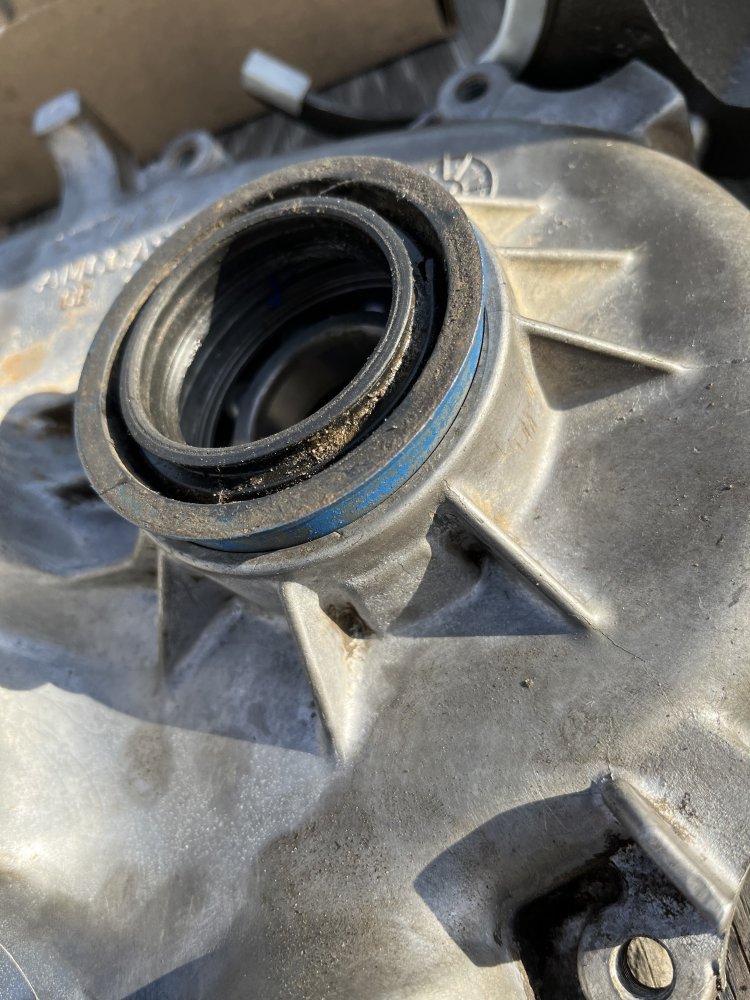

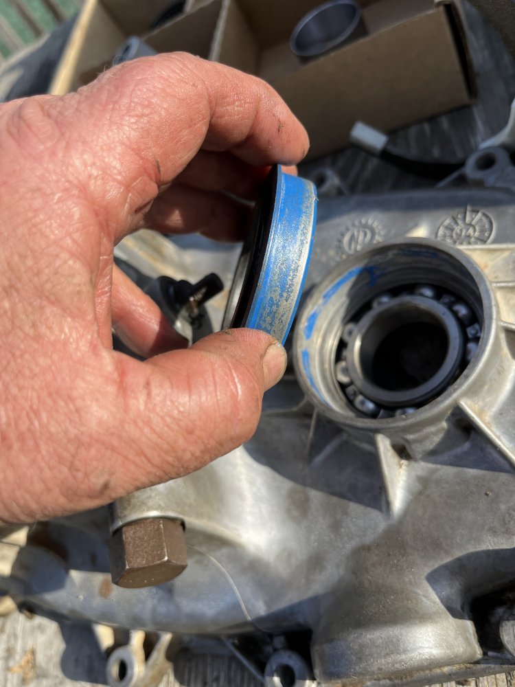

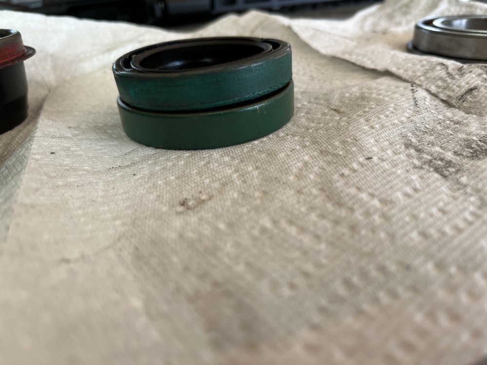

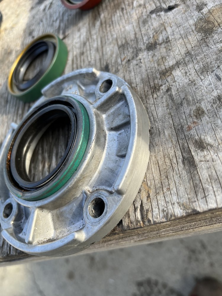

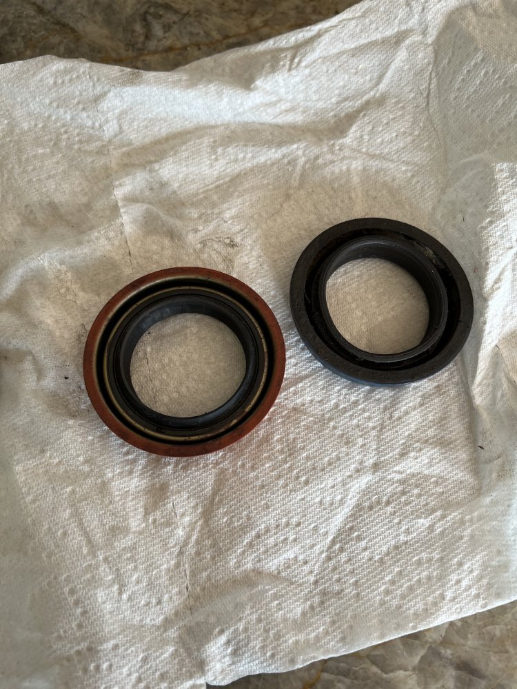

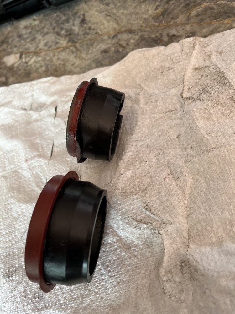

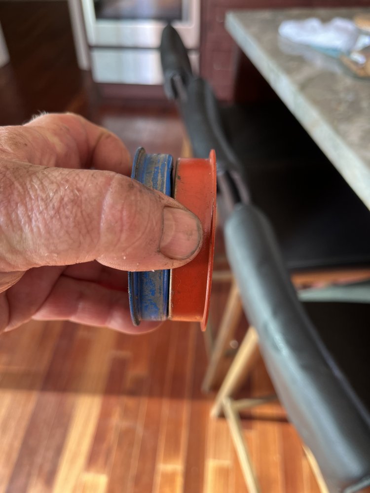

All the the external seals are the wrong size. These are the seals on the rear drive shaft output:

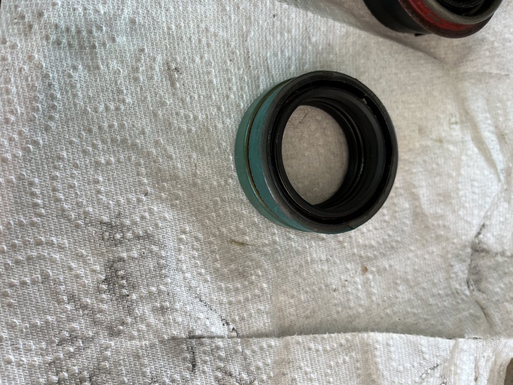

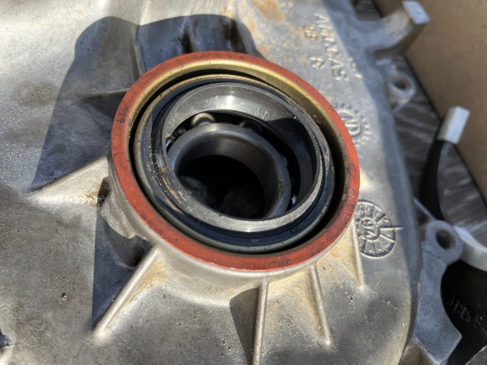

This is the seal for the front drive shaft output:

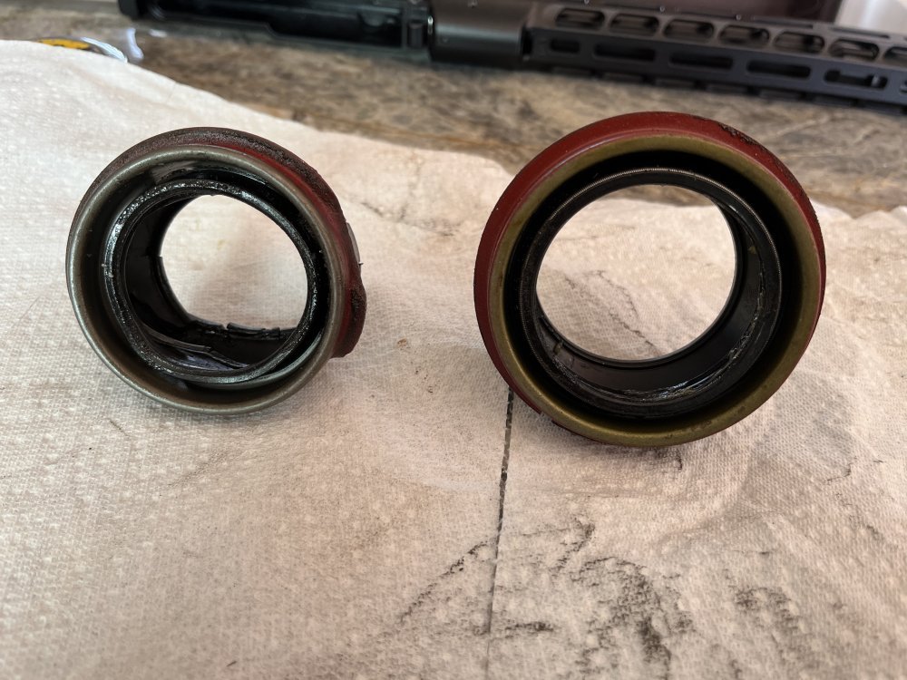

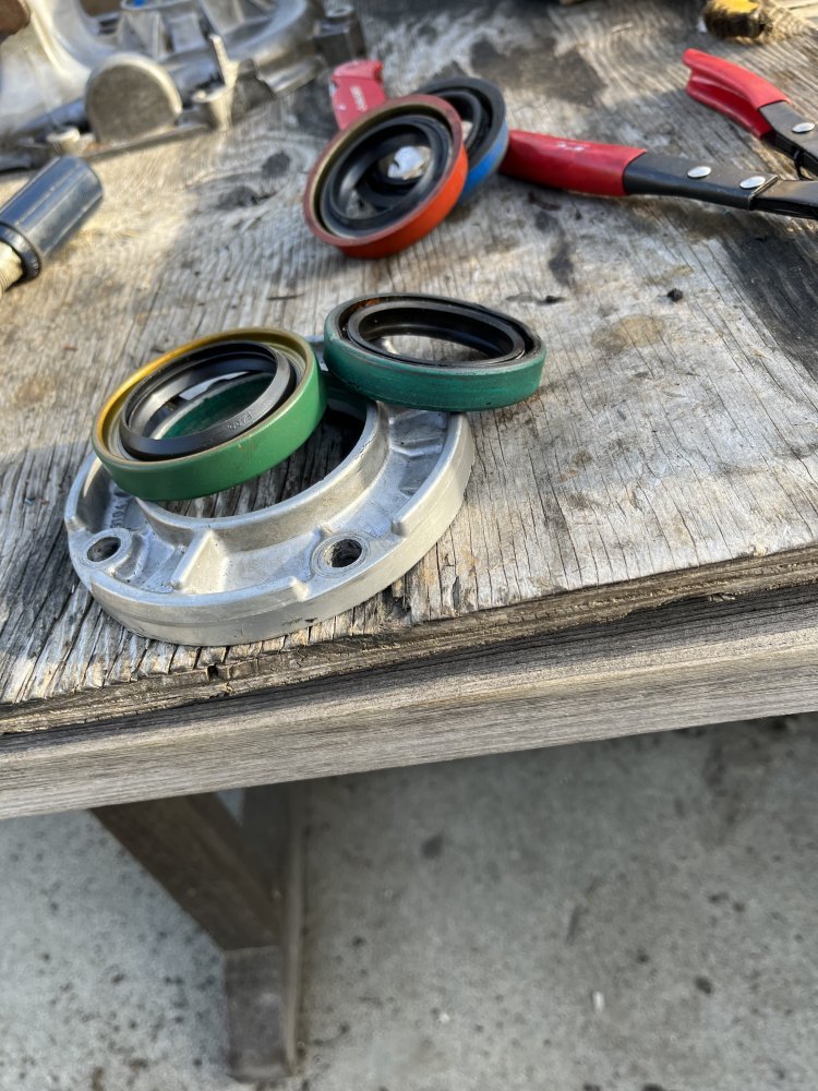

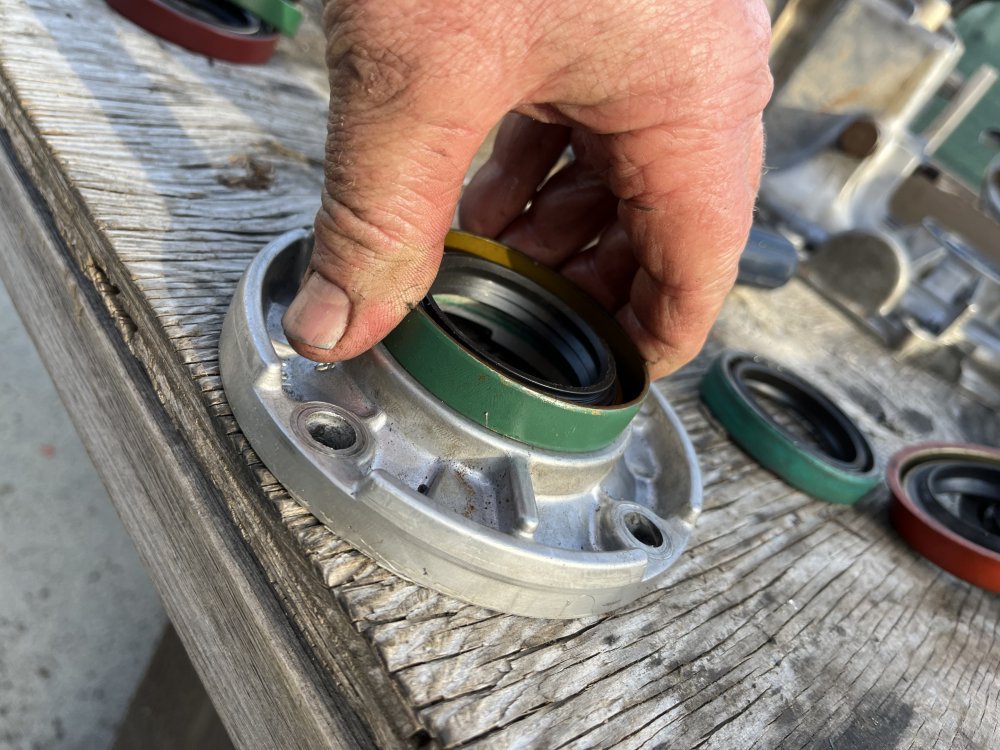

Another set and they’re not even the same color:
I’ll have to get this sorted out next week.
View attachment 80693View attachment 80694
View attachment 80699View attachment 80700
