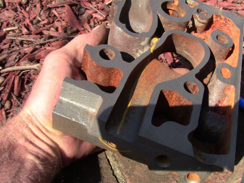

Thought some might like to see just how thick or thin a 6.5 head is...
I needed to know the thickness of some parts of the head, so I cut one apart... the runners are less than 3/16" thick.. not a lot of room for error if doing a major port job is there.... and very thin around the valve seats....

Nice! Turbovanman had a head cut apart and I've been anxiously awaiting his pics so it's great to see yours! Any idea how much that vein in front of the guide in the intake port can be cut down?

For the vein, I'm not sure yet about the thickness there, personally I don't remove anything much from the vein/ramp area in the intake side just slick it down and shape it more, the vein needs to be there .......
The exhaust side is a little different, some is removed from the exhaust side.....

It looked to me that the vein was there to help induce swirl, is that your take on it too?
I'm also going to use this sample to show how well the thermal barrier works in the runners, I am working with someone that is building a motor for a dyno for testing and proving power gains for different items for the 6.5.. we want to use every possible coating to help protect the dyno motor, doing as much as possible to learn what works and what doesn't...
