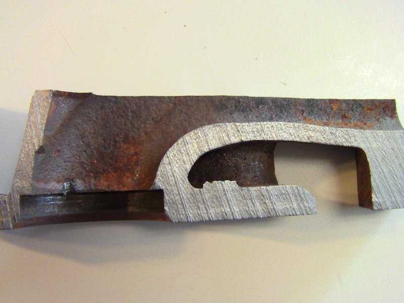

That bore used to be a wide open coolant jacket ( at least it was with the head from a 95 that i cut up cause it did not have these plugs in itThe blue area is an air gap (I think) unless I mistook my machinist explanation. That is the area under those little freeze plugs right?

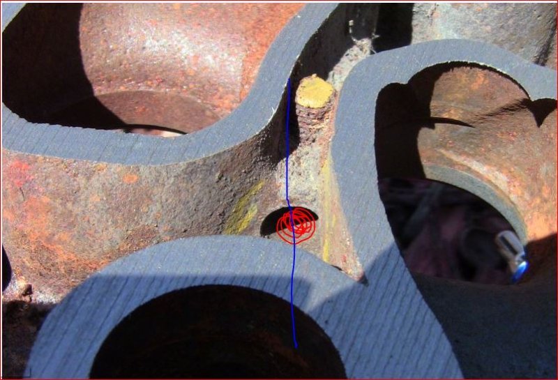

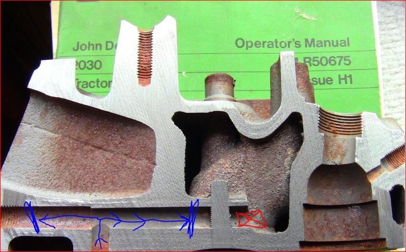

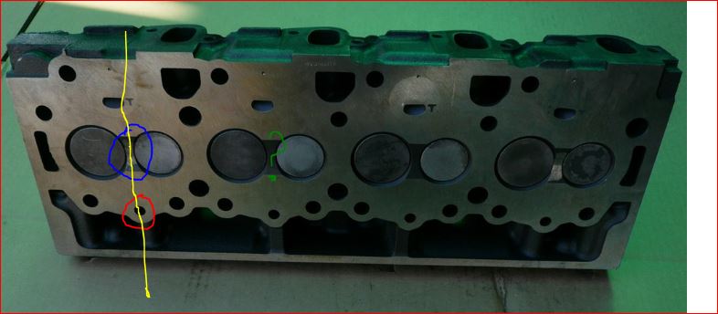

1. The red square/X is air pocket?
2. Does the blue line represent what coolant might do dead head into the bore?
3. Does the drilled bore intersect other parts of the water jacket such that the volume of "stagnate" coolant is actually pretty small?
