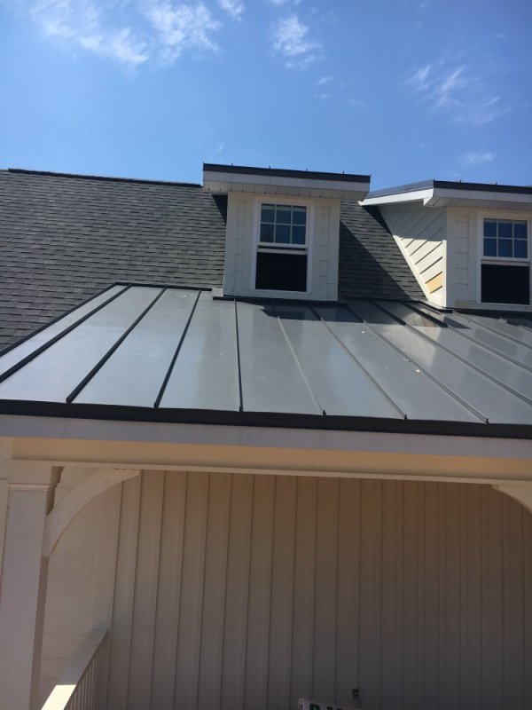

IMG_1109.JPG This is the standing seam metal we used on my house that I'm building now. It has the sealant in the groove from the factory. I don't remember the brand but if you are interested I can find out. The high winds from the hurricane last week didn't bother it at all.
I dont see any screws to fasten it to the roof. How is it held down ?
screws are in the piece underneath. top piece snaps over it. Or they use clips that are screwed down and then the metal snapped down, or the bottom piece is fastened down and then the top piece sets over it and is mechanically crimped via a roller type machine
