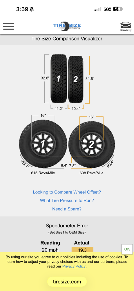

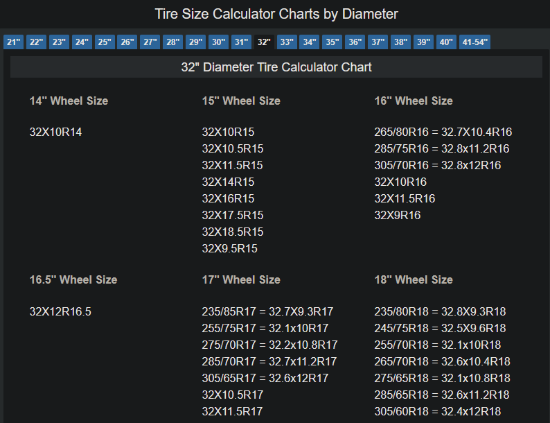

Didn't drip diwn that phar.If you scroll further down you can also compare by tire diameter using the 285's they show 32.8" diameter. here is a list of 32" variants for a 16" wheel

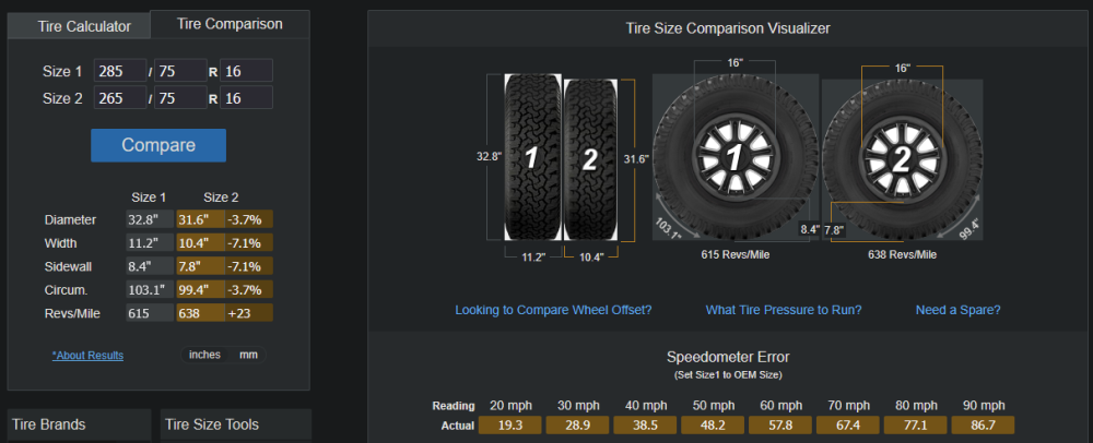

I seen that but oaid it no mind.The compare visualizer also will give you speedo calculations for how far off the speedo will be.

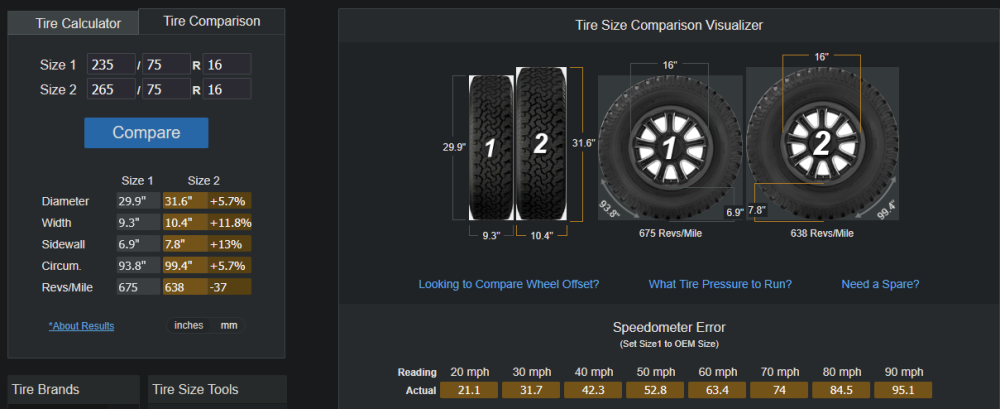

Yeah, I had to clear the page then get back in and recalculate.Something's not right there it gives exactly the same numbers for both the 235s as the 265s
I’m thinking the 235s is whats going to go on.Something's not right there it gives exactly the same numbers for both the 235s as the 265s
