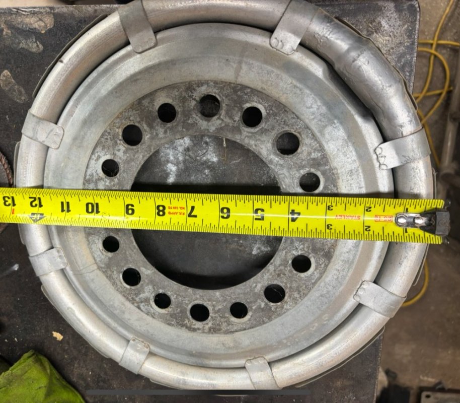

There are devices called Centrimatic and Balance Master. This is a ring that goes on the wheel studs before sliding on a tire. Works on same principle. Steel shot or something similar is inside the metal tube. As the centripetal force increases the steel shot goes to the lighter area and balances the ride.

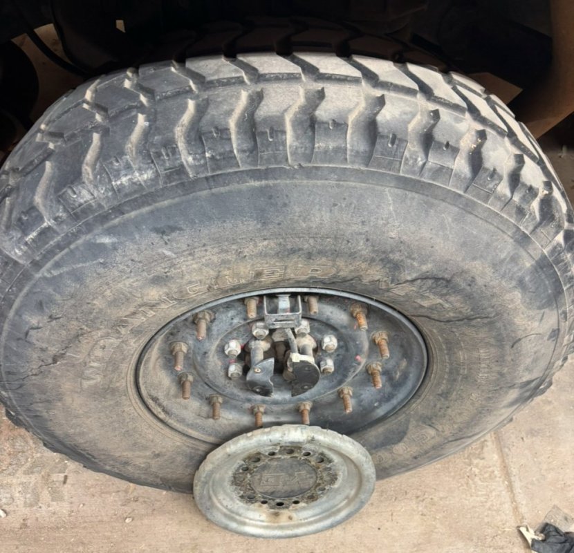

Hummer/hmmwv stock tires are 37x12.50x 16.5 or 17 depending on year. Semi common is to bump up to 40” x 13.5 or 14” wide. So tire balance becomes a significant impact.
My Hummer like many still use the bead lock & runflat device inside the tire. So my wheel & tire combo weight is 165 lbs per wheel.
660 lbs of spinny parts over 3’ in diameter can really create havoc.
So it doesn’t take long before everyone on the hummer forum is learning of the magical devices called centrimatic or balance masters.
the difference is amazing, and you are purposely not supposed to add the lead weight because as tired wears that lead weight could go from helping to hurting.
I have a cousin who built his own wheels for his Jeep. 20” rims for big tires but he learned of these things and took his to a different level. He welded a 1/2” diameter tube around the inside of the rims down below where the bead seats are and made them work as a bead lock backer plate so when he tightens the outside ring up it smashes the tire bead against the inner tubing. The tube on each side has the steel shot in it.
In testing it he actually wire tied on a 1.5 lbs weight to the rim and test drove at 65mph. Barely felt anything. He did it with a 1 lbs weight and it couldn’t be felt at all.
Here is a pic of mine for my hummer next to my 165 lbs “12 bolt” two piece wheel. The tires are serviced like a quad tire- unbolt rim and take tire out of the middle. It’s made of aluminum - I am guessing on steel shot inside- never seen one opened up- just feels like it- more like steel sand actually.
