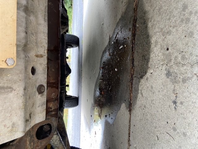

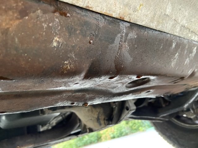

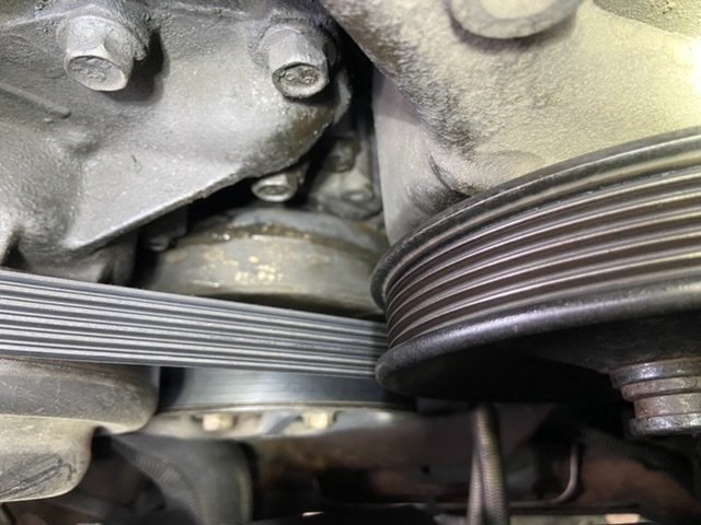

Made the 1200 mile trip from Fullerton, CA to Stevensville, MT just fine, but the truck has developed a leak from the water pump. Coolant is coming out from somewhere from the bottom of the pump and running down the driver’s side of the Fluiddampr. It is still leaking like this more than hour after shutting down. Should I assume the water pump is bad and order a new one? I have the spin on duramax fan. I think this was a 2000 model pump? Is that correct?

On the bottom of the water pump (all waterpumps) there is a small hole about 3/16” diameter. There is a seal to keep the coolant inside and when the seal fails the coolant gets to the bearings. Hot bearings spinning fast start getting coolant on them will destroy the bearings soon, and when the bearing locks up the shaft breaks and the fan assembly goes flying usually destroying the radiator, the shroud, battery, and whatever else it can play ninja against spinning at a couple thousand rpm. So they put the weep hole in the dead spot as an indicator to let you know something is wrong before one bad part becomes many expensive bad parts.
I would say 99% of the time coolant leak from bottom of water pump is needing water pump replacement. But it can be leaky lower radiator howe at the waterpump connection, or similar issue.
