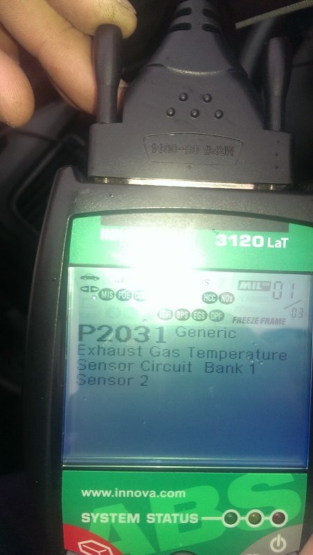

Started Sunday, Glowplug "Coil" light started flashing, then the check engine light came on. Parts store read the code for me and it's P2031 Exhaust Gas Temperature Sensor Circuit. That tells me it's DPF/Emissions related.
I've got an appt at the dealer in the morning, I'm hoping it's nothing to crazy. Warranty is out as I have 65K miles on the car now..

Dealer gave me the quote today. ~$400..
I'm really considering selling the car once fixed. It only has 65K on it, rather buy a new Cruze diesel and get the 100K warranty, and have a CHEAPER payment.
Have you looked into trying to fix it yourself? Did they tell you what the issue was?
Yea, printed parts list/quote. Requires you to buy a special tool, and so forth. Not really worth it. the other thing, I have 64K on it. At the 80K mile service it's going to require that trans flush by VW. Since it's out of warranty, I won't do it. But I'm afraid of the long term affects after that.
$577 and I'm all good.
