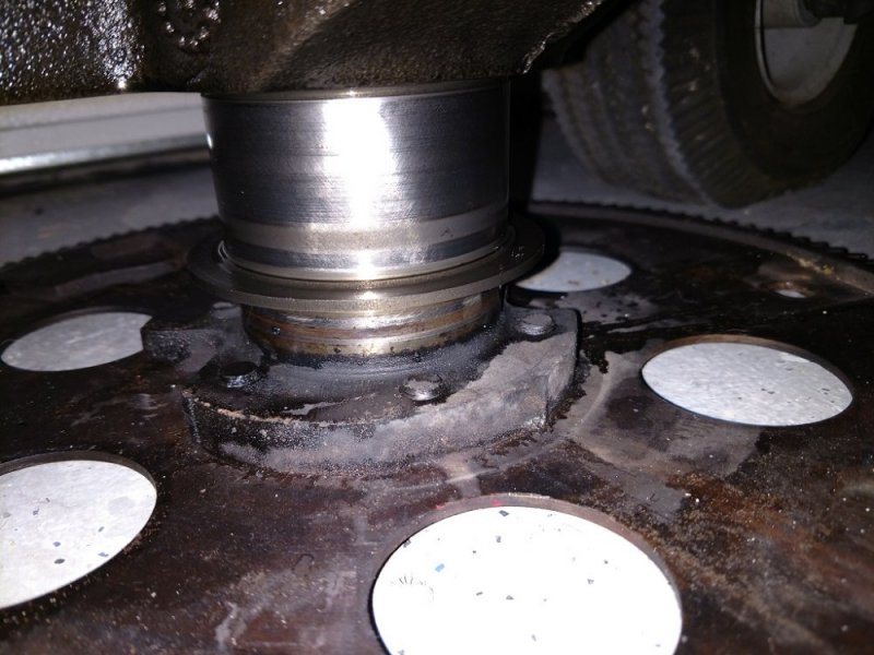

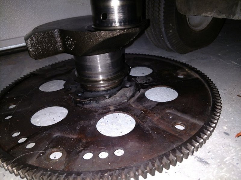

Sorry I spoke too soon. @Will L. and I traded pictures of a 6.5 crank and checked out the rear main seal difference. I have a 6.2 and old one at that. (That will not work.) Old 6.2's have 2 piece rope rear main seal. Newer 6.2's and all 6.5's have the 1 piece rear main. See pics of what I have below. I suggest you call Ted's Trucks N Stuff as they sell parts and may have a used 6.5 crankshaft, cheap.
Thanks! I'll call teds.
