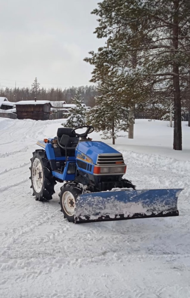

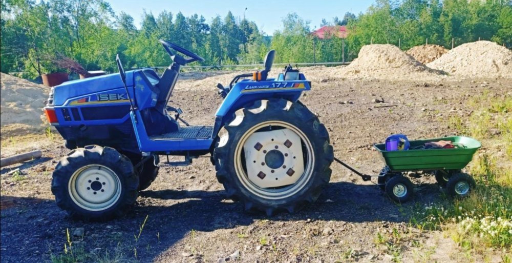

A mini tractor is a more versatile thing. You can remove the snow, plow the garden, and haul in the logs.
It's my Iseki 17hp.
