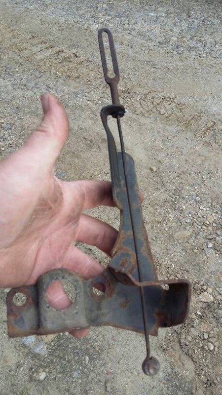

If you give up on it nterested in selling your tv bracket? I’m looking for a 6.2l to 700R4 bracket and rod (trying to replace a th400 in a CUCV with a 4 speed).
Unless you seriously build that 700R4 (especially the OD section) and put a billet multi-disc clutch torque converter in it, the torque from a 6.2 will eventually take out the TCC and/or the OD section. Too much torque too low down in the RPM range for the 700R4 to handle unbuilt. Keep the TH400 and drop a Gear Vendors OD unit into it between the tranny and transfer case.

A 700R4's OD section and lock-up torque converter will not hold up under the low RPM torque of the 6.2 combined with any vehicle stresses placed on it, like towing, off-roading, vehicle weight, etc. - hence why the CUCV and the pre-6.5T HMMMV ran with the TH400 in them. You can run a 700R4 behind a 6.2, but you'll spend about $2k to build an existing one or about $3k to buy an already built one designed to handle a 500+HP BBC race/off roading motor that can then also handle the ~300 lb/ft torque at 1800 RPM the 6.2 puts out. The point being that even behind a 300HP/300TQ SBC in a Camaro, the 700R4/4L60E is seeing the max torque up high in the RPM band - often 3,500+ RPM - where the frictions/steels, gears, planetaries can handle it.
