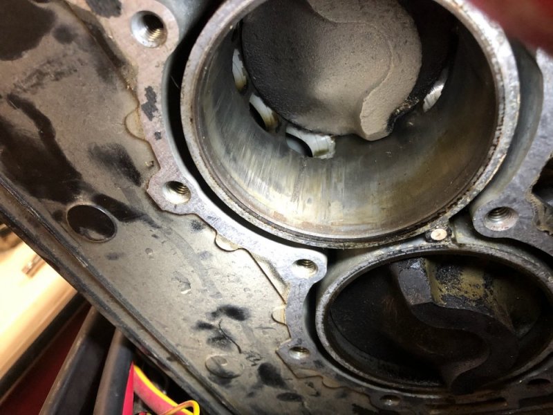

Popped off the head, bad and deep gouge in the cylinder, beyond a bore job depth. :banghead: And so, going to try something that may or may not have ever been tried. Going to clean out that gouge real good and run a bead within it, then, dress it some and get the block bored. The cylinders do not appear to be cast iron so maybe, just maybe it might work to last a couple of years or so.
Cant see it too good, the gouge is in the middle of that lower port.

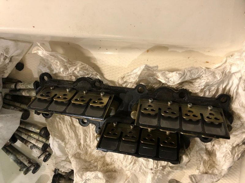

Reed valves all look good.
Where the reed valves mount, three cylinder.

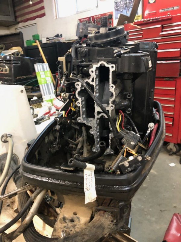

Got most the bolts removed to lift the power head, have a phew wires to disconnect and a couple of wire clamps then, it`ll be drag out the hoist and haul the enjun out of there. LOL

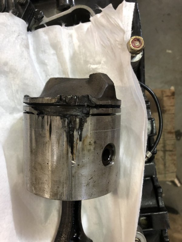

Ok, that is the cylinder at zero, What about the cylinder at half compression ?
1 was at 100 and 3 was at 125. 3 had some erosion around the top of the pistn and rings is thin, 1 had a cracked ring but no real damage to the piston or cylinder wall. That one will clean up with less than a .030 bore job.
How about a sleeve? Might talk to LA sleeves about it
Going to do some checking into that too. I’ll do some search for LA Sleeves.
I’m not sure if anyone on this town can bore this block. Its weird at the bottom of the cylinders, a step in from each side and a slit where the rod passes through.

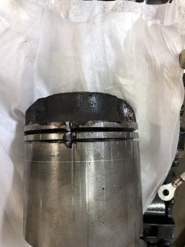

Same piston, other side.
Do research like Les said sleeve soundS economical. They may have recommendations for machining.
I figured the piston was buggered. A bit surparised the wrist pin didn’t knock. I dunno how much do u want to spend for how long? Used engine vs clean it up and rebuild $900. eBay kit. With just clean that bore up and new pistons and rings all around might get you 3/4 -5/6 of the 70 hp for a couple seasons. 55-60 hp would pull tube and knee board if it planed on 2 cylinders Or wait til winter and see what a used engine runs or even one that needs work.
