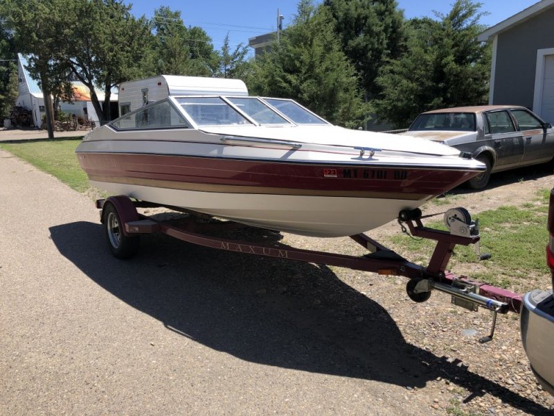

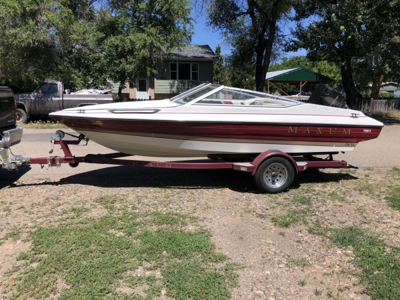

My son went 80 miles north and bought this boat. It looks pretty good and the hull is solid as new.
He got it homw and hooked it to the garden hose and fired it up, He thought it sounded quite good and so had no fear of dragging it about two hundred miles and spend the weekend helping on the friends cabin and boating around the lake.
All went well until he launced it into the water, had a rough time getting it to start, then it was loaded up. He got t cleared out, put it into reverse and backed away from the shore, put it into forwards gear, give it some throttle and immediately it was headed into the beach. Steering shaft in the cross tube had seaized up.
Back onto the trailer and then drove the 40 or so miles around the lake to get to the cabin.
I arrived later in the afternoonh and We messed with it some and it was getting close to time to eat so We set it aside and fired up the grill.
come Saturday, messed around, got breakfast, helped Al with some maintenance on the cabin and got that finished and relaxed for a while.
i told the son, here, You take this hammer, I`m going to put some pressure on that steering wheel and You hit this shaft right here. And so We did, and so, about the third rap that he did I told Him, You have to hit that thing, Bang, bang, bang and the steering popped free. A lot of brake and parts cleaner, and wiping and, some oil and some grease and a bunch more working the steering forth and back and finally got it so it was real nice and free. Back around to the marina He went, launched the boat and came across. he was having some issues with it but We run it anyhow, even though it did not have enough torque to come onto plane, it was still fun.
Pics of the boat when he got it to town.DD28145B-5B6D-4FB9-9338-34A403B0117F.jpegE56AECA7-2398-4531-BFCD-F22808E910C8.jpeg

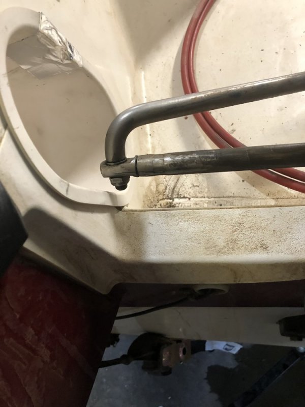

This is that cup affair thing that the steering shaft and link rod travels into, on the left side of the transom, I aint no sailor but I think that is called the port side.
I type in what is going to be typed and then have to go to the phone to get the pics.Seems that either verizon or century link dont like it when i send pics to the computer via email, so, it is type, then, post, then edit and add pics. LOL A lot easier than trying to post frum the phoney. LOL

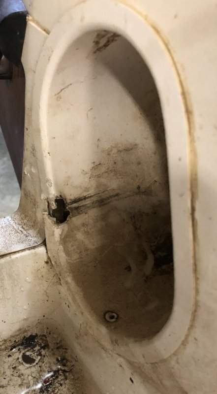

That black spot is the hole that let in a lot of gallons of water from the backwash of the engine, I think it was the engine creating the big back wash.
Patched it with a piece of that aluminized heat duct tape and spin it 180 degrees so that the spot with the hole will be forwards and towards the top. It didnt seem that the water was getting that far forward or that high.
Going to grind off some threads off that link rod too so there will be a little more clearance to that cup thingy.

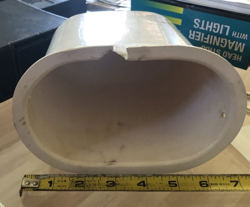

If someone knows what that thing is called please post its name, maybe I can find a new one.
If the outboard does not have foils that attach to the horizontal fins (just above the prop), might consider getting a pair. This is usally very effective at helping motors which are at the threshold of usefulness. The fins will not add enough power to jerk a slolim skiier, but it should help get the boat up on plane. Also, a lot less expensive than a bigger outboard :D At the risk of insulting, another trick for getting up on plane is to have the heavier passengers move up to the bow for launch, and then move back to the cabin area once up on plane.
For which side of the boat is which, correct in that the 'left' side is port. Easy way to remember is that port and left each have four letters. Related, for night operations (presuming the boat has working nav lights), the key to knowing which side of the other craft you see is that 'port wine is red'.
For naming that piece on the boat's transom where the steering cable protrudes, it is called: manufacture laziness. My take is that the manufacturer should have designed the transom which allowed for water to enter without concern of flooding into the bilge. So, 'cup' will work just fine.
It looks like, at one time, there had been something fastened to the fin around the lower unit, above the prop. There is four holes drilled through and nothing attached. i thought maybe a planing fin or a trolling plate.
