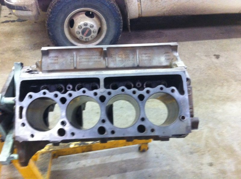

#6 has less than 300psi, so I am going to order a rebuild kit, dang. At least on first inspection the block is crack free.

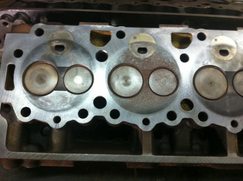

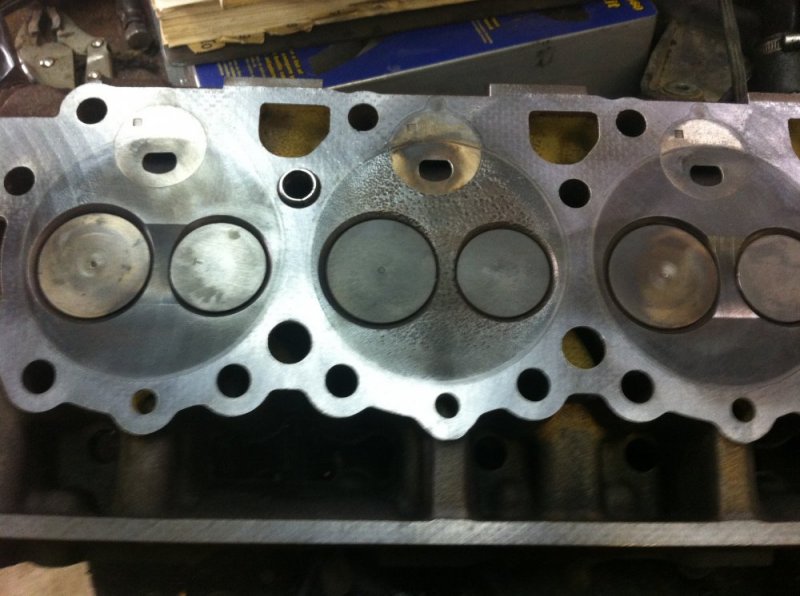

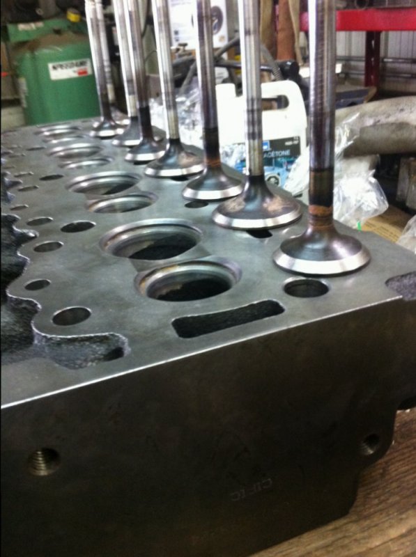

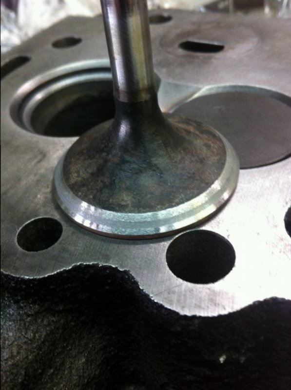

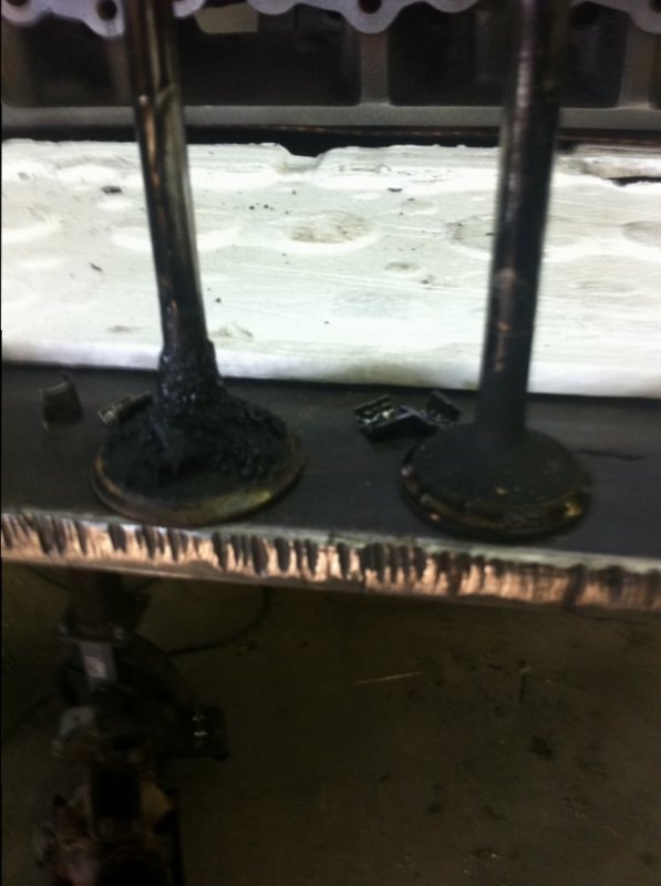

Number 3 cylinder has pitting on the headIMG_0786.JPG so does #6IMG_0787.JPG Block is cleaned, honed and threads chasedIMG_0788.JPG The EGR engine intake valves are nastyIMG_0789.JPG Still waiting on all my parts. I had bought new bare heads from Bison, these valves are at the high end of service so I'll use all the parts in the new heads.

My old heads also had pitting in 2 cylinders. Those should be the same cylinders that the EGR port is built into the exhaust port. I don't know why the EGR has that effect, but it seems to be the reason.
Makes sense as those two cylinders are the same location on the head.
Correct. The purpose of the egr is removing the amount of NOx from the atmosphere(acid rain and smog). Rerunning the exhaust gas does this, but along with higher concentration of NOx(nitrogen oxide) is increased S02(sulfur dioxide) and Water. When they cool everytime you shut off the engine, it forms sulfuric acid,nitric acid, and a little hydrochloride.
