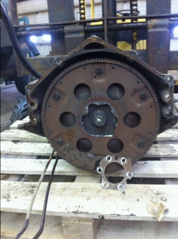

I recently picked up a 94 2wd with a 6.5, I bought it with a stipulation that it ran, the owner didn't plug it in and the batts were weak. I lifted the back wheels with my bale truck and shoved it onto my gooseneck trailer. In my shop plugged in it started with little smoke, I drove it off the trailer. I was told the flex plate was broken, it was, what a racket.

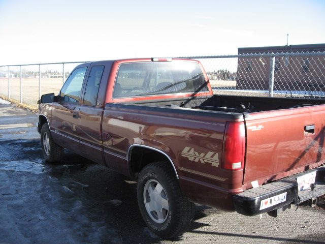

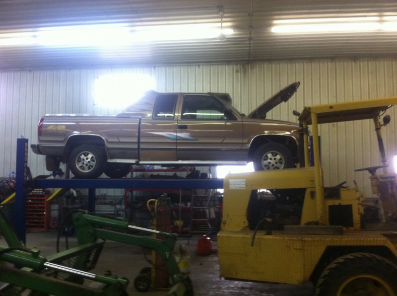

Pic of the donor truck
Broken flex plate

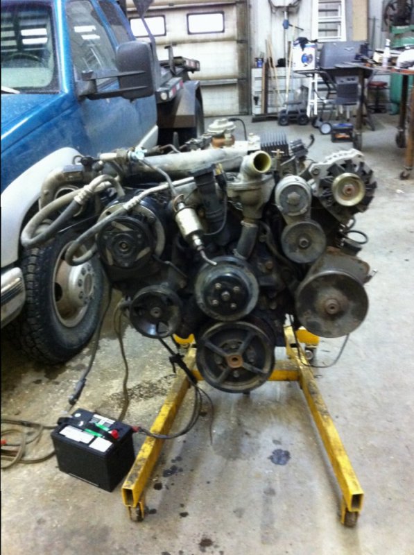

Donor engine, a bit rusty
I know it is Les, at least they are uniform. I just want a runabout, not a puller or racer.
I'm just trying to talk myself out of a rebuild.
Give a a great starter, new batteries w/ big cables, and new Bosch glow plugs. That will help those tired rings on start up.
Wonder how blow your is, or fuel to oil contamination at that wear.
I wished I would have checked for blowby when it was running, with the broken flex plate I didn't want to run it anymore than necessary. If I got 50k miles out of it as is I would be happy. The unknown:(
Yeah, don't know that I would have ran it anymore either. That had to be a racket broke off like that. Hoping for 50k miles, I'd go for it. Inspect the balancer real good while its out.

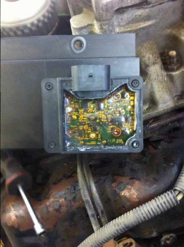

I found this interesting:IMG_0756.JPG

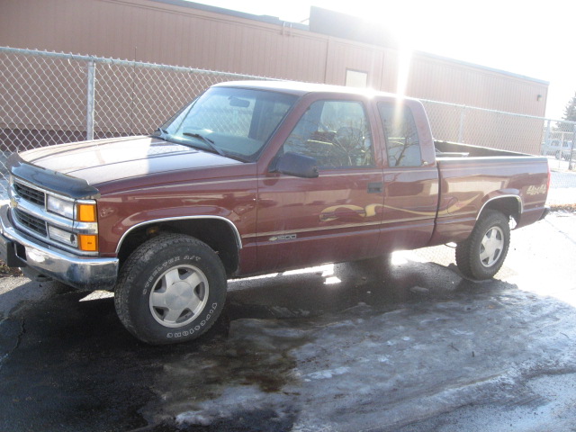

The donor is a nice looking truck, but has a fair amount of rust and is only 2x4. The 98 is rust free, but has the 60/40 bench seat. If I don't like it I may take the buckets and console out of the 94 and exchange them. The colors match.

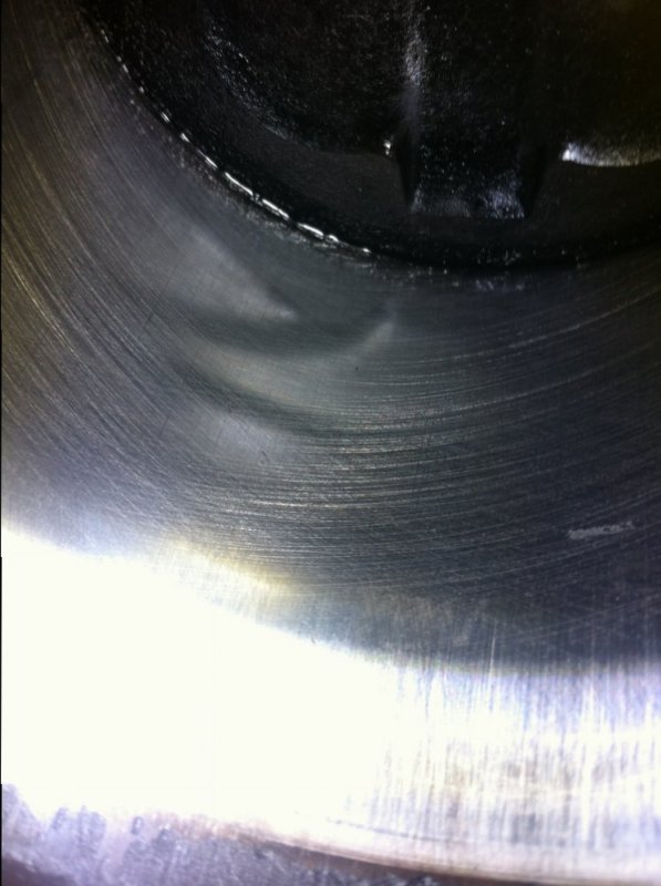

#6 has less than 300psi, so I am going to order a rebuild kit, dang. At least on first inspection the block is crack free.
Is that the new water fillable, high airflow pmd (pretty melted, dumba$$) model?
Not that most of us haven't cut into them going "if I can just fix this..."
I still can't believe one of the good electronic dudes out there hasn't reinvented this square wheel.
They sealed it up with some soft see through stuff. The truck ran with it. I'll have to contact the previous owner and ask what's with it.

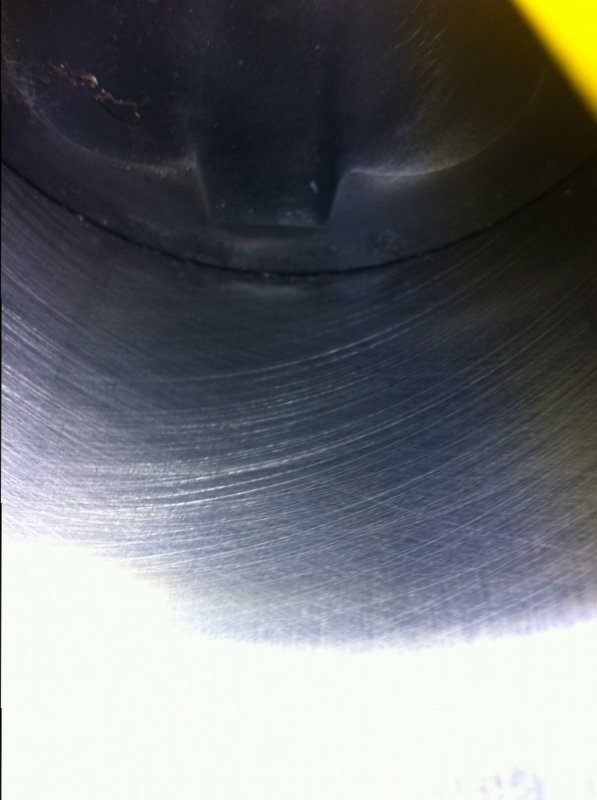

More good news, the cross hatch still looks pretty good. Much better than my last go around.
