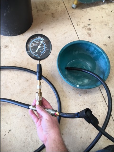

I strongly suggest a fuel pressure gauge a 9-14 psi desired pressure- The ip sucking fuel all the way from the tank wears out the ip much faster and those suckers are expensive as heck, plus hard to change in a van.

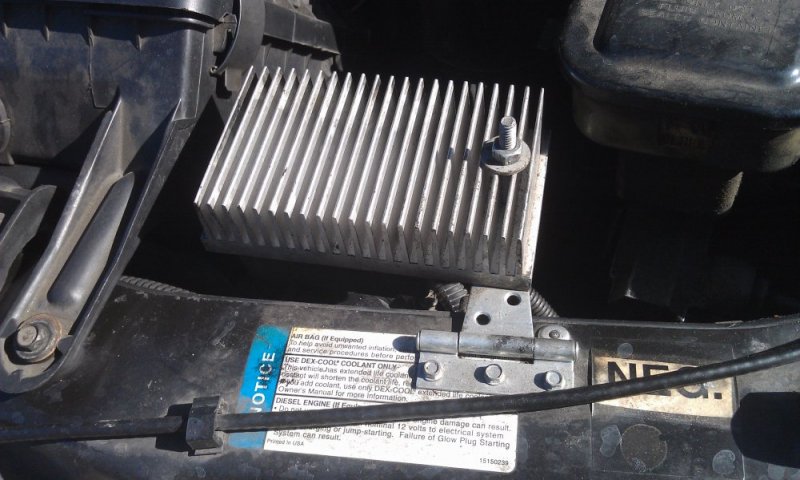

With your PMD relocation - you do not say where you are putting it - but mine is on the front cross member next to the top of the radiator - between it and the hydroboost - on a small T type hinge so I can flip it up to change a PMD fast and the fins up in the air flow that comes right under the hood the same as the air inlet to the engine. If you put it just a little on the cross member it stops and sits nicely right there in fresh cool air
Related to the heat of the PMD is the fuel pump pressure to the IP inlet and I know it does not make sense initially - but the DS4 idles by the pressure it has to multiply on a correctly set up throttle plate. In essence the speed of th engine increases the pressure and that gives more injection pressure so that the throttle plate only needs a small assist from the PMD as a PWN signal to the Fuel Solenoid - but when there is no - or inadequate fuel pressure it tries to hold the throttle open and from a solenoid that over loads the power transistors in the PMD they get hot and fail.

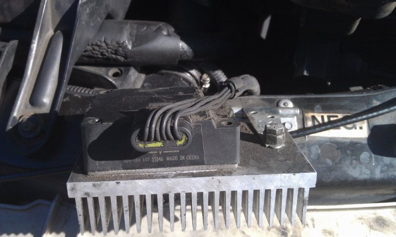

Attached are pics of how I mount my PMD relocation - simply flip up the hinge to swap it. It is a simply PMD kit from Dorman. The other nice thing is you can put your hand on it to see how warm it is - if it is too hot to hold onto something is wrong. the other thing I do not kn ow if anyone told you - keep a spare always. These go and you are dead in the water - PERIOD. The nice thing is if you are travelling and you need one - Walmart will get one to you where ever you are are their local store usually in one day or two.

The heat sink on hinge idea I have never seen before- cool (pun intended)
Rather than carry a spare pmd in the glove box and taking time on the side of the road to swap it, in the fleet we bought larger heat sinks and mounted 2 next to each other. Then use an extra plug with silicone on it to keep out dirt. (Nowdays better to just buy 2 small sinks) then when any issues, just swap the plug over and go. Then later remove the bad one and send back to Leroy for the lifetime warranty.

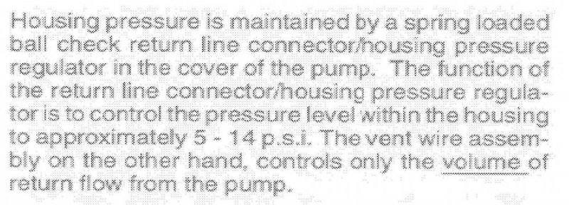

The Stanadyne DB2 and DS4 test spec sheet commands that the pump be tested at 5 psi + or - (plus or minus) .005 percent tolerance, at idle or Wide Open Throttle - volume is just irrelevant because by Boyle's law you MUST have sufficient volume to maintain that pressure anyway. Of course the test stand for the IP does not use the crappy little OEM solenoid pump to try to test the IP and it was tried one time - and the thing could NOT perform as needed to complete the test. That told the story right there - a brand new OEM solenoid Style Lift Pump could not do it. More volume through the IP on eh test stand through the injectors meant the OEM pump lost pressure - PERIOD. That is where this FTB mod thinking comes in.
The top end spec of 14 psi is when Boyle's law over loads the IP and the return valve cannot get rid of excess fuel fast enough.

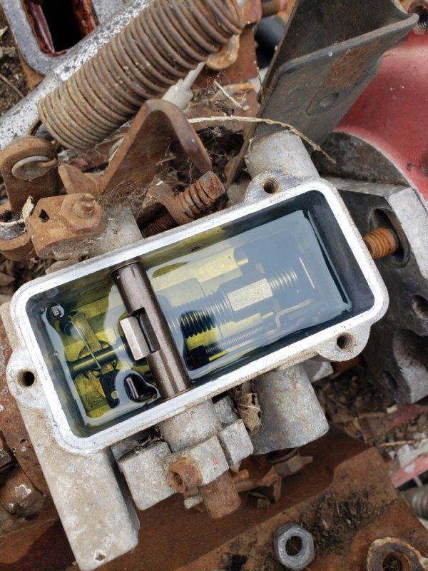

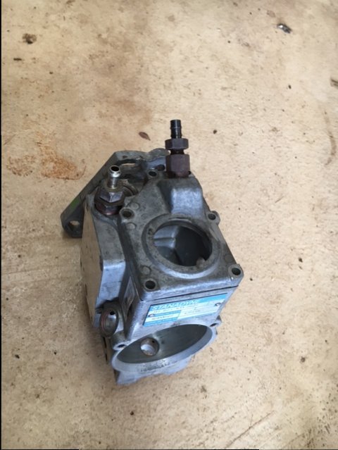

If I opened a DB2 and saw this below - I would know it is just not getting enough PRESSURE - otherwise the IP would be FULL to the brim and in fact upon unscrewing the lid, fuel oil should have squirted out or the system is leaking down - which would happen from extended sitting - but not let it drain back to below the brim of the cover.
Anyone who does Gasoline fuel injection knows this well and it is the same for the IP's
The same with the DS4 housing below this one below
So many people have tried to come up with band-aids to the poor performance of the OEM lift pump - this is the result - irrelevant science.
So many DS4 and DB2 pumps have been running starved for PRESSURE - sometimes the return check valve actually sticks shut and will not open when the proper pressure is put on it and should be tested to make sure they are opening like the last pic shows
I simply repair the PMD by replacing the power transistors - I have a bunch of them - and have not done one in long time since there are no failures now for three years. A Lifetime Warranty that make you work is just a PITA.
I actually used a dual PMD system on a remote mounted external tank that the return line ran through - and when taking the temperature of the PMD even on a hot day - it was cooler than the return line fuel temperature - so I went back the flip up PMD setup you see.
Another thing the PMD does is the power pin gets hot and warms the connector and then sometimes needs tightening by bending it slightly to be tighter to the pin - using like a small jewelers screwdriver to been the connector side to be a little tighter on the pins in the PMD
Another thing it does is the calibration resistor gets hot and the traces burn open or the resistors itself ops open. A new external resistor solves that forever.

So, keeping pressure from 5-14 psi in a ds4. And keeping in mind more problems occur at 15 psi than 4. Teach how. Have video showing psi at the pump from idle to 65 mph while towing max weight up hill. Then show the LP, water separator, and filter(s). No doubt GM screwed the pooch on things. Fuel system especially. But if you have a great solution, please share- you can rename it FTBB feed the beast better or ftb2.0.

Dude. Go adjust you psi to your minimum spec and smog it on the rollers. Then adjust it up to max and donit again. Show the difference. Make a youtube video. I know the results, we did it. We tried to vary the outcome through experimentation. You are wrong. You cant compare direct injection with idi. Inlet fuel pressure being in the peak VOLUME and PRESSURE makes the best power & cleanest emmisions at the same time, period. It is an efficiency issue.

Page 1.8 of the Stanadyne DS4 Operations and Repair manual states:
Hence above 15 psi there will be problems and at or near 15 there MAY be problems. But going through a filter the amount of pressure one looses - often compensates. As my post above shows - use of 7 to 9 psi pump solves it - BUT I am talking about a Positive Displacement Pump Rotary Vane Pump that can deliver a true PRESSURE and VOLUME unlike the OEM solenoid lift pump.
