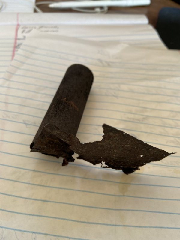

Alright tried to replace the rear two plugs on passenger side w/o pulling the fender well and no go. Looks like one is up behind the down pipe and the heat shield is toast:
I assume there is one further back of the down pipe, which means I will need to drop that out of the way. I will order the heat shields from PT Wiring Solutions and do this all at once along with the new wire harness.

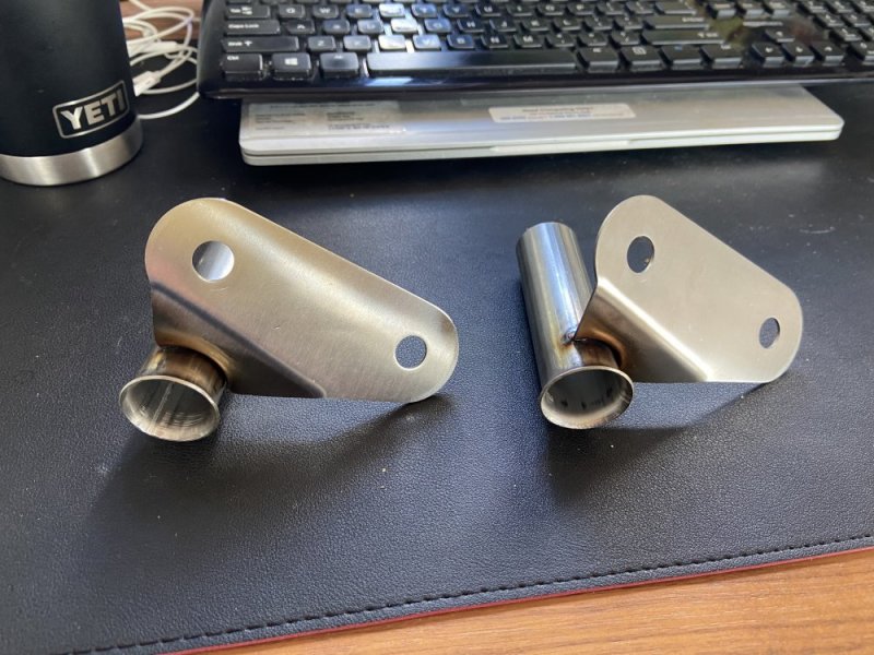

Got the PT Wiring Solutions glow plug harness, but waiting for the stainless steel shields to arrive, so it will be done next weekend. Harness is nice. Instructions say to remove the right fender well and down pipe to do the passenger side.

My order for the heat shields went through at PT Wiring Solutions, but I have not received a shipping e-mail. His site does not provide a phone # for contact, only e-mail. I sent him an e-mail inquiry yesterday. Wondering if he's out of stock and needs to make some?
Anyone have a phone # for PT Wiring Solutions?
