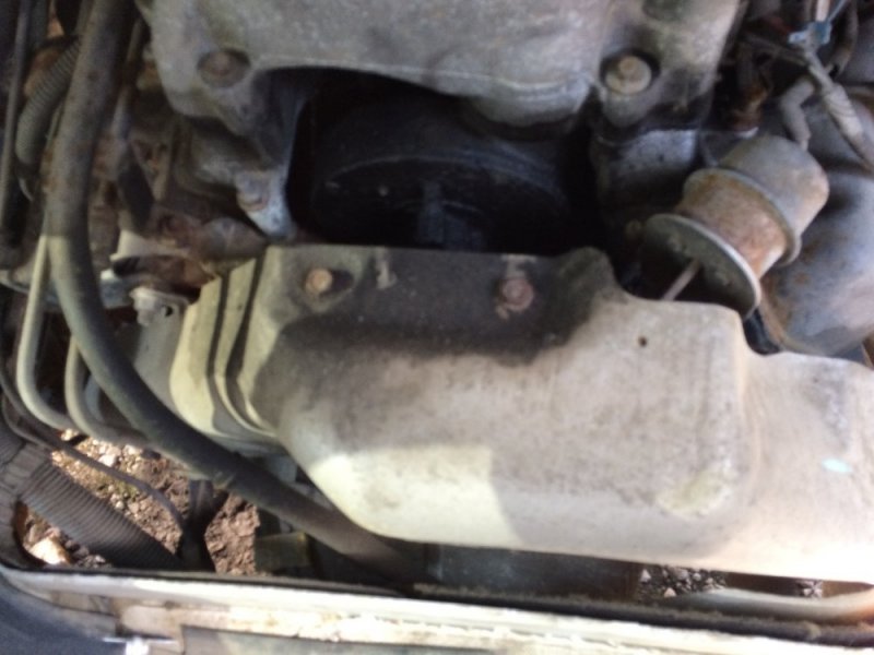

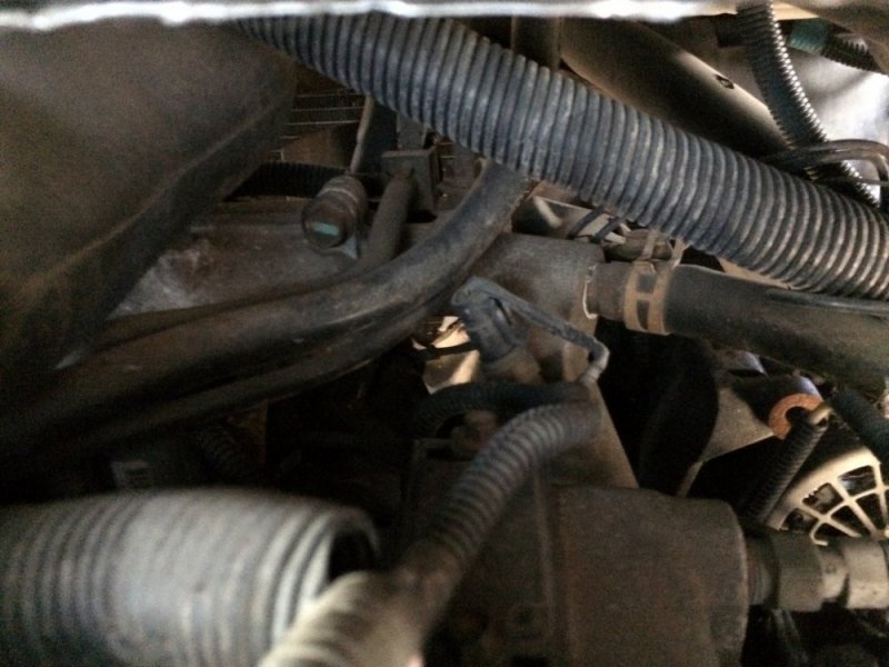

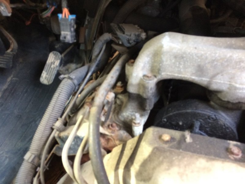

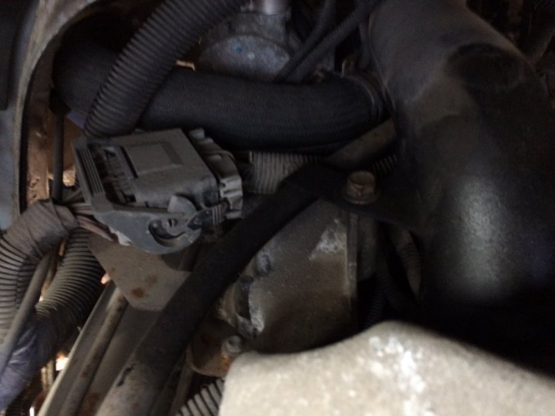

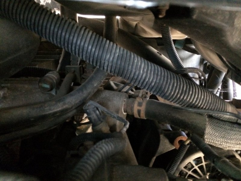

I found a 6.5 van at the yard by me today. I'm not sure if it would work for you or not - it starts on the passenger side, then goes around the turbo to the driver side then once past the intake goes back over to the passenger side. It ends way forward and up pretty high since it's a van and there is limited frontal access. I'm not sure what you can make out in the pics, but here you go:IMG_9217.JPGIMG_9218.JPGIMG_9219.JPGIMG_9220.JPGIMG_9221.JPG
