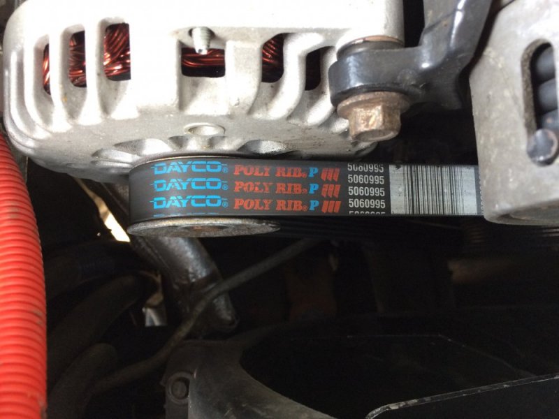

Also, I am deleting the vacuum pump. Anyone know for sure what length belt I need? I think I've heard like a 1/2" shorter, but if anyone knows for sure, that would be great!
I got the 99 1/2" belt. It fits, but it's right at the tight "limit" on the tensioner. A 100" would probably be about perfect, but this one should be fine.
After it runs for a little while that belt will stretch and be in the middle. That's the best size that works on my engine.
X2
I had a little bit longer belt (I don't remember what length), but in not too much time it had stretched out.
