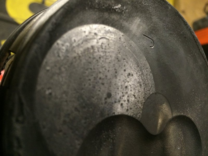

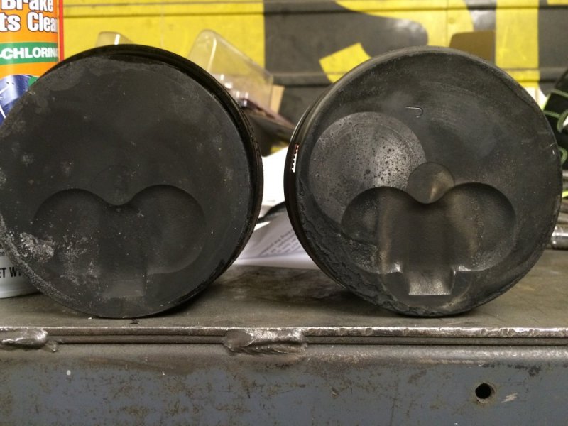

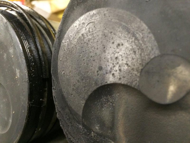

Nate, have a picture of your pistons that you said had light valve contact? Ive seen so many pictures of pistons that look like there are two circles the size of the valves and people are thinking valve made contact. I don't know why the impression thing looks like it does, but I don't think there is contact (on the ones Ive seen anyway your may be different)
If you see actual deformed/dented piston tops the yes obviously they contacted.

Here are a couple pics. The piston on the left is the original 1997 piston. The piston on the right is the piston with the Delta cam and 1.6 ratio rockers. I have seen what you are talking about and the 1997 piston kind of has it - it's like the carbon gets deposited a little differently under the valve heads. However the piston on the right is wiped clean of carbon under the intake valve. Also if you look close you can see swirl marks from the rotating valve head. I wasn't going to risk it, the pistons came out. That Delta cam was an expensive experiment despite my clearance-checking efforts.
View attachment 47989 View attachment 47990 View attachment 47991
Thats definitely not like the pics that were going around. Looks like you said, a light contact. Only on the one piston though?
