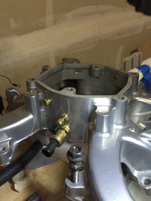

I have a second lower intake that I don’t use. It is from another members build that went south and has been extrude honed, as well as tapped to accept the OEM ECM boost & air intake sensors as well as after-market gauge senders, WMI & Propane nozzles. He's the one that gave me the idea for the Peninsular "Hat" intake set up only his was tapped to accept Nitrous too (and you all think I'm insane)!
The additional taps aren't a bad thing given the use of the Peninsular ‘Hat’ for an upper intake and the resulting need for someplace to put all the added stuff (I simply inserted 1/8NPT plugs in the holes I didn't need). Utilizing this one eliminated the need for the spacer I had built for my OEM intake set up (I didn't want the Pen Hat looking like a porcupine).

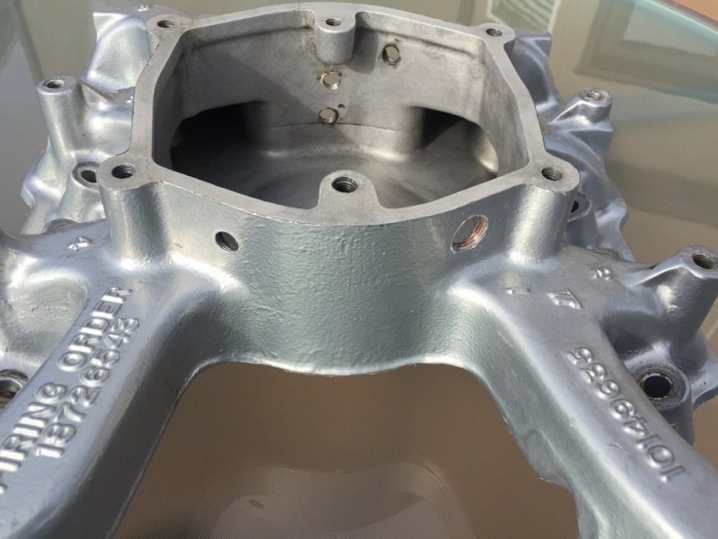

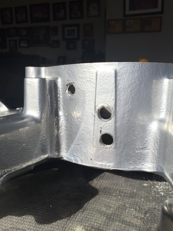

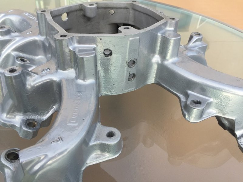

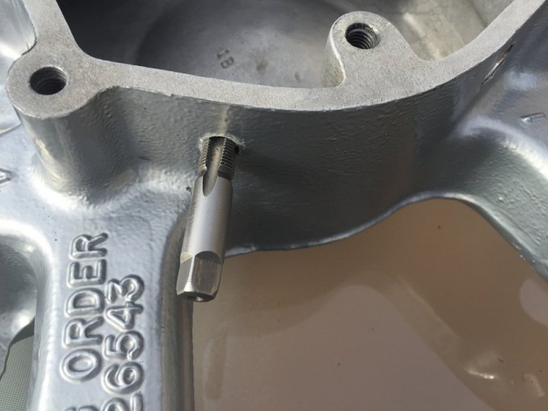

However, the WMI/Propane ports I didn’t use were apparently tapped too deep and wouldn’t seal. No matter what technique I used; thread sealer, RTV, different length plugs, shouldering the plugs, rubber washers between the plugs and intake…they would weep oil from the CDR and that meant I was losing boost however infinitesimal. Even swapping the senders in to the weeping holes didn’t work.

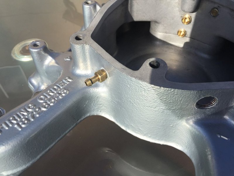

Compare the boost sender hole (no weeping) to the WMI/Propane holes on the back side.
Boost Sensor front, Sender in the back.
WMI/Propane tapped too deep.

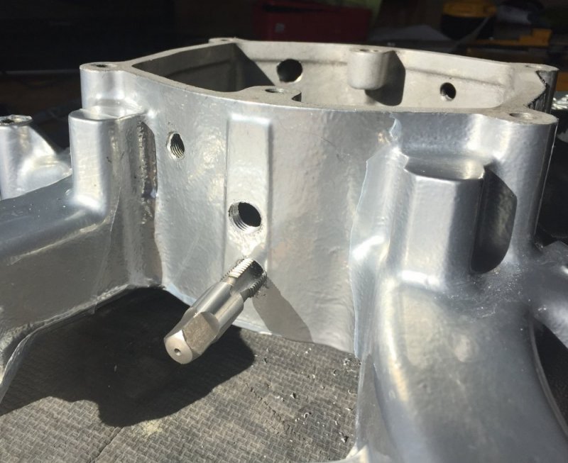

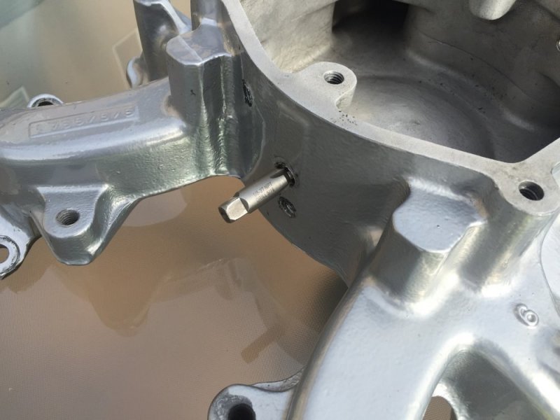

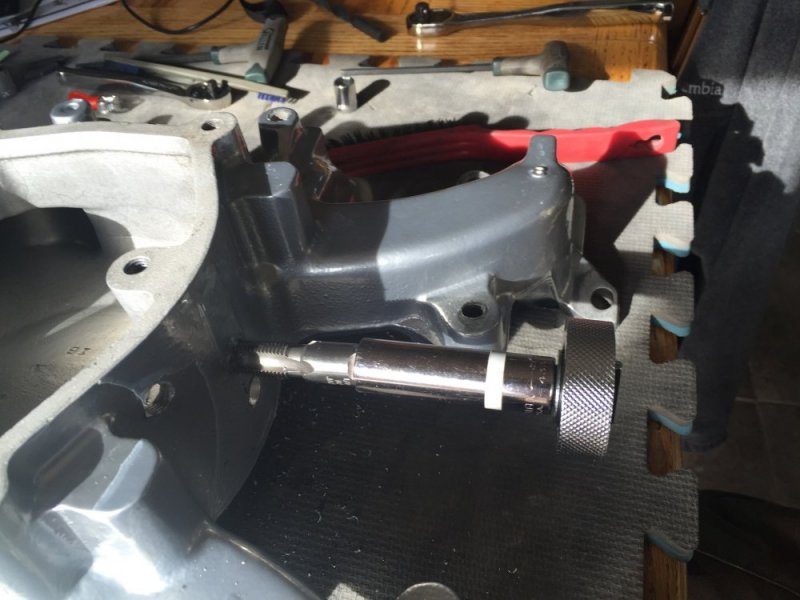

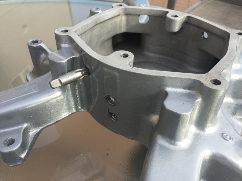

Asthetically, it didn’t really matter because the weepers were in the back but it remained a point of concern. I mentioned it on another thread and I think it was Leroy that recommended to simply re-tap the weepers correctly using 1/4” NPT and insert a bushing tapped for 1/8 NPT to solve the issue so, today, I went ahead and did just that. As I had already swapped my old black intake in, I didn’t worry about it and besides, I had that nifty spacer to use in the meantime with my old lower intake. Anyway, fickled me, I’ve decided to go back to this intake so, repair time.
After cleaning things up, I carefully drilled out the weepers using the recommended 7/16” bit and then ran the 1/4" NPT tap using a hand ratchet and ½” 12Pnt socket (too close confines to use a T-Handle) to get things started. I used a ratchet handle to finish the job.

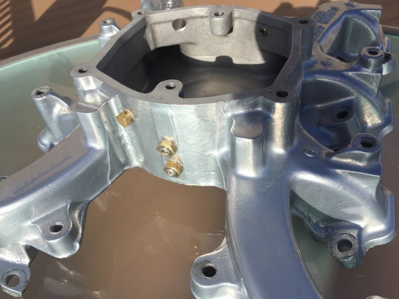

Finished it up with the 1/4NPT bushings and inserted 1/8” plugs and inserted a shorter 1/4" barb for the ECM Boost in the front.
Prior to inserting the bushings and the 1/8NPT boost hose barb, I coated the threads with sealant and then froze them. It may not make a real difference but I figured by keeping the lower intake warm, the holes would expand and inserting a cold plug would allow them to seat a little further. Once everything returned to an equal temperature, the seal would be a little bit better. Probably wrong and I’ll happily entertain the reasoning as to why from the 100’lbs heads around here so we can all learn a little bit.

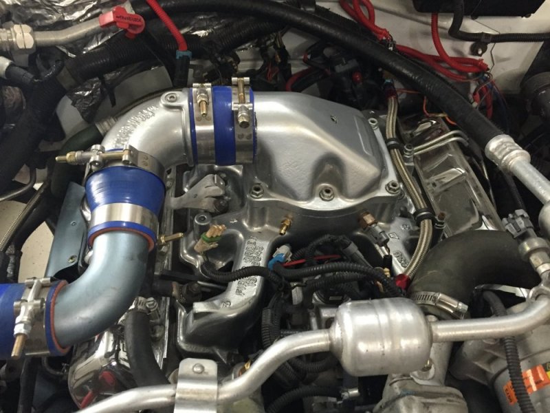

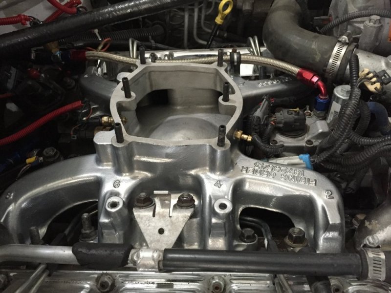

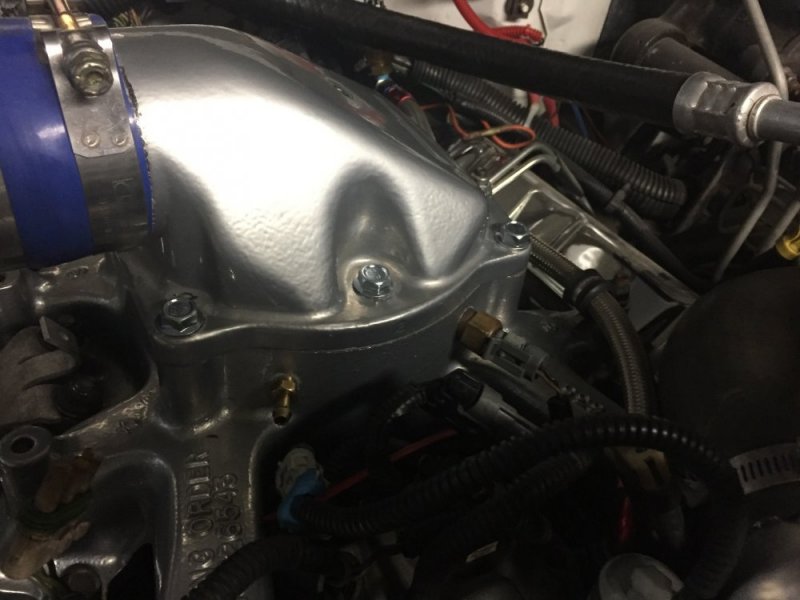

Remove: upper Peninsular intake hat assembly; studs; AIT and Boost Sensor connectors; sensors; grounds from main point and back of engine; fuel line hold downs; fuel line; negative battery cables; heater hose; and, finally, the bolts followed by the intake. Note where the shorter studded bolts originated from (the five long ones are self explanatory).
Install in Reverse order to put the new unit in. I attached the AIT and Boost Gauge Senders prior to replacing the lower on to the motor for ease of access.
The studded bolt in the fore ground is for all the grounds save the braided copper one that attaches to the back of the manifold at Cyl #8.
As always, replacing the lower is a little trickier as one must be careful to not collect any of the wiring or the return line retainer tabs on the passenger side between the intake and the heads. After coating the threads with copper anti-size I got the bolts started by hand and then snugged them down in an ever expanding “X” pattern from the middle to the outside bolts. Then I made two passes at them with a torque wrench following the “X” pattern from the inside out; first at 20 ft lbs and then a final at 31ft Lbs.
Then it was ECM sensors, Intake hat and associated tubing. I’ll have to wait to use studs as the ones I used with the spacer are much too long and I’ve only got M8x1.25 x 30mm.
I’ve got some M8 flared bolts to use to hold things together in the meantime.

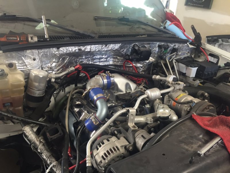

Finally got the firewall covered with the RAAMaudio sound dampener material. Hands are cut to shreds from the aluminum. I'm not looking forward to covering it all with the black padding either. May just have to enjoy the Lunar Lander appearance what with the hood covered in the same stuff and all.IMG_7020.JPG
if you cover it you will lose the reflective r value
Good Point. I got the inside covered with the stuff from when the carpet was pulled out for cleaning after the heater core let go a couple of years back.

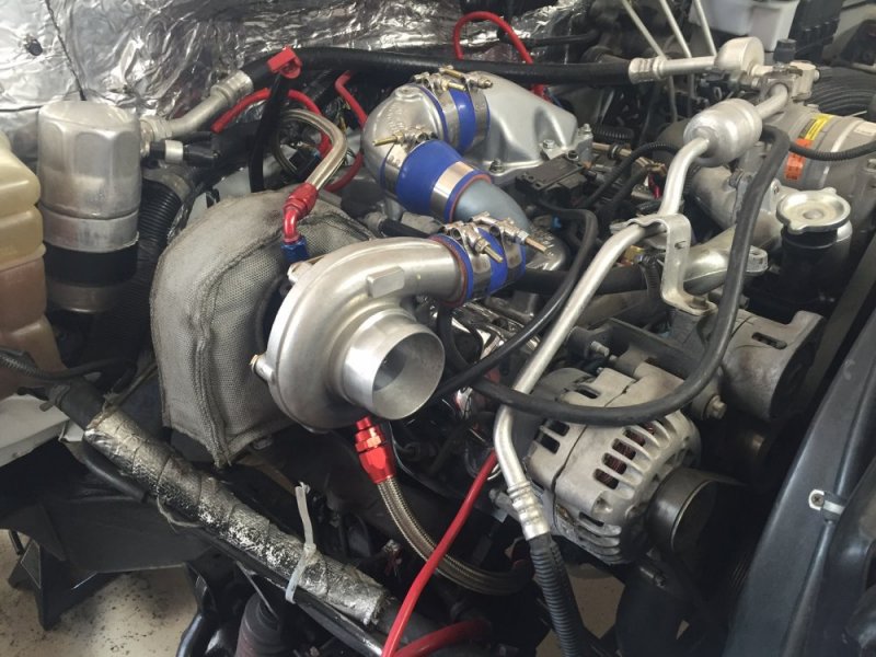

Today the S-86 Turbo was put back on along with the intake piping, oil feed & oil drain lines. I also re-sealed the dip stick tube to the oil pan.

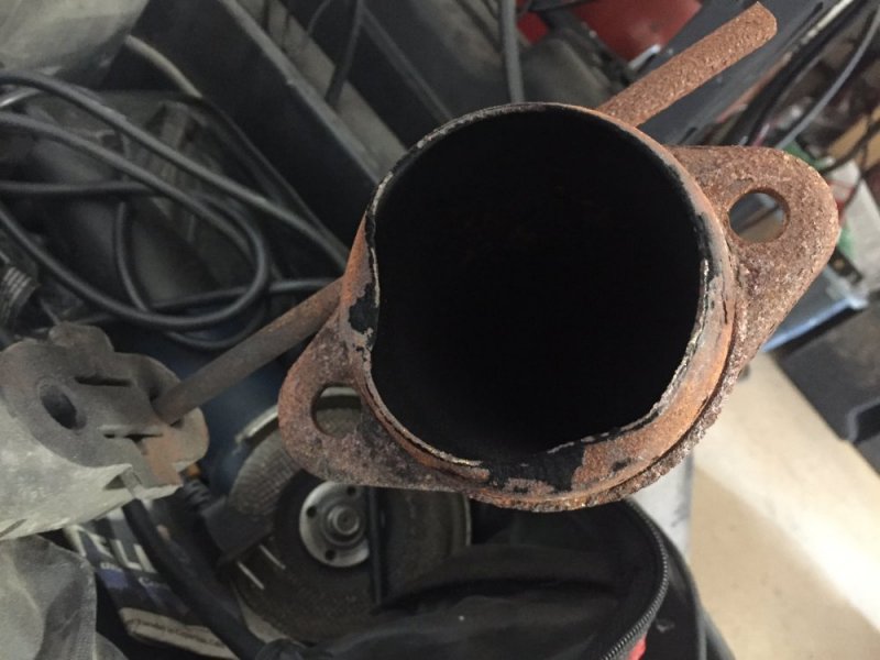

Exhaust was going back in but I noticed the down pipes ball socket was / has been dented up for some time. Lots of soot getting past. Need to either repair it or replace it. At least now I know where the exhaust whistle was coming from all that time.
Got the hammer but something else caught my attention which turned in to another project. "Some Assembly Required" but it is done and ready to help with the post garage projects.
