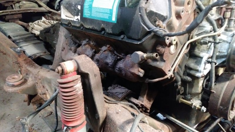

After a multiyear detour with the Burb, am ready to focus on getting my primay vechicle back on the road. While the Burb side-tracked money for this truck, the Burb was helpful with crafting the truck's future. End game for this truck is to keep power about the same, move breating over to a 1:1 turbo system, fix all that rust, and correct some of the manufacturer's engineering.

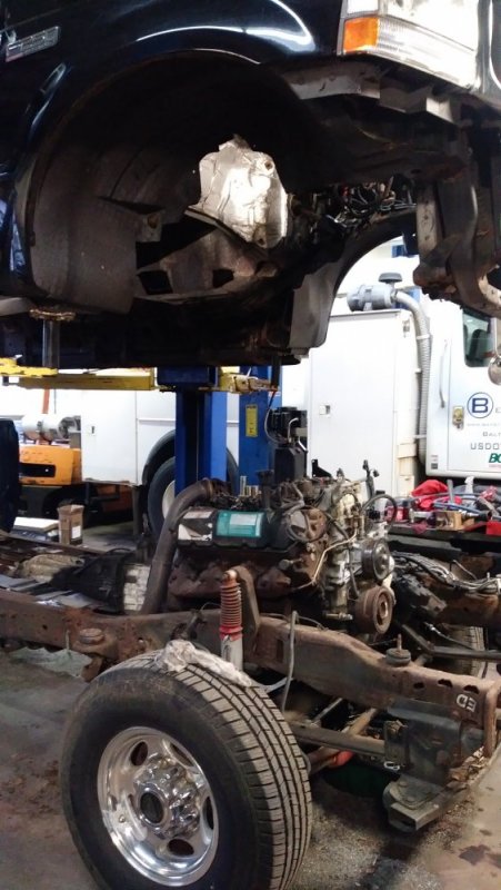

Here is a better view.
Chris is closest, but should have DQ'd him seeing as he coated some of its parts.
F250, 7.3L, ZF6-S650. Did not realize it when I ordered the truck, but apparently the camper option beefed the suspension up to 1 ton.
And apologies as a second look at the first picture makes it hard to see the tranny. Although the Xfer is visible.
At the moment we are sorting through how to eat this elephant and are starting with the motor.
