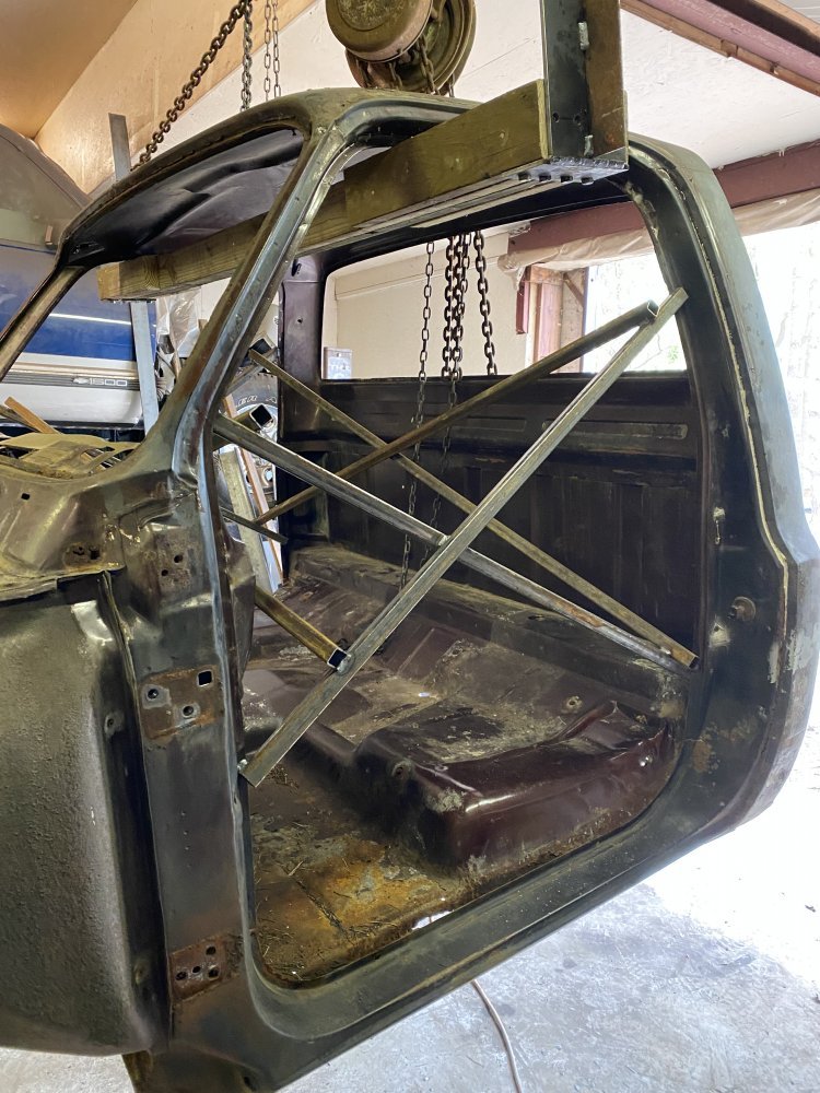

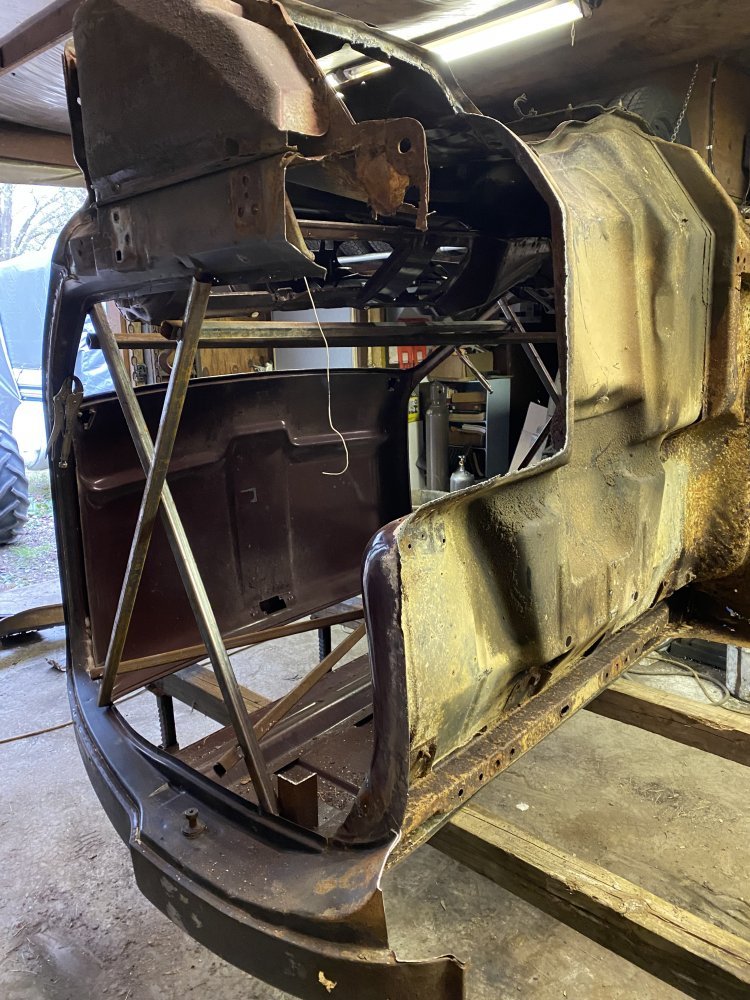

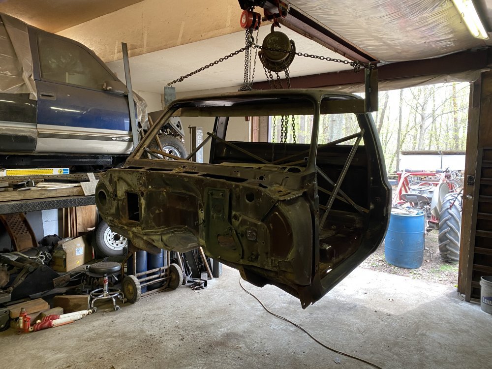

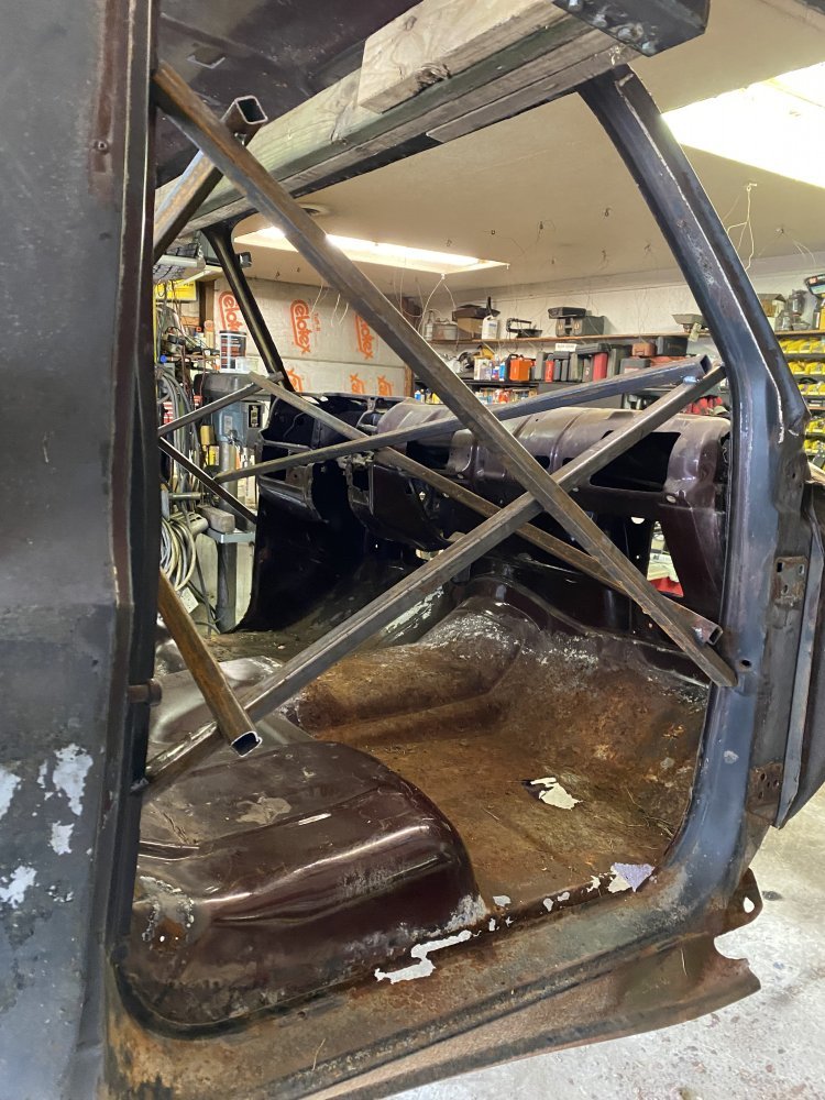

Started working on rust repair today. I started out by bracing the cab with some 14 gauge 1” square tubing. Maybe overkill, but I know I’ll be cutting a lot of metal out so I want to be sure the cab doesn’t move around too much.

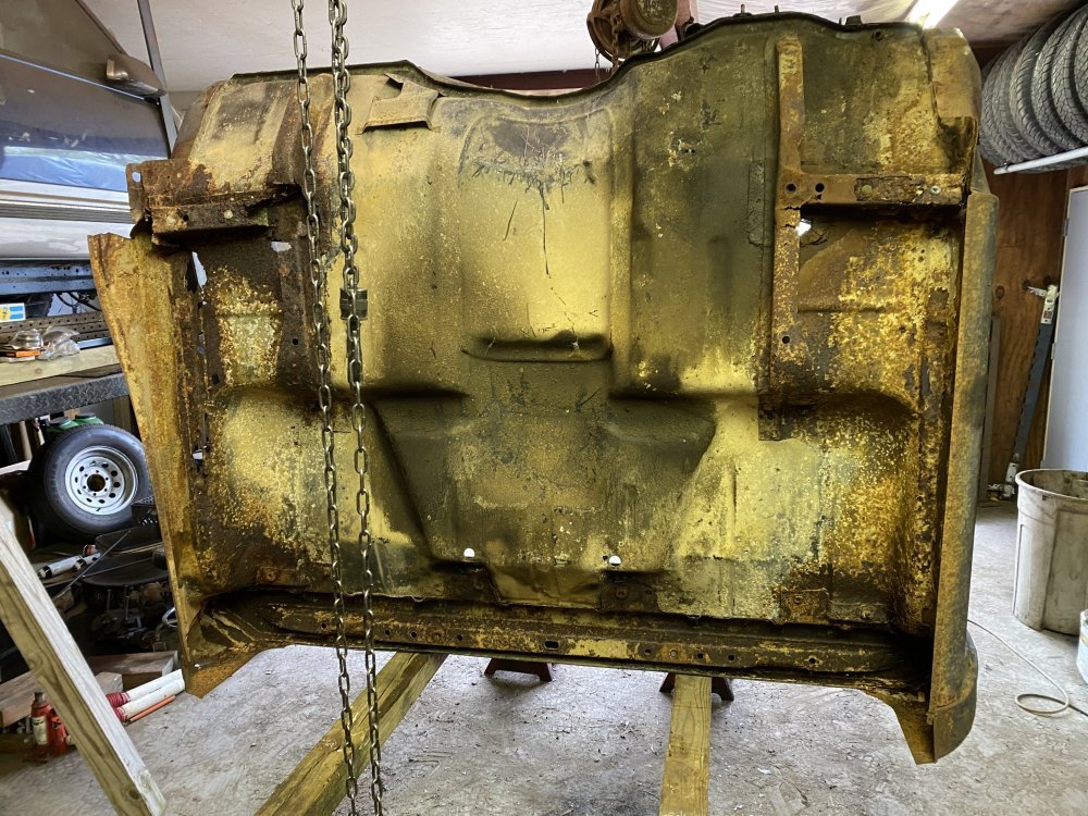

After that I lifted the cab off the chassis and got the chassis rolled outside.

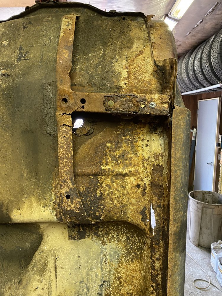

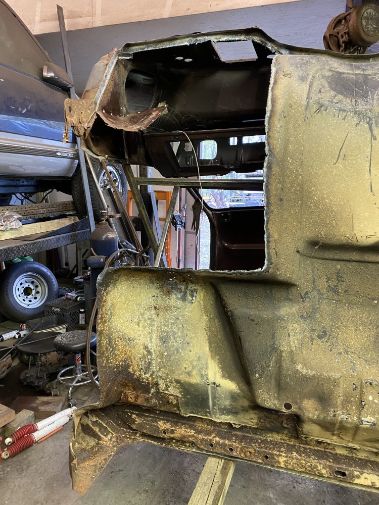

I set the cab down on some 4x4s and then laid it on its back so I could work on the rust repair easier. Lots of rust to fix….

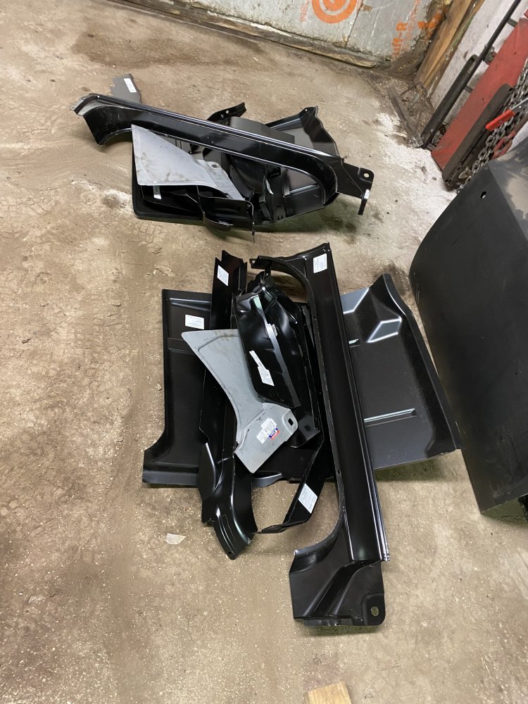

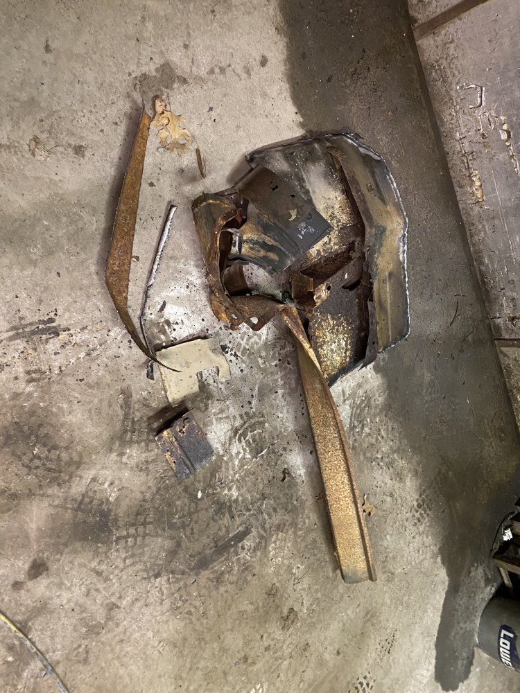

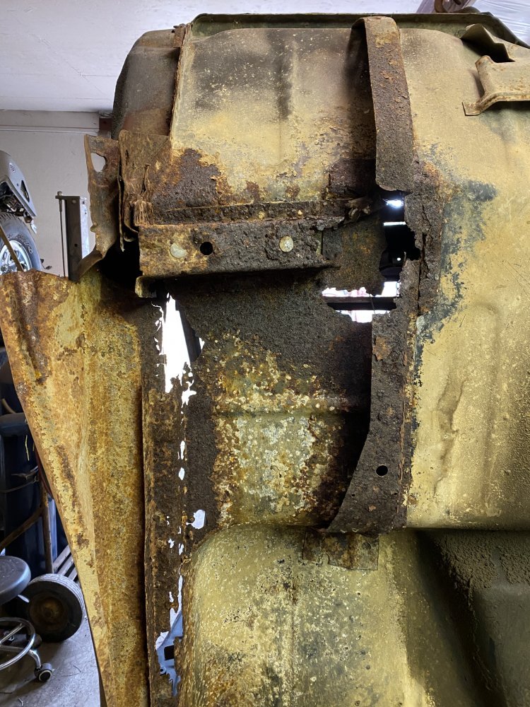

After lots of inspection and comparing to the patch panels I figured out what to start cutting out.

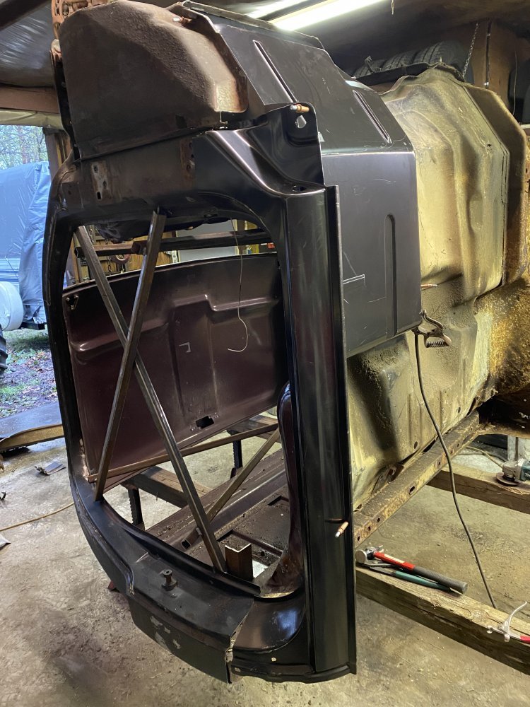

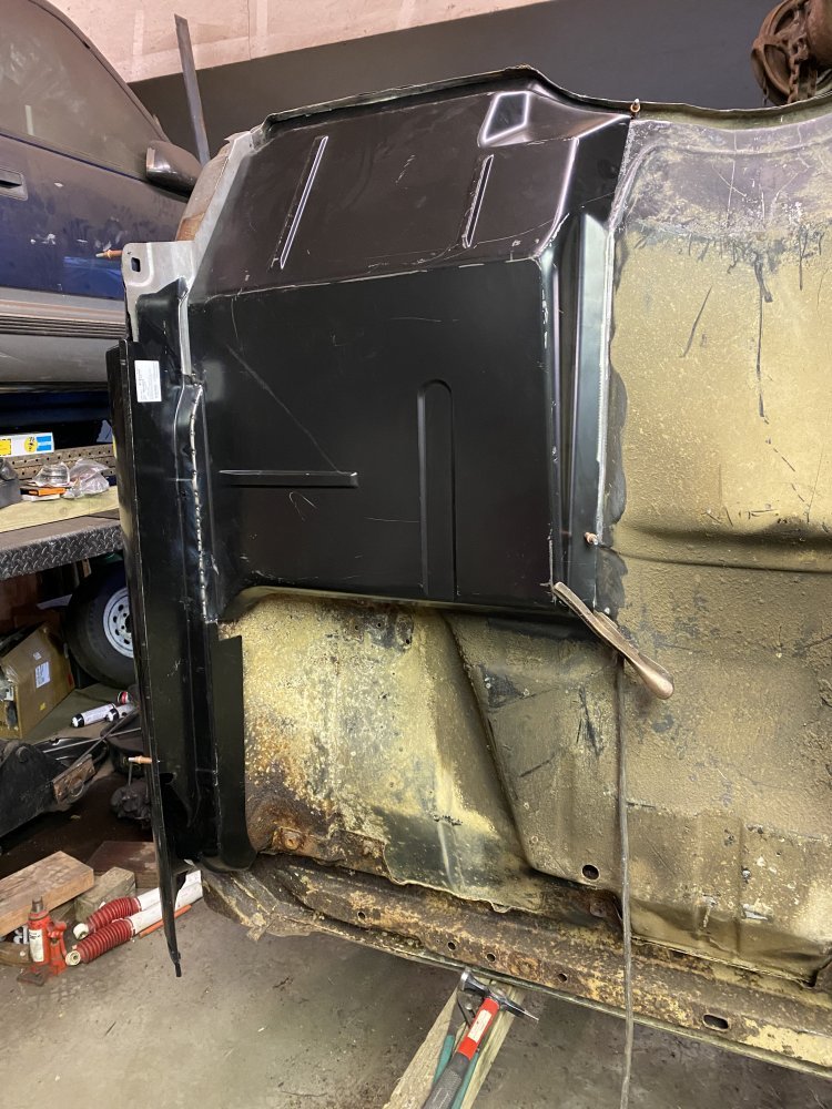

I ended today with some panels roughed into place with some clecos. Still a long way to go, but it’s starting to make sense where the panels are going to go.
Yesterday was a lot of panel installation, measuring, removal, tweaking. Install, measure, remove, tweak. Install, measure, remove, tweak. After many iterations I got to where I was happy with the fit and ready to start permanently installing parts. I decided the floor patch and inner rockers were the ones that made sense to start with. They are about 75% welded in right now.
