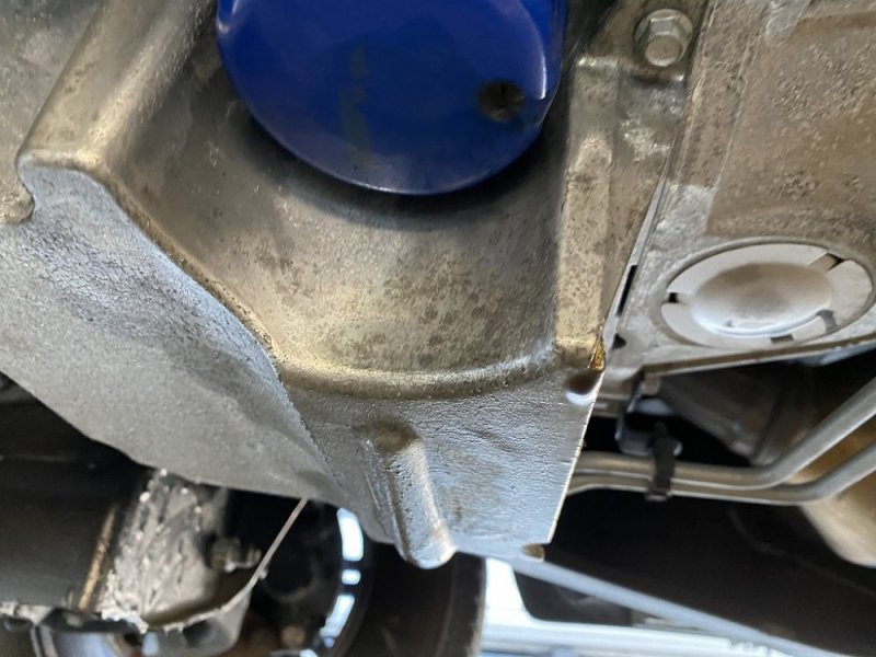

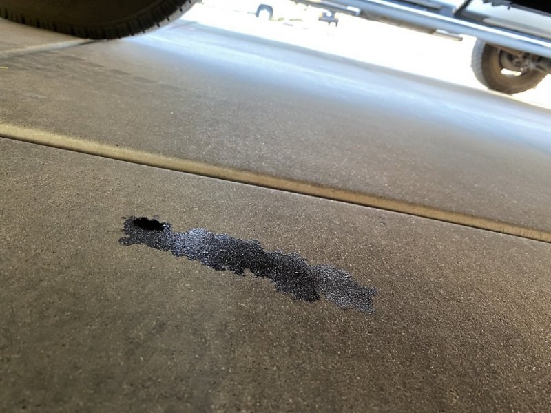

So "Now What?" as I notice oil drips under the parents 2020 GMC Savana with the 6.0L V8 gas engine.

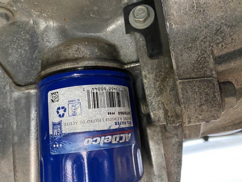

So I tracked it down to the oil filter leaking at it's engine gasket. Less than 1000 miles from the last GM Dealer oil change. (The dealer oil change required an appointment a week out.) Oil filter is loose and the gasket looks squirmy when I attempted to tighten it up. Yes, the dealer could have screwed up the oil change: But Not Likely. (If anything one needs tools to remove a dealer oil change because they don't want this exact loose filter problem costing them an engine. So they are usually way tight.) Guess I need to tell the dealer to use a better Fing oil filter next time while they credit us this one. Note: GM has dropped the "E" off the PF48E ECore garbage now.
An internet search: Filters coming loose appears to have been a problem in the past with the Bean Counter Cheap Garbage ECore oil filters. The AFM engines are noted to clog the filters up now and them. This aerodynamic brick van does not have AFM.
As the dealer is far far away I just replaced the oil filter. It's difficult to do this as the only filter the local parts house had was a Wix. They are out of the ACDelco filters, out of the WixXP, and a scarce supply of diesel engine oil (as in only a couple brands in stock).

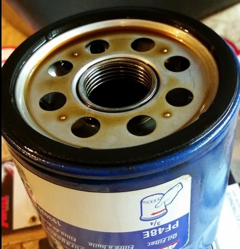

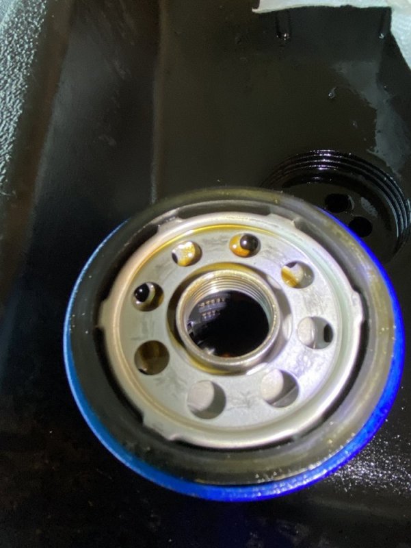

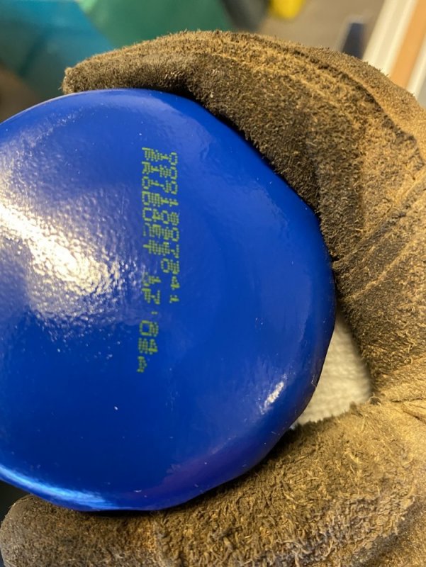

It looks like ACDelco's supplier may have screwed up the top plate.
Some random PF48E below and note the area around the threads has a gap on the top plate on mine but not this one. o_O

I always tighten the LS filter with a strap wrench. They tend to loosen up if you dont.
Rockabillyrat hit it- LS filters come loose if you don’t go that last 1/4 turn. It’s the block not the filter.

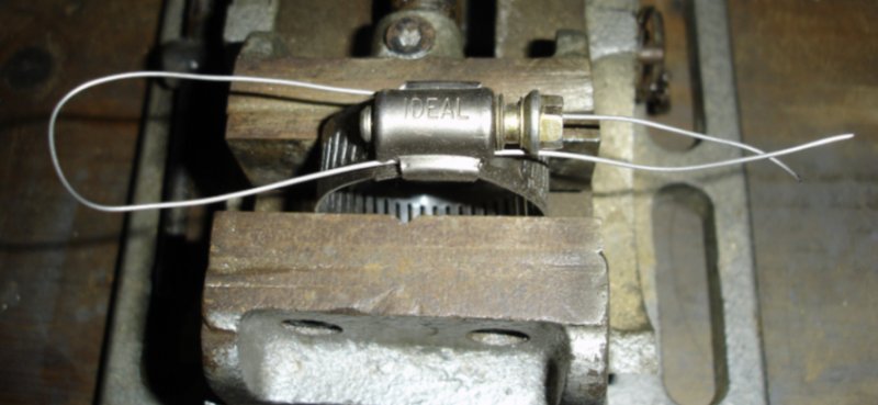

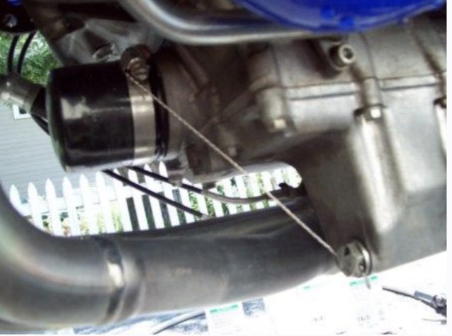

It takes more time and is annoying- but if ya wanna be safe, get a hose clamp to fit the filter and some lockwire. Drill the drain plug and now both are far safer.
Different engine in pic obviously but you get the idea

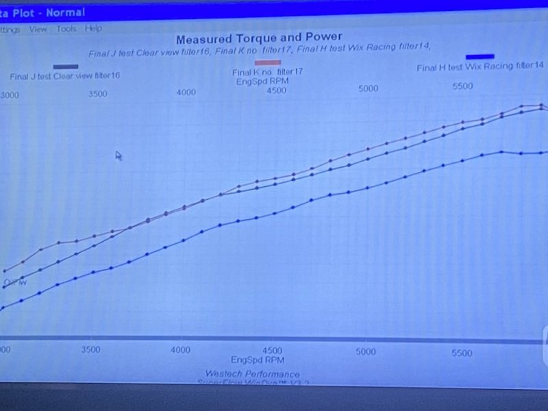

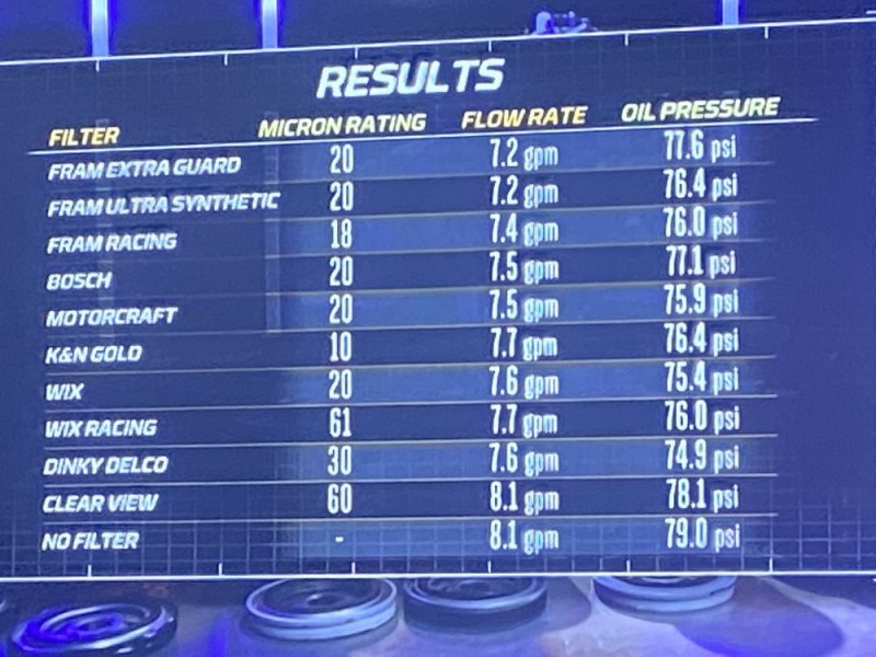

Just finished watching engine masters do a oil filter show. I have it recorded but no clue how to share it. Hopefully someone posts it to YouTube soon. It’s 1/2 hour show- minus commercials would be maybe 20 minutes? But recording on my phone and sending a million text videos could be done if someone knows how to put it all together for sharing.
they did not show failure or do actual filtering tests to verify each company filters to the level they advertise. They did dyno tests and gpm flow and psi tests.
Dyno proved basically no power gains from no filter to the worst.
Flow test showed more volume and pressure advantages from different ones. The full race Clear View screen stand alone unit flow almost same as no filter at all.
Their choice in end was the K&N gold. It flows close to no filter at all and filters the very best at 10 microns.
There is still better options as we all discussed before likenthe bypass filtering through Frantz or if you can bump the incoming pressure to the centrifuge for it to do way better than the Frantz.
a couple pics from the show:
the graph is no filter, race clear view and the wix race filter. Note the micron ratings in the
chart.

Oh yeah- he made a comment I was thinking:
The wix gold and the k&n gold- be funny to find out one is making the other.
they did show internals in the filters and touched on good and bad assembly.
the “dinky delco” is the tiny stock LS oil filter. They didn’t get the bigger delco, they expected the dinky fo not flow good at all- but it kicked butt. The thought is the big delco would obviously flow more.
