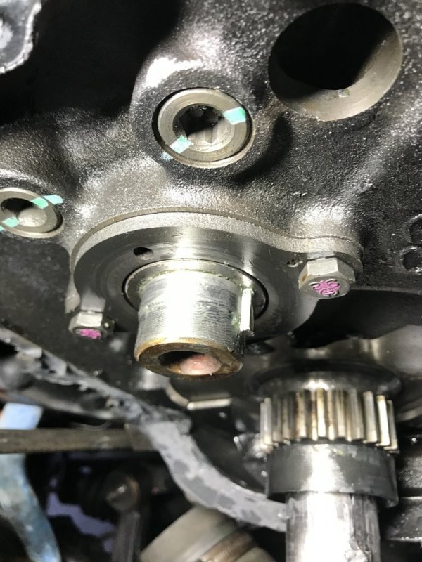

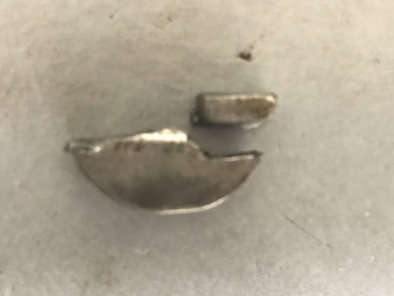

So I figured I'd talk about this, so below are pics of what happened when my 1st Conastoga pump seized at idle, What is the worst that can happen to a 6.5 with one of CDD billet none shear pump shafts at let s say 3000 RPM?

So will it snap the cam, or the crank or strip gears? Of just shear the keyway? Seeing how the keyway doesn't fully engage in the cam gear to IP gear. I guess the only way to no is to do it but I don't think I'm willing to try it.
These pics are with the pump shaft shearing @ idle BTW.
