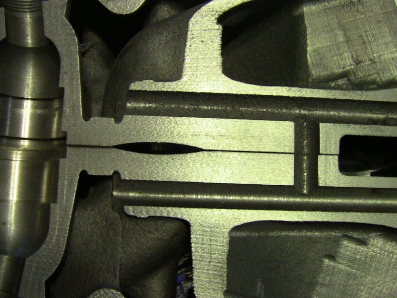

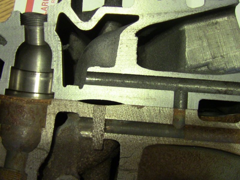

First off, for those that want a for sure answer.... yes, the P400 head is a NEW engineered & molded casting...

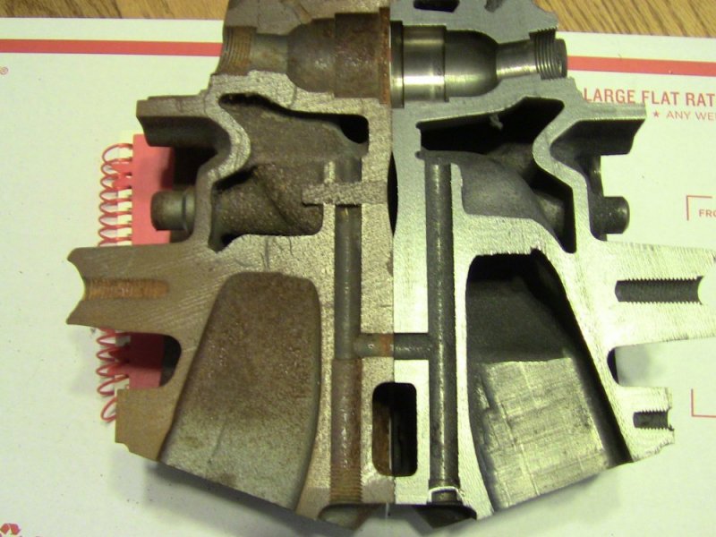

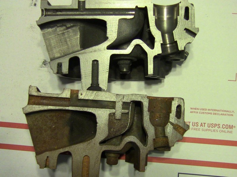

I did cut a P400 head apart just as I did with a couple GM stock heads and as expected they are NOT the same inside, complete different casting molds used, head has been re-engineered on the inside and flaws were removed, new molds made... (very costly)
Lets refresh the differences I have confirmed and made public so far.....
Seats under both valves
Intake valve has thicker head area & under cut for swirl
And now finding....
Has a thicker deck
More metal/improved area under valve seat
Removed mold plug from between both valves
Added coolant flow between valves
The following is just my thoughts and mine only, are these heads worth the cost... not for everyone, but if you want a truly improved 6.x platform, big exhaust valves, etc this would be it... from the long list of things I have found with this motor in pieces tells me they/someone attempted to do it as right as could be done and keep the outside of the motor near the same, this info on the heads is only a few things I'm showing right now, their are more..
Can ya spot all the differences, as close to the same cut on each head, new vs GM
