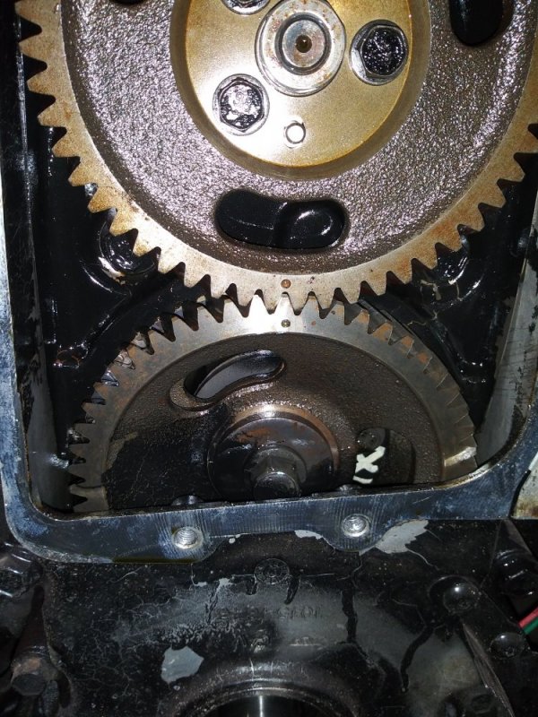

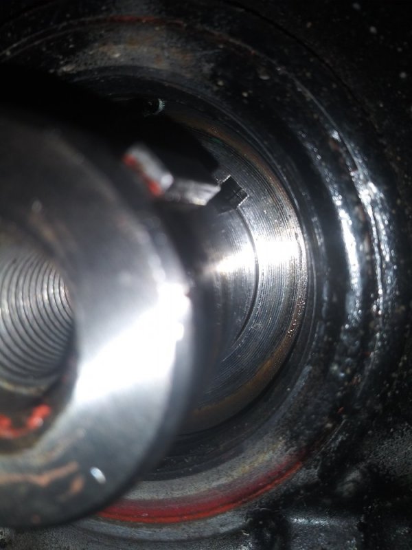

Here these are dot to dot and the balancer is on 0 tdc so i dont think she jumped timing there is a keyway in the crank sprocket and i have absolutely no play what so ever no matter how slow i turn the crank everything moves at once 20200314_202843.jpg

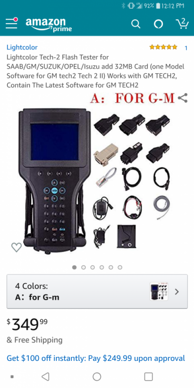

Im replacing my crank sensor again under warranty it ohms at 008 new time keeper set since i was already in there and new injection pump under warranty. Hopefully it will relearn now if not i found a tech 2 if that dont work ill return the scanner amd pull the motor sell and put a supercharged 383 in its place

Absolutely see i rebuilt this truck a year ago with everything being new and upgrades and no problems i ended up getting alot of water few months back so i replaced tank and all lines then boom this ive been told the water and algae could of messed up the ip so im replacing every under warranty new chain and another new crank sensor and hopefully it will relearn i dont get why it wouldn't. My timing was 10.1 on des and act my tdco was -0.44 and a tuned ecm and super 60 turbo hi flow upper etc
