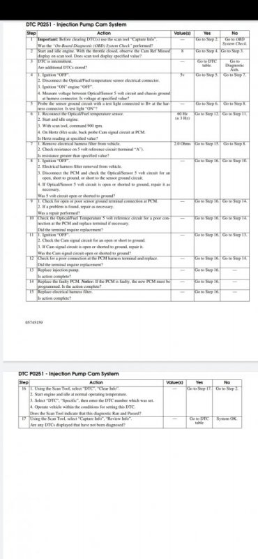

P0251 6.5l please help.
Manual for P0251

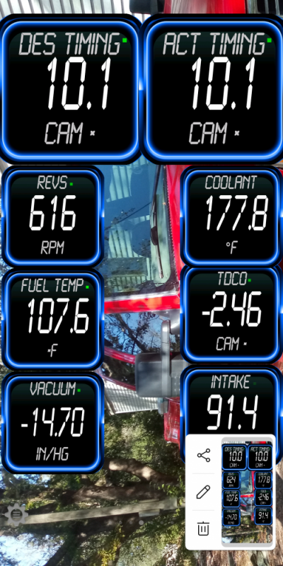

Snap on zeus and matco maximus 2.0 and one on my phone which is where my photos come from i did the koko but i heard its 45 sec pedal down with key on and key off i did 45 sec key on pedal down 30 secs key off and thats how i got my first relearn.
Could a bad ip cause it to not relearn?
PCM will process TDCO relearn once engine temp reaches 170*F with no faults present.
If the truck is running, just drive it around first.
Let the ECM relearn when engine is running.
I have about 8 miles or so on the new injection pump it feels like it did before no rattle dont knock smooth idle smooth doing 65-70 great throttle response every thing is normal minus the hole i got in my radiator i will change the resister with another flight systems
