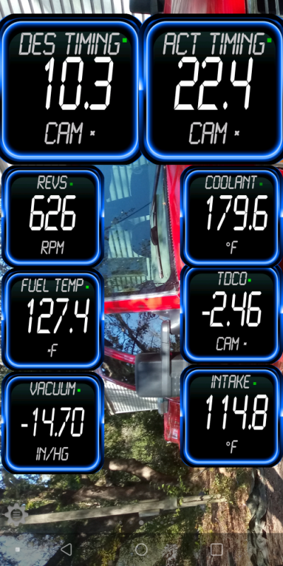

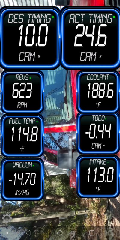

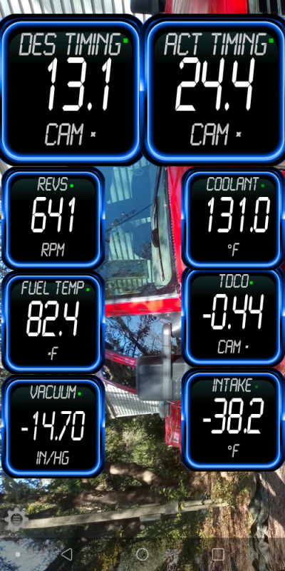

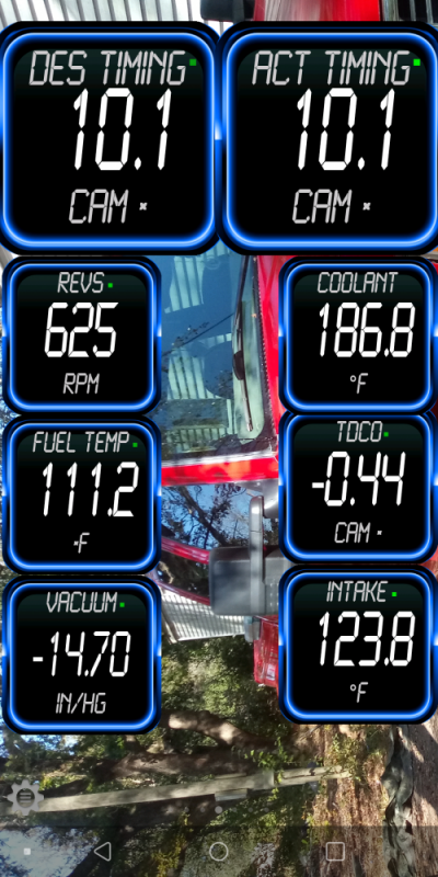

All this time, we thought that the PMD resistor is NOT important.
It looks like, we prooved that bad resistor will cause the timing to be messed up.
