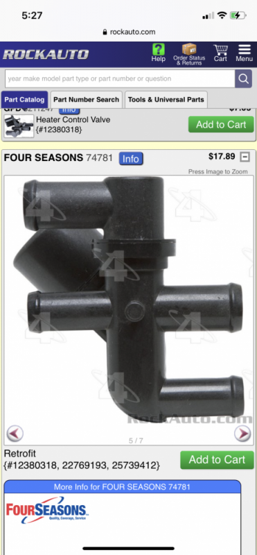

Here is a pic from Rockauto of your proper heater valve. idk which best brand is, I just used this pic to show you.
Notice 4 hoses attach. This is so the coolant never stops flowing. 48F7CD4C-3E2D-4A25-B2C6-8E58797E6188.png

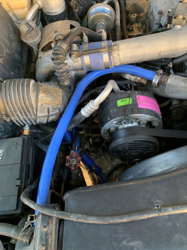

Heater core is now bypassed allowing full flow through the block. I won’t’ need it till maybe December. Who knows we might have another 80 degree Christmas this year lol. Good ole south Texas weather!

I don't think our trucks have that valve. My 94 doesn't my 99 doesn't either even though RA shows one for it. From what I can tell the one that RA shows is vacuum operated. Pretty sure the heater core is hot all the time and a door just bypasses the air around it.
Below 160 is too cool. I am super happy with 180. To me the little mpg gain from being 190 isn’t worth it.
Those type valves with the bypass in it was what I saw most of the time in the fleet. The problem with them is they used to be expensive and would seize up. So a lot of people just swapped them out for the other style used in gasser trucks, plushkw many people changed things trying to deal with overheating.

Yes, the proper valve will bypass the heater core.
Maybe there was a year or two that it didn’t that I am unaware of, but afaik, all of them always had the bypass control valve.
I believe this was a 1/2 ton gas rig thing. None of my 1995, 1993s, 1992, 6.5's ever had that valve. The 1995 350 Gas Yukon did though.

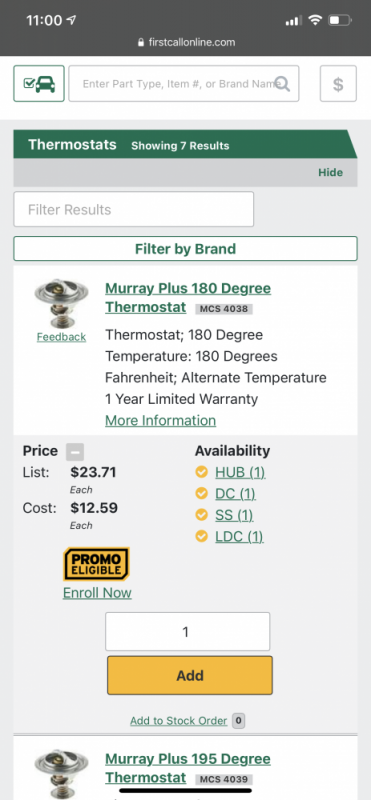

Ok guys I found an 180 degree t-stat at O’Reilly’s. Brand is Murray. I know there a lot of talk about sticking to GM Delco. Would this be something to trust? I can actually get this one in before our trip
