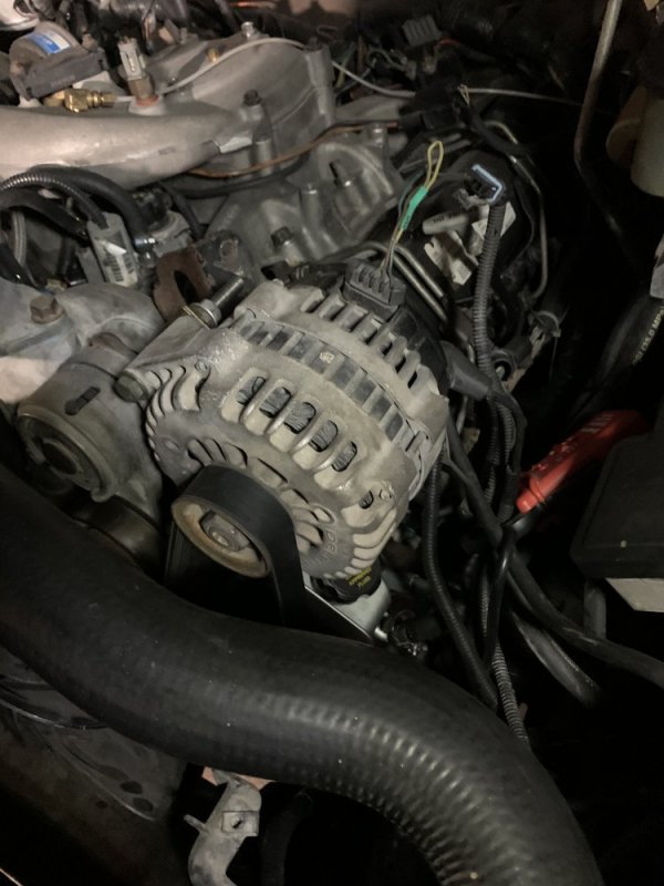

Got the ad244 alternator installed no fabrication really needed except for the top bracket I just happened to have a short piece of flat steel in the garage that already has two holes in it about the same distance as the original bracket. Jut had to enlarge the holes. Temporarily wired in the two wires for the side plug cranked up and tested. I didn’t run it long enough to heat everything up but just running under full load with everything on max the alternator was pushing out 60 amps at 14.3 volts at idle. I’ll heat it up good tomorrow and see how well it does.

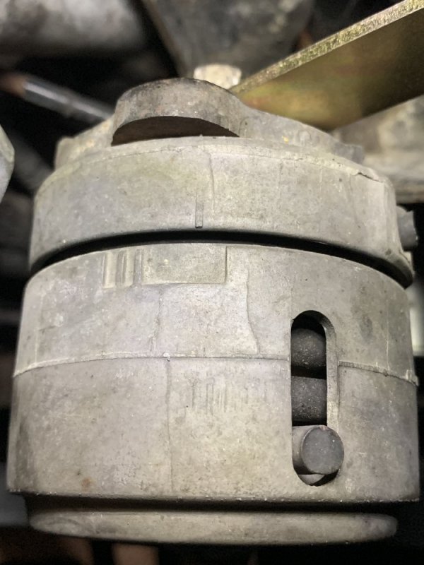

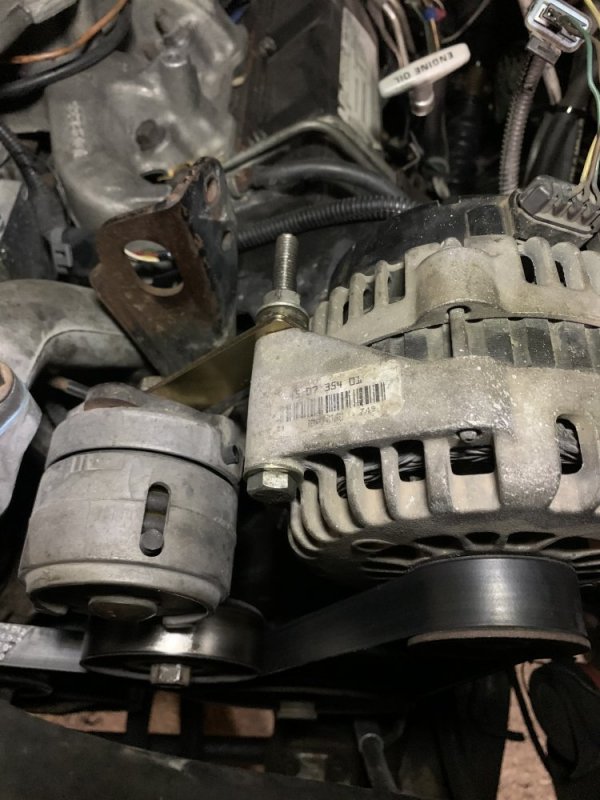

I do have a question about my tensioner though. I noticed before I pulled the belt off. The marks were getting close to the max range. When mounting the bigger alternator I knew the pulley was a slight bit further out so I didn’t swap in the diesel pulley for the test. After mounting it and installing the belt the tensioner was a lot further away from the max so I thought good. After starting it up and al. The tensioner went back close to where it was before I changed the alternator! The belt is only a few months old. I took a couple of photos. Is the belt being pulled too tight? I still want to go back and swap in the larger diesel pulley but that’s gonna make it pull even tighter if this is the case!

Do you have a rear support bracket on the alternator? The case will snap in half if you don't from Diesel vibration.
I still have the rear bracket from the old alternator there but only the bottom bolt lines up. There isn’t a rear mount point on the alternator. I did pry and tug on everything and seemed solid. I was thinking the same thing. Maybe I can bolt something to the upper bolt since it has plenty of thread to use and to the intake somewhere

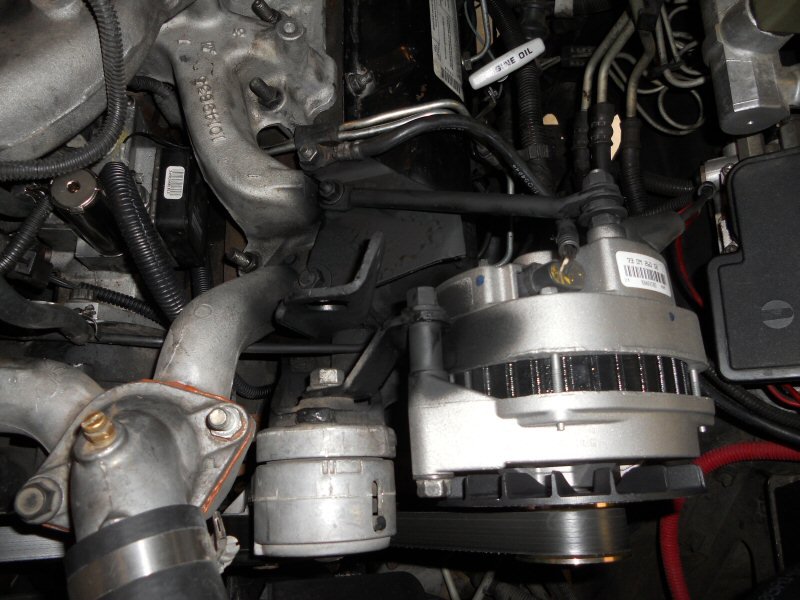

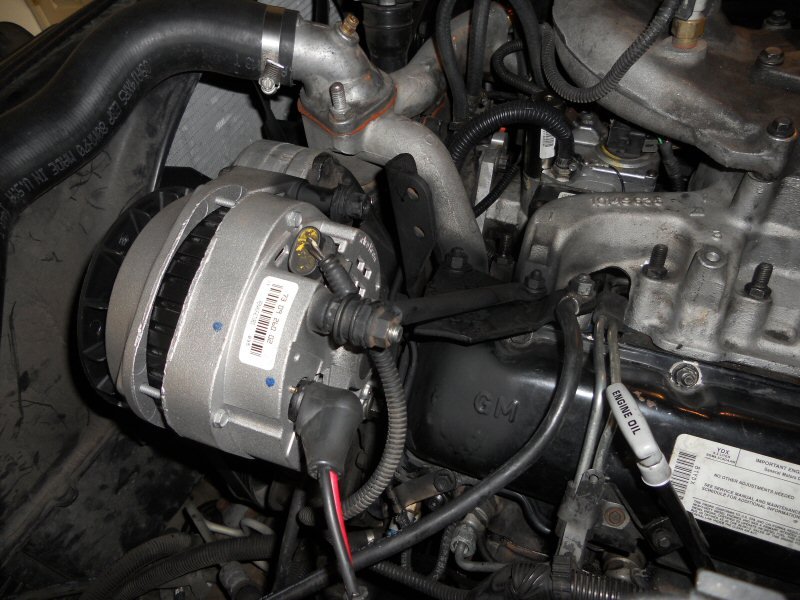

My 1995 with a CS 144. Note the rear bracket required to prevent the case from snapping in half. My 1993's rear bar went to the intake stud without the sawed-off OEM bracket.
