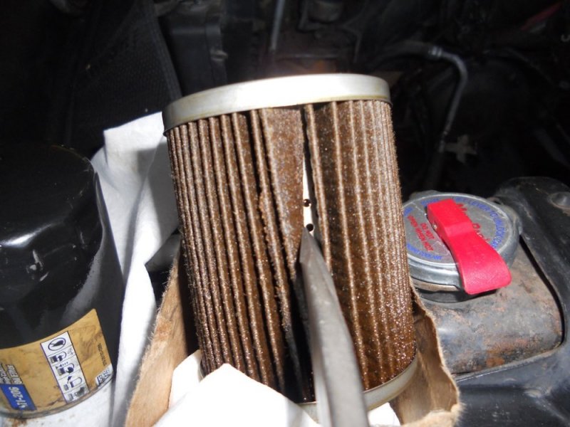

The Wix XP filters have a wire backed media and appear to be about the most serious oil filter you can get. Wix has a checkered history with Cummins engines and don't touch their "make U walk" Duramax plastic body fuel filter. Regardless I run Wix XP filters and get them cheap from @RockAutoLLC . The Wix XP's look good cut open at nearly 5000 miles. I am, after all, pushing 5000 miles on an oil change with a turbo 6.2. I expect no less than 5,000 miles from the 3 gal of oil in the Cummins. None of the any s#itty filter that can make a easy 3000 miles here. Sometimes the engine doesn't even make a 3000 mile oil change... regardless oil changes are expensive and should only be done as needed like 1 year or miles when a UOA says it's needed. Sometimes that is 2500 miles with the 6.5TD. The Owner's manual isn't kidding: 2500 miles!
The next "buy you an engine from a filter failure" company to avoid is anything made by "The Fram Group" like their Orange Can of Death and lesser known Mobil 1 filters they now make. Yep The Fram Group would like to pretend to make a filter worthy of $10.00 and a Mobil 1 name. @Will L. "A Wadded up T Shirt would do better."
Moral of the story "Who owns, makes, and warranties the filter is more important than anything else." Also cut open your used filter and see if it was doing it's job.

Manufacturers change every so often so I think its a good idea to cut open filters at least periodically to check.

Probably a great filter if they actually glued the pleats together!
Your engine and YOUR hassle to deal with the asshats at The FRAM Group and their 3rd party FUBAR claim company if one of their air/oil/fuel filters fails and takes out the engine/injection system. Took this fellow several months to get them to pay for his 6.7 Cummins failure caused by a OCOD Fram filter coming apart. The Fram Group reps didn't want to give me the time of day when I reported my synthetic Mobil1 filter defect to them a label they now half-ass manufacture.
