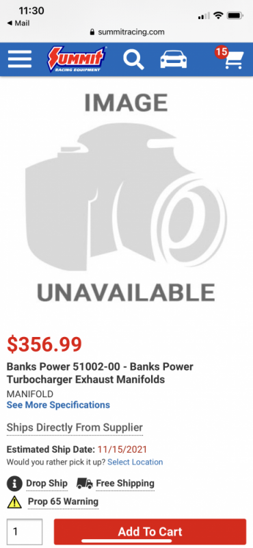

Link to summit, in the manifold description, says unavailable. 😩

Yep I called Banks directly with the part number and ordered direct from them. Something of a panic buy as they were discontinuing the whole sidewinder kit this spring, and I didn't know if just the manifold itself would be available anymore. Everything is being discontinued in the times of Covid it seems

I think so, although at the time it was maybe a little cheaper $351 rings a bell for some reason. I also may have called Summit and they told me the part was discontinued, which was an error on their part as they didn't know the difference between a part and a kit. I'd imagine the price would be the same if coming directly from the supplier.

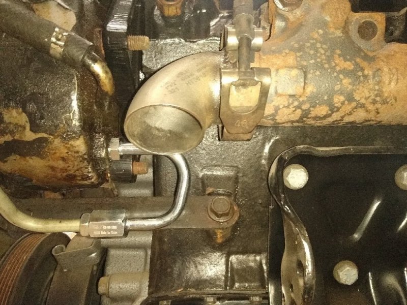

From what I can see the 6.2 kit still used the factory passenger side manifold, which exhausts/ points towards the rear of the engine, and runs new piping that winds from the rear under & across the engine and back to the new manifold part #51002-00. Kit was around 3k which to me was ridiculously priced.
The better setup, in my opinion, is to do what was shown in this thread, using a manifold from a center-mount setup on the driver's side and making a custom shorter crossover under the front of the engine to the sidewinder manifold. The goal here is to reduce the length of the crossover pipe, which on both factory and sidewinder kit is long compared to the custom front crossover.
I'm hoping to start a new thread on this when I attempt to do it for my truck. Hope to get some community input on ideal pipe size (2.25 vs 2.5) and figure out how folks got around the power steering pump interference also referenced in this thread.
Both examples I've seen so far have required modifications to the cast iron manifold: Original poster here pretty much took the driver side centermount manifold, flipped it forward and cut off the 90* vband flange and re- welded the flange with the correct orientation facing downwards.
On another site I saw folks take the passenger side centermount manifold and cut back the vband flange and weld on a street 90* elbow for enough clearance behind the power steering pump.
I'm hoping to do this without having to cut into and modify the cast iron manifold in any way. Leroy mentions in this thread he used the passenger side manifold and references the power steering interference, but I don't know the details of his setup or workaround. Maybe once I get things on a stand they will appear more clear.
