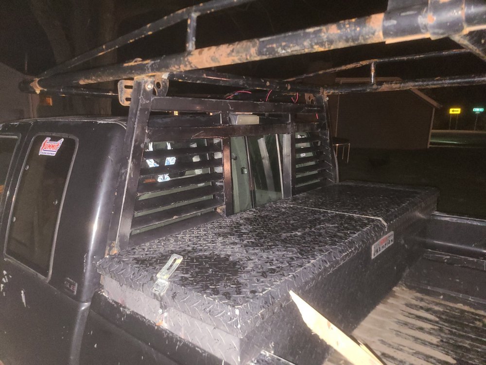

Lol yah I'm definitely keeping it and 93 nothing just a beater I gave more attention to then probably deserved the 93 and the 96 are just a couple gassers that's the headache rack ladder rack and box for the 6.5 I think she gotta be worth more then 3 il post pictures when she done maybe someone can answer my question about the supposed special order truck 2500 leaf spring suspension and gear box but original owner wanted 6 lug hubs and galvanized truck bed? I can say not a spot of rust on whole bed
