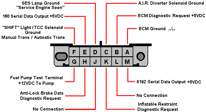

also have you verified that the lift pump is working and pumping fuel? on your year model the LP (lift pump) will not run with the key on. it's controlled by the OPS (oil pressure sensor) mounted on the block. easy way to test is to use pin G on the PCM connector under the dash.
I can't remember if you short it to ground or feed a positive 12v to it, but that will manually turn the lift pump on. @ak diesel driver do you remember on this?
