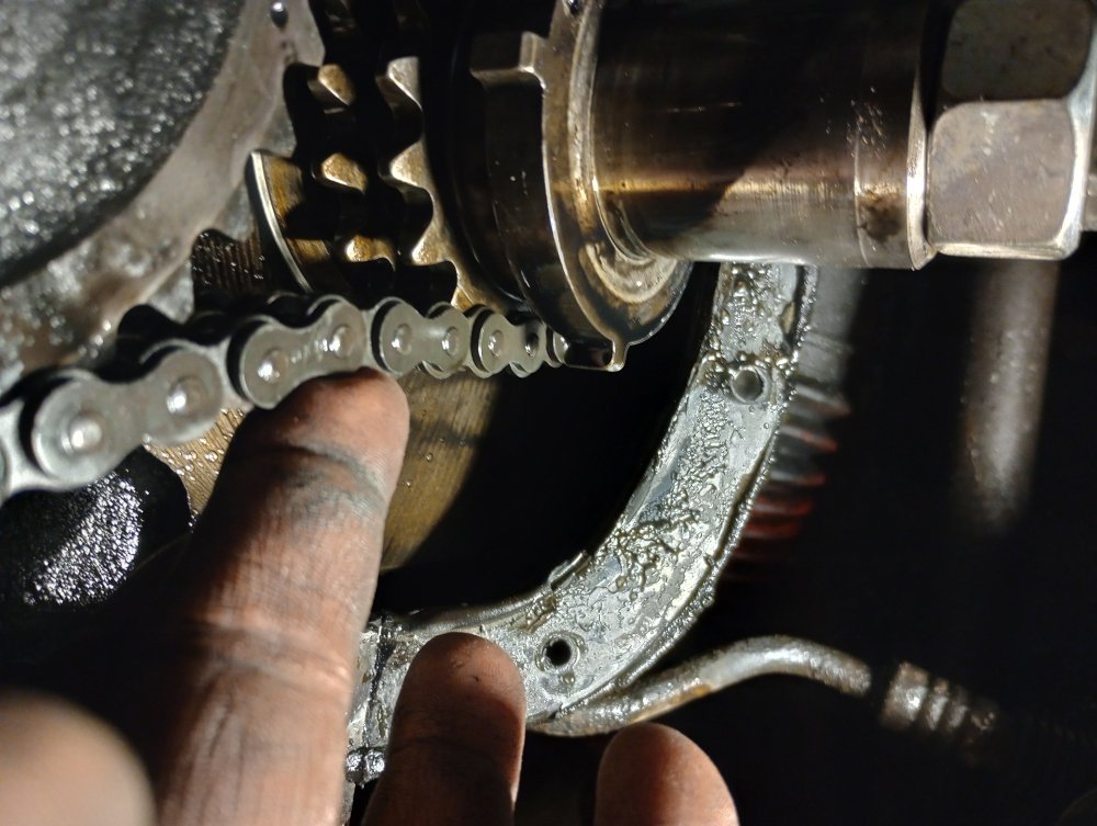

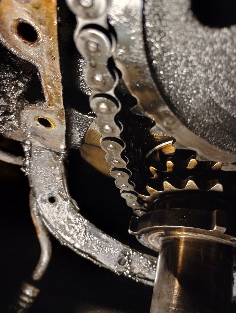

Time for some preventative maintenance. 291k on the clock. Hoping to do gear drive ,I have two , so I thought I may as well put one on this engine. Timing chain doesn't have as much slop as I thought it would for that many miles. Also time for a new water pump as this one seems to be leaking. While I'm in there going to do new rocker buttons. DS valve cover has developed a pretty good leak so need to get in there anyway. Also have new injectors but I'm not sure I'm going to put them in just yet. My pop tester needs some love before I can test them.IMG_20251105_171243397_HDR.jpgIMG_20251105_171253572_HDR.jpg
