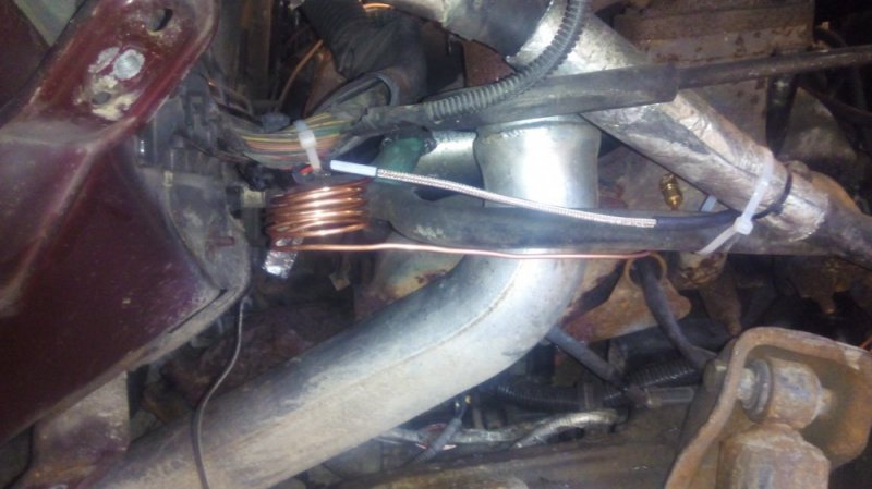

So I got the pyro hooked up and it think the drive pressure done as well. I didn't have an easy way to check for leaks, the brass fittings leave a lil to be desired, about the time i think they might be tight enough they strip. I guess time will tell if I see soot. I put everything else temporarily out of the way so I can drive it tomorrow. I will work on everything else a little at a time. This was kind of a marathon wiring event that alot of it needed to be done all at once. IMG_20160312_143525.jpg
